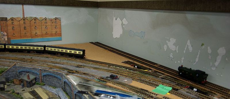

I left you all with this scene of desolation as I started the long awaited storage yard extension
At close of play today: 5 turnouts (#94-#98) are now fully functioning and connecting 3 new sidings to D5 the main Down storage siding :
So far I have added about 11' of storage space - A 5 and 4 carriage siding against the wall and a a second 4 car that curves around at the front, parallel to the main line.
There is now a pause as I await the arrival from Liverpool of two more points. Once they are installed, I hope to contrive one more 4 car siding and three 2/3 car sidings. I had hope to get a second 5 car siding but sadly it didnt work out.
It might might not sound like a great dividend for all this effort but I will be able to add at least two more medium length trains. More importantly it will remove a number of irritating operational log jams.
It has not been a ton of fun. "Close of play" was a somewhat ill-chosen metaphor. During the 15 year development  of Granby I have never found retro fits particularly enjoyable. This has been no exception.

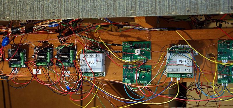

 DCC only requires two wires - so the electrical installation was quite straightforward:
On the right - Feed Back decoder #80 connected to four occupancy detector - to cover the 7 new sidings and a loco spur.
To the left of #66 (an existing Feed Back decoder) are Turnout decoders for #94-#96. These are also from Rails of Sheffield. Made by DCC Concepts they are quite a nifty device - throwing the turnout on command from either the DCC throttle or RR&Co. They switch frog polarity and have connections, which I dont use, for manual switches and LEDs
