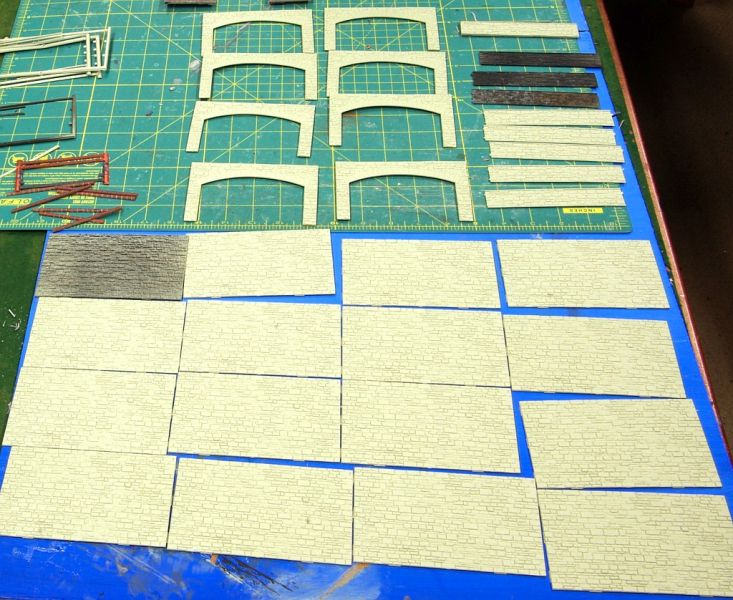

                                   The Last Wall
With the exception of the unfinished Brewery (dont ask) and perhaps a Castle around the pillar, this is the only major construction remaining
54" in length it will form the layout edge from the canal warehouse in the foreground to the green bus above the red throttle
The first section will contain a tunnel mouth for the branch line
I have built plenty of walls on Granby over the  last 14 years. I think the most successful have actually been Scalescene prints  but I dont believe they will work here. So close to the viewer they will  look too flat and have durability problems.
Lots of Wills sheets to paint:
The absolute master at modelling with Wills sheets was undoubtedly the late Alan Downes. Here is an example of his work with Wills Random Stone:
This example is perhaps a bit too "Cotswoldy" for dark satanic Granby but is a superb example of his painting technique.
He claimed to use Wills sheets by the lorry load……check this link if you dont believe me:
https://www.rmweb.co.uk/community/index.php?/topic/70935-anything-you-can-do-i-can-do-better-robinson-and-downes
He developed a very effective weathering technique:
"All the stonework used here was WILLS RANDOM STONE SHEETS (SMP  200)  where I first brushed them over with COLRON LIGHT OAK WOOD DYE  which  acts both as a primer and the base colour to the plastic sheets.
  Working a sheet at a time, lay it flat then aim a  very light dust coat  of ACRYLIC MATT BLACK up and under the stone  courses but don't over do  it.
  When this has dried, rub talcum powder well into the joints then scrape off the surplus.
  Using the COLRON ENGLISH LIGHT OAK again DAB, NOT  BRUSH, this over the  stonework with a large FLAT modelling brush where  it will soak into the  talcum powder and because the dye is corrosive,  it will adhere the talc  between the courses permanantly.
  However, you can use different shades of wood dye  if you wish but it  MUST be COLRON as this is spirit based and not water  based which will  just run off the plastic. - oh, and the matt black  MUST be acrylic as  the dye will not attack it."
My plan to follow these instructions to the letter fell at the first hurdle. Colron Spirit based dye is unavailable in Canada! Furthermore the few examples of spirit based dye I could find were in unsuitable shades…..too dark
So here after much experimenting is the Dew Compromise (how very Canadian)
At the bottom a virgin sheet.  Next dirty white weathering powder rubbed vigorously into all the mortar courses. Surplus powder removed by a sharp tap with the sheet held vertically
Light dusting of matt black acrylic from rattle can held at an angle to sheet
Here is a close up
Not a patch on Alans but I am not too unhappy as a start point. Once the various sub units are made I will apply some dilute washes.  I may brush highlights to individual stones…..not sure about that right now
So with the trials complete it was time for some mass painting in the garage :
To be continued………..
