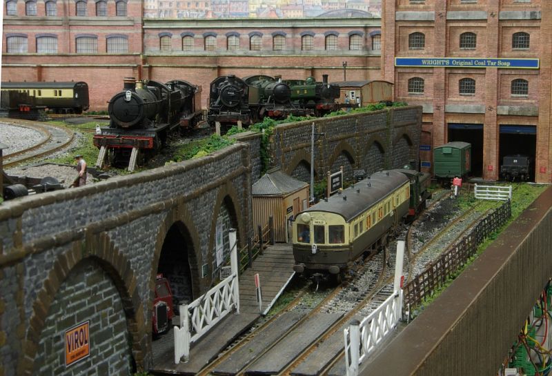

Back to the storage turntable where the sidings are now fully operational.
 To complete the scene the rear wall still needs a low relief warehouse
Veering for a moment off topic. The train the Down line is something of a rarity on Granby…..a short train of Horseboxes on their way to Chester Races.
The next shot shows the Warehouse strip in place and everything weathered. Separately cut ledges and a parapet add a sense of depth even though there is very little room.
Finally with everything finished the Wright's Factory can be put back in position to conceal the light switch
The autotrain can resume its journeys to and from Canal Street Halt:
To finish a couple of shots from the Autotrain looking down at the Canal:

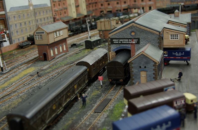

There are more little people to be painted for the hotel frontage along with a scenic retaining wall but the big design challenge is to integrate the warehouse with the platform area at the side and rear of the hotel:
I am afraid the warehouse has been like this for almost a decade. Its amazing what you can get away with- courtesy of the Affinity cropping tool!
But now it is decision time. Somehow I have to close off the rear and incorporate it into the narrow triangular platform area. I have some ideas but need to test them out with mock ups.

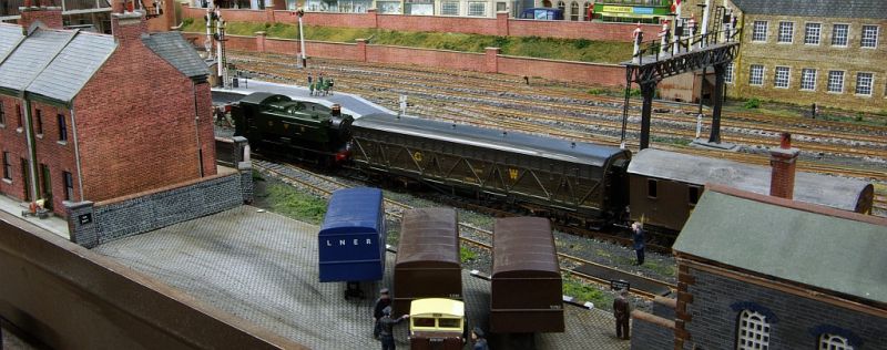

Here is part of a routine I am currently working on:
A Down Parcels train to Birkenhead leaving the Storage Yard
A work stained Hardwick Grange hauling seven assorted XP vans towards Granby Viaduct
The routine calls for two loaded vans to be exchanged with two empties from the King St Parcels Depot at Granby
The vans in the dispatch siding have to be shunted across the main lines prior to the arrival of the Parcels train
The Station Pilot (9407 on loan from Oxley) couples with the Vans
Draws back into Bay 1 and then propels the Vans out of the bay area to the Up Main
There is a slight continuity problem here……the sharp eyed will see that the Siphon G that was drawn into Bay 1 emerged miraculously without corridor connections as a Siphon H with a tail lamp……..I did mention I was testing the routines……..the Siphon G failed being consistently propelled over the throat double slips!
Having cleared the throat points the Pilot reverses and pulls the vans across the Down Main and into Platform 6
Where it will await the arrival of the Parcels Train…………..to be continued  :lol:
