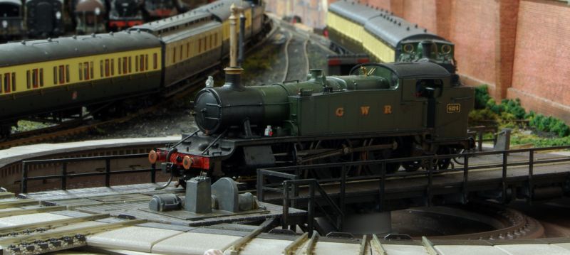

Here is Large Prairie 4124 crawling on to the centre of the bridge

I have to say I envy you that TT, it looks a beauty.

Hi John. Turntable coming along well - the three far tracks are very close together, I bet that was a challenge.There are times when enough is enough and it has to be a replacement. I assume it is all controlled through RR & Co. Haven't made my mind up on mine yet. I envisage RR & Co leaving a train on the approach road to the industrial and steam shed area for manual operation within so a fully RR & Co controlled turntable may be a bit overkill. In terms of temperature we have warnings for up to 46  deg C around here next week, As long as Boris doesn't change the rules again, we are going back to the UK to visit family and friends in September - a bit of rain, cloud and cold never seemed so inviting.

You are right those three tracks are too close. The centre track was a bit of an afterthought so I will have to re-align the right hand track.
Believe me a turntable that is completely controlled by TC is an absolute joy. TC treats the turntable just like a turnout in a route. Imagine a schedule from a running line to the TT entry line, on to the bridge and thence to shed line 2……..the bridge is currently aligned with shed line 5. When you start the schedule the loco will move out of the running line and on to the entry line….. at the same time the bridge will move to align with the entry line…….the loco will stop in the entry line until the bridge is correctly aligned…..the loco then enters and stops in the centre of the bridge…….once the loco has stopped the bridge moves to shed line 2……. depending on the exit orientation that you specified in the schedule block instructions …the bridge will take either the most direct route or turn through 180o + -
…….once the bridge has stopped at shed line 2 the loco leaves the bridge and stops at the designated stop marker on the siding……….all with one button click!
It is difficult to do this with all makes of TT hence my perseverance with Fleischmann.
Your approach of operating with RR&Co up to the entry line and thereafter manually will work but you will have to remember to go into the computor and change the loco orientation each time you turn it. Otherwise when the loco rejoins the TC operation you will have an unexpected result!

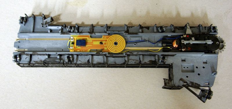

The turntable wasnt that complicated to fit. I actually just had to clip the bridge into the existing well which was already wired up and programmed. Ideally all I needed was a replacement motor unit for the bridge…….the piece at the end
So yes I have a surplus brand new well along with a previously used non working bridge :cry:
