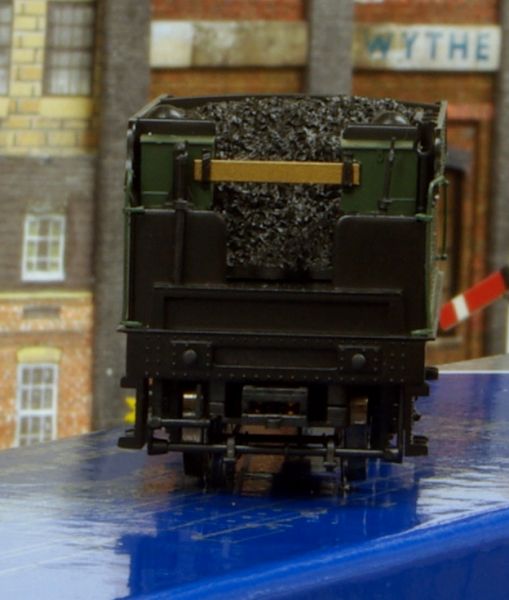

Lot of nice detail on the tender. Dont believe I have seen a retaining board modelled before.
The coal load, which is unusually realistic is easily removeable:
I guess this is the last time you will see the loco looking like this:
There was a reason they were known as Mucky Moguls…….so a Shirt Button livery in 1948 will require a fair amount of weathering plus Crew, Fire Irons, Lamps and Coal…….and I must remember to change the buffer beam numbers!
I worry a little about the motion bracket and the longevity of the tender coupling other than that I am more than content. Bodes well for the Manor and I do hope Dapol will be encouraged to persevere with their Prairie.
