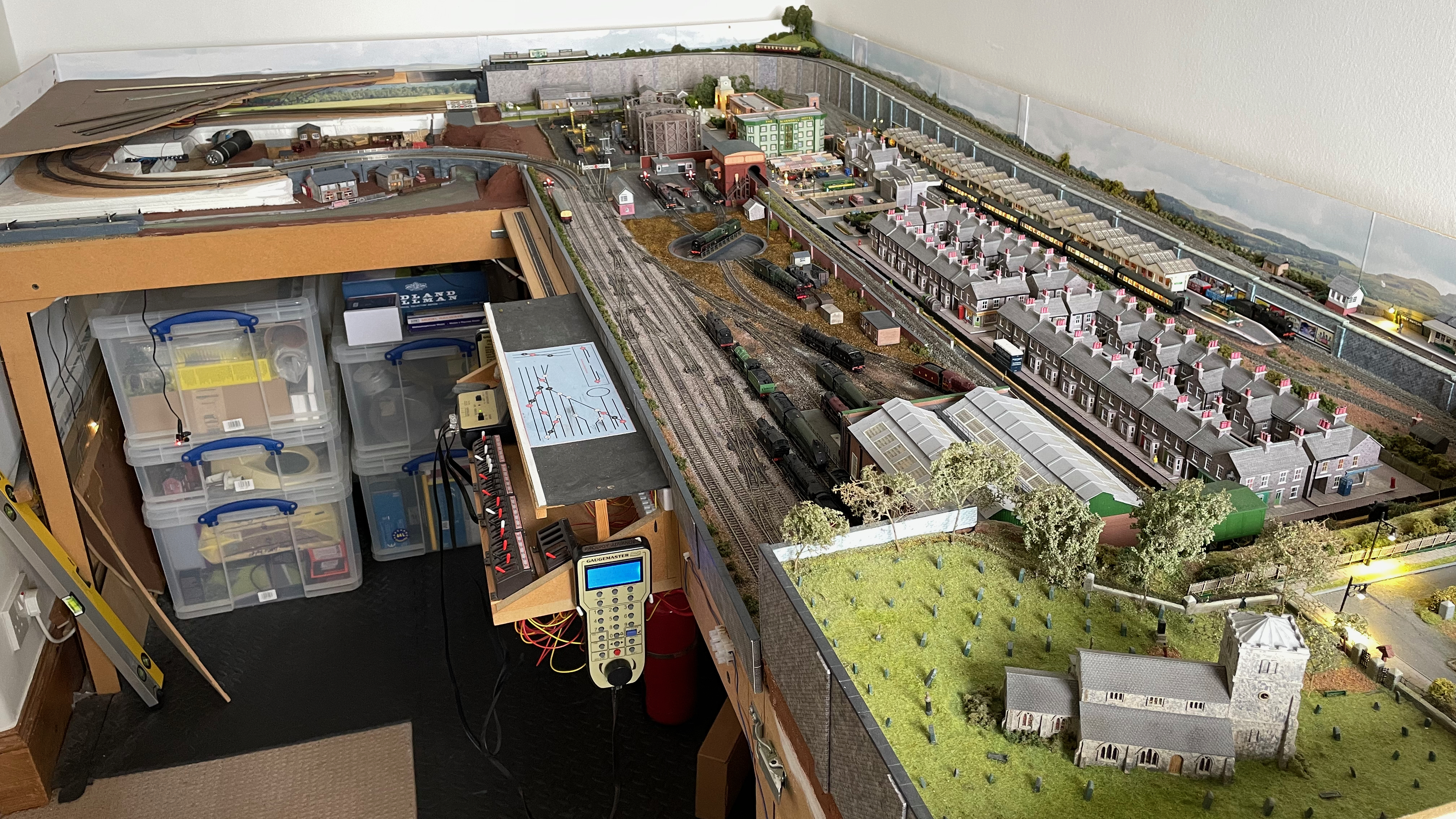

Elvenhome
I am currently working at the far end of the layout on installing a canal and canal basin with a timber yard that will sit below the village of High Elven which is the terminus for the branch line. This is a much revised area of the layout. First the area for High Elven has been cut back. The board for the village covered the whole area where the canal basin now sits. I also finally had to accept the viaduct that had stood there for five years had to be scheduled for demolition. It was early scratch build It served its purpose but it was beginning to show its age and my inexperience as a scratch builder. Although I couldn't have known it at the time, it had also been built with too tight a radius and was also too narrow. As I bought new rolling stock and locomotives, particularly a 9F and a 8F, I was forever having problems with derailing or bridge strikes. I couldn't keep gently moving the track any longer. A new bridge was built which also required a relaying of the whole curve to make all the radii gentler.
As part of the redesign at this the end of the layout I took up the Gas Works that I had installed and raised the level of the base board up to that of the surrounding area. The Gas Works was reinstalled but this time, with more experience and confidence, I think have been able to do a much better job of it, including have it connected to the railway. I have also been able to match, as much as you can in an N scale model the key elements of a town gas works (what I don't now now abut the process of making town gas simply isn't worth knowing). Putting the Gas Works in allowed me to put pavements and street lights in, including some working traffic lights to control a blind bend.
Settling on the arrangements for the bottom end of the layout also allowed me to complete the depot. In my last post I was in the process of building the Engine Shed for the depot. That is now complete and in its place including its lighting
I also, as a consequence of the width of the 9f and 8F again, had to replace the island platform of Weathertop station. I had already installed a Market place outside the station fitted with lights, and with the station platform needing to be replaced, and with more confidence now in fitting lighting on the layout, I fitted lights in the station together with people and other things on the platform.
I am still doucmenting the build on my channel on YouTube and putting up vidoeos roughly every two weeks. I will continue to post updates in this thread.
Finally a picture of the layuot wiht subdued ambient light so you get a sense of the lighting so far installed.
