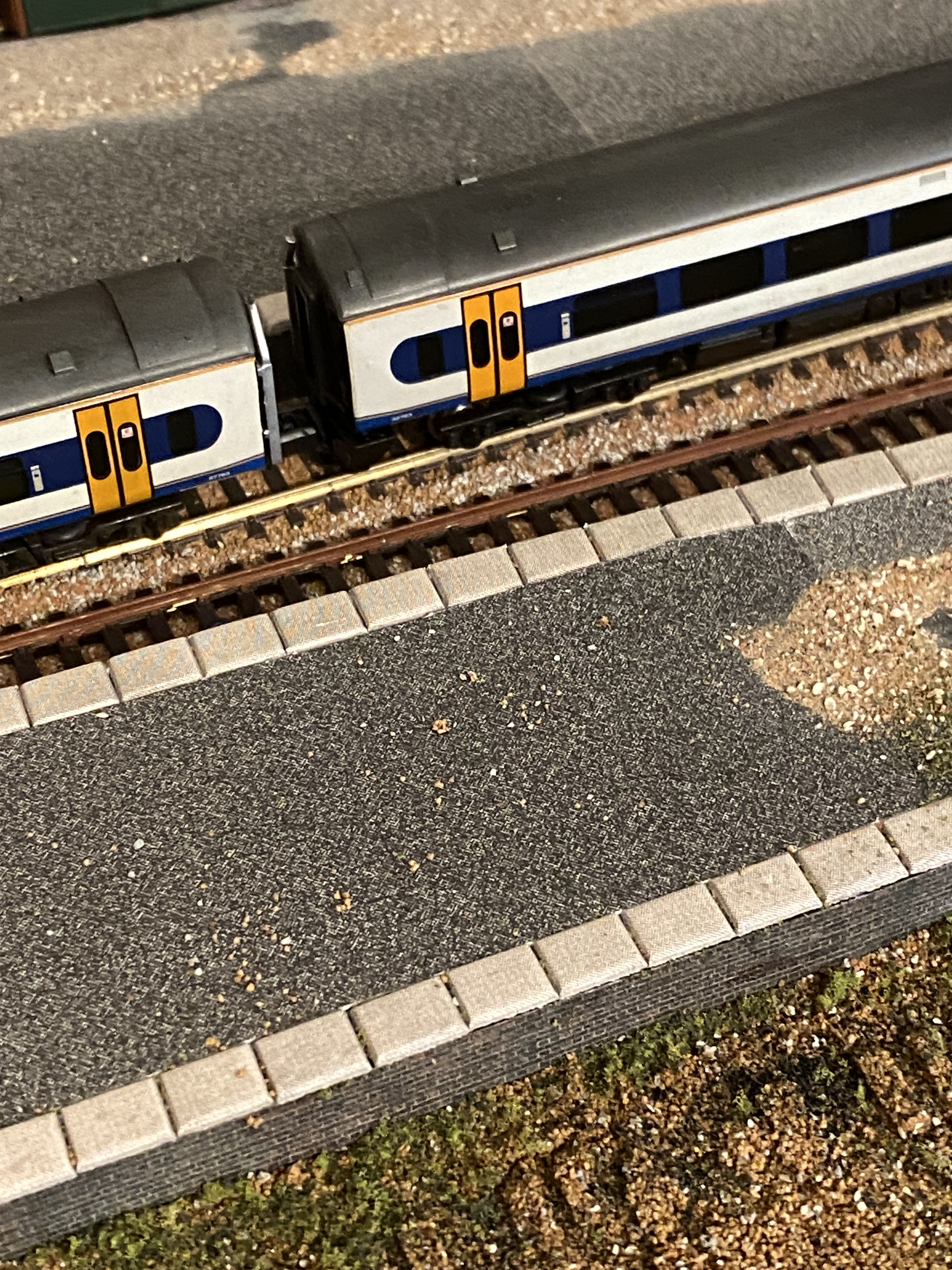

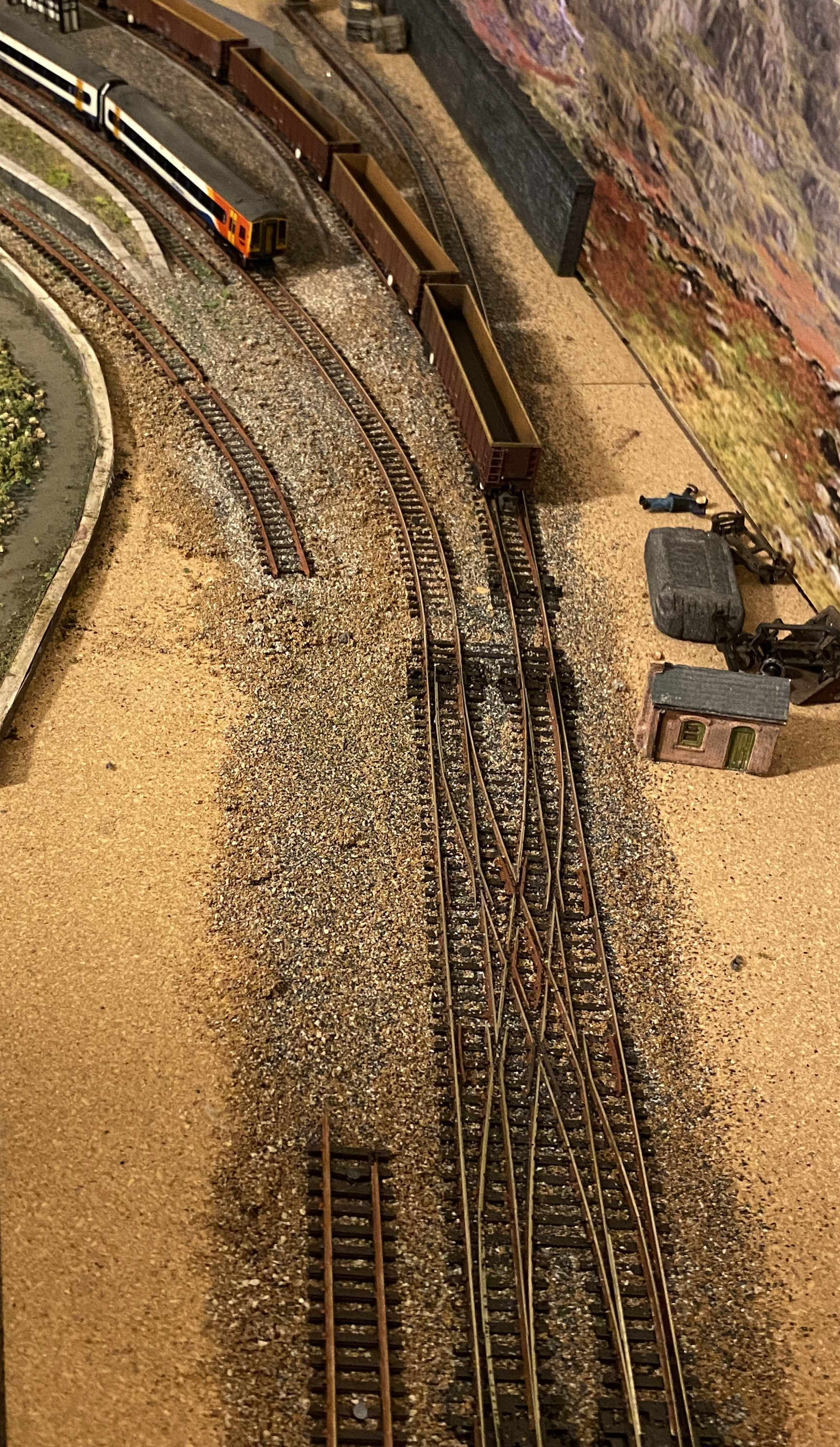

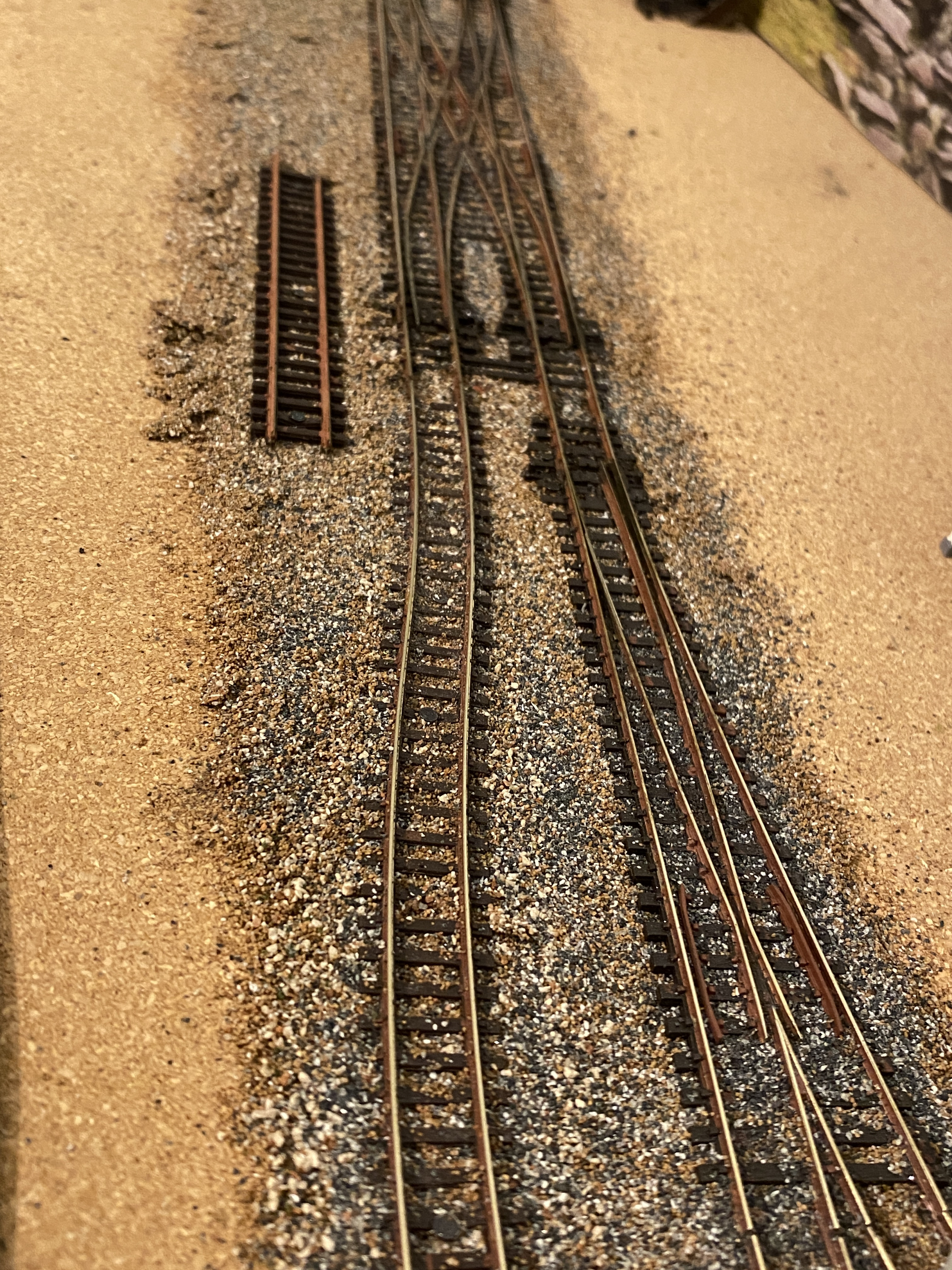

Rail rusting is taking place.
A 000 brush and a mix of Railmatch “Rust” and “BR Bauxite” are the first stage in turning shiny webs into well-weathered ones. Any paint on the rail head is removed with an IPA-soaked cotton-bud.
Also now in place is the redundant track at the disused platform so we can see where rails once were, where they still are but are unused and, with the 158 in the station, the third track is still in use.

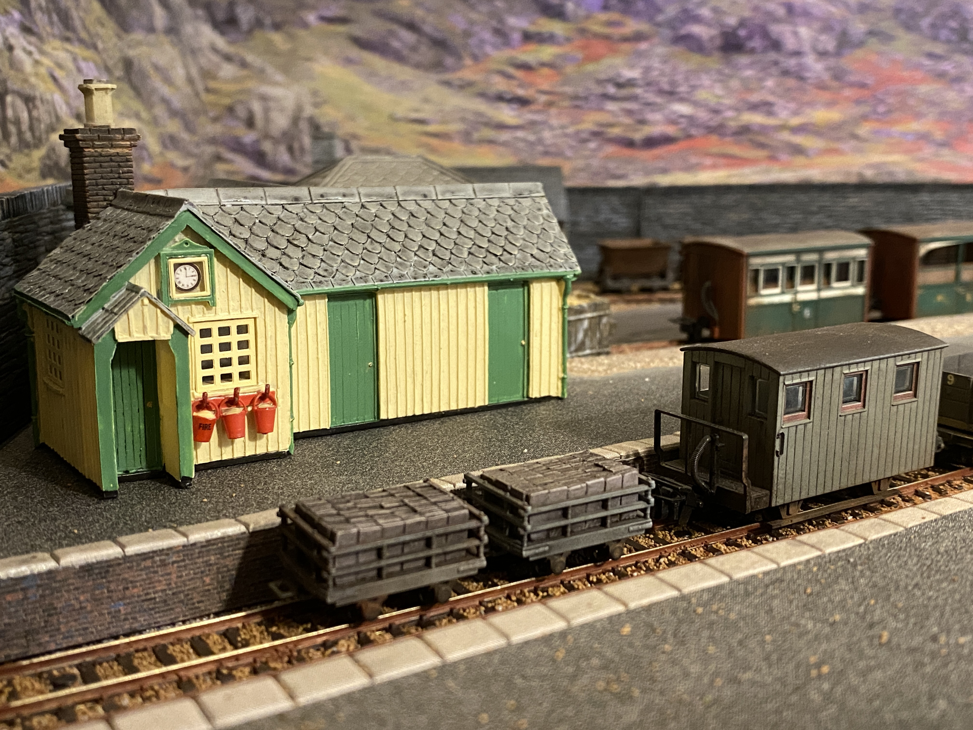

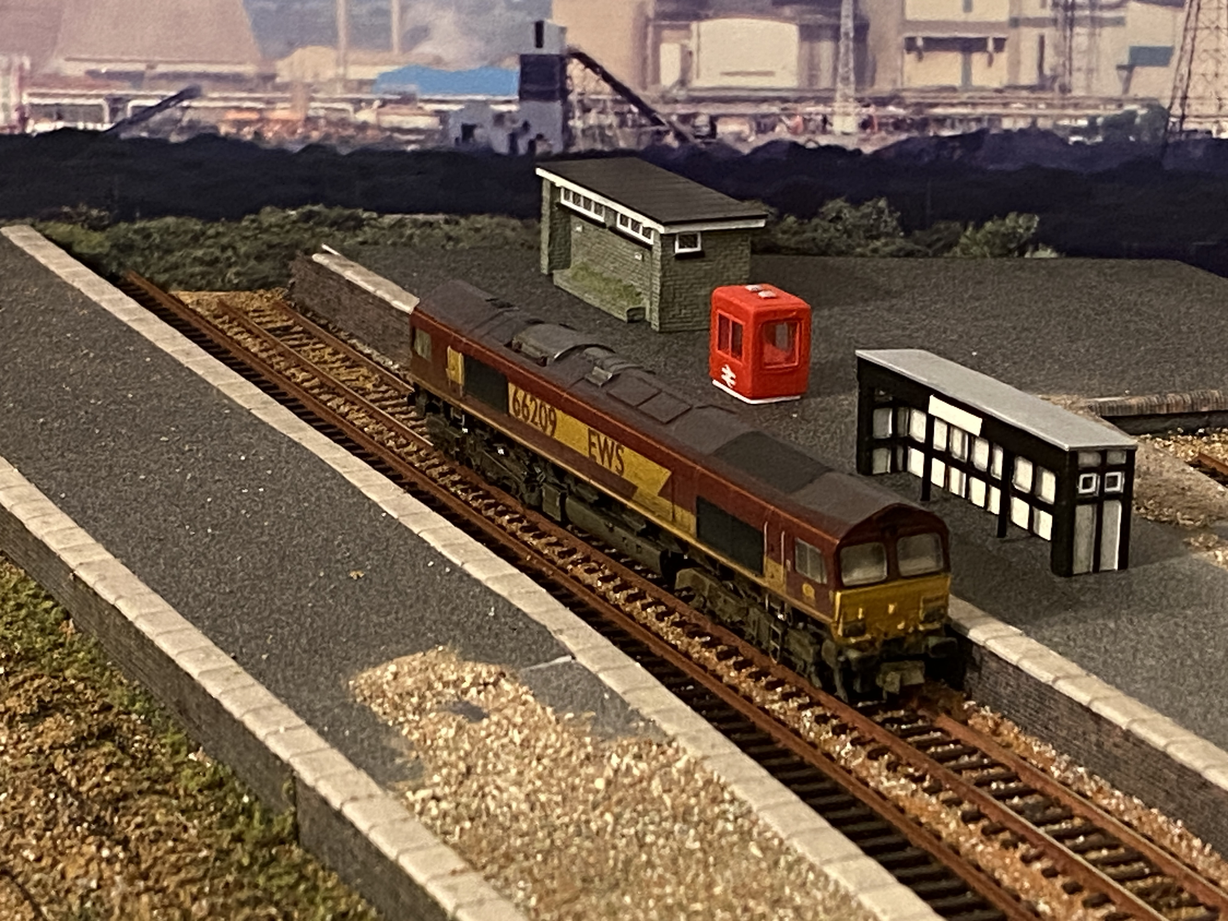

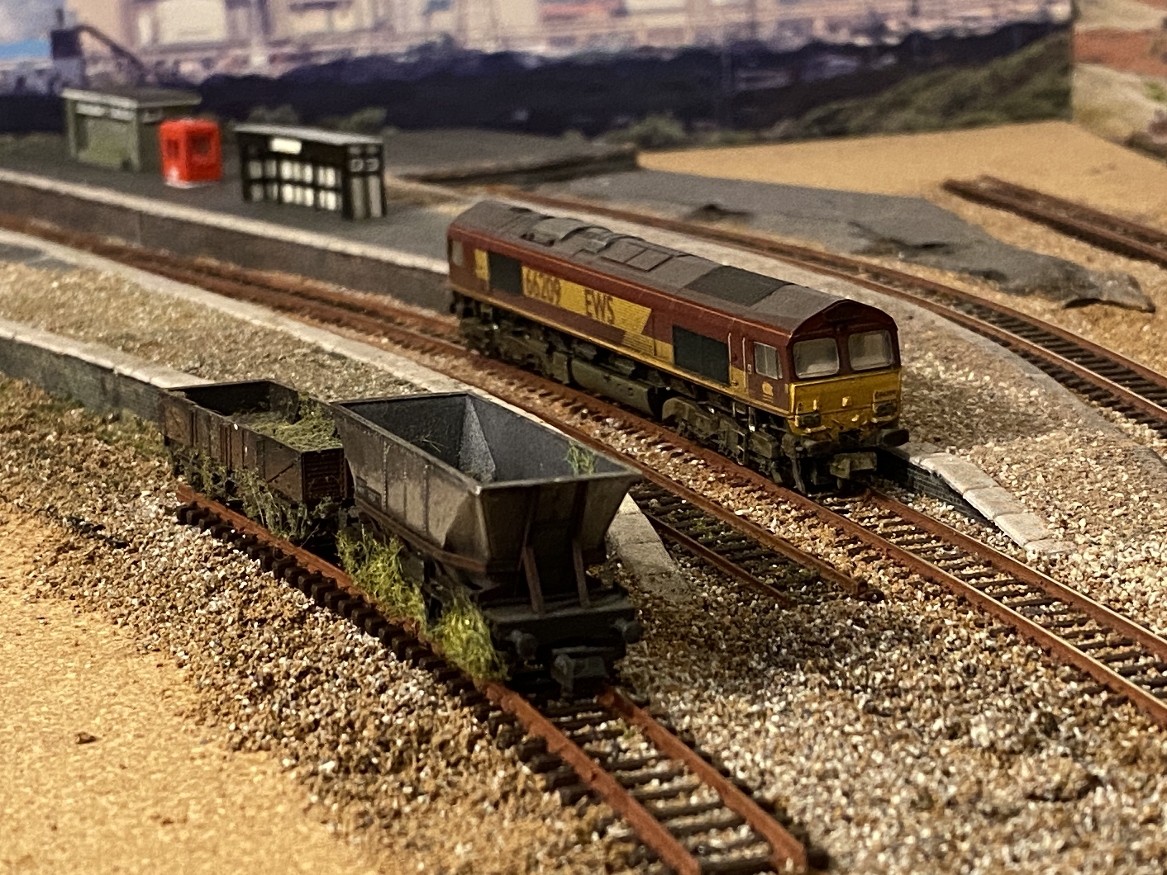

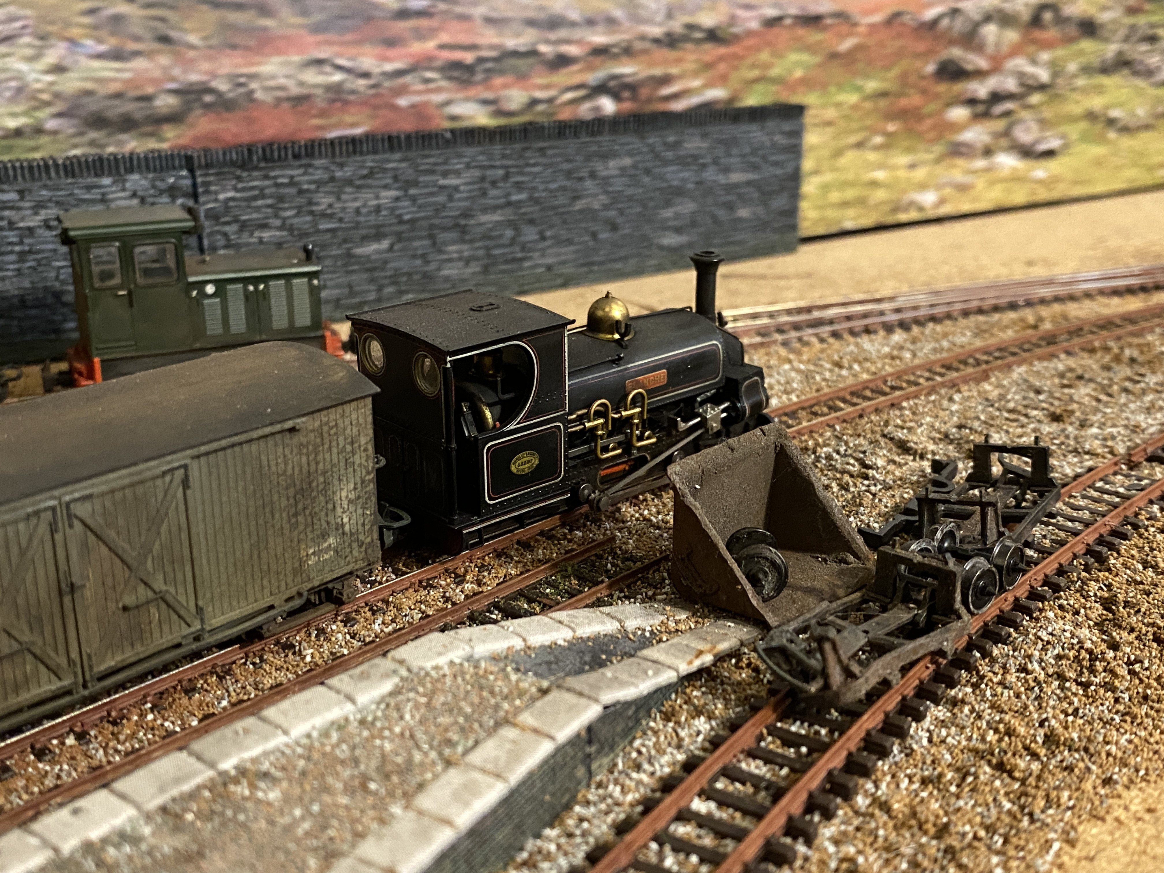

The effect of rusting the rail webs - and the heads for disused lines - is shown here. Track weathering is yet to be applied but the picture is emerging of a run-down line with redundant bits having been torn up.
 Derelict wagons remain on an isolated length of track as the class 66 “yings” to itself in Boghouses station.

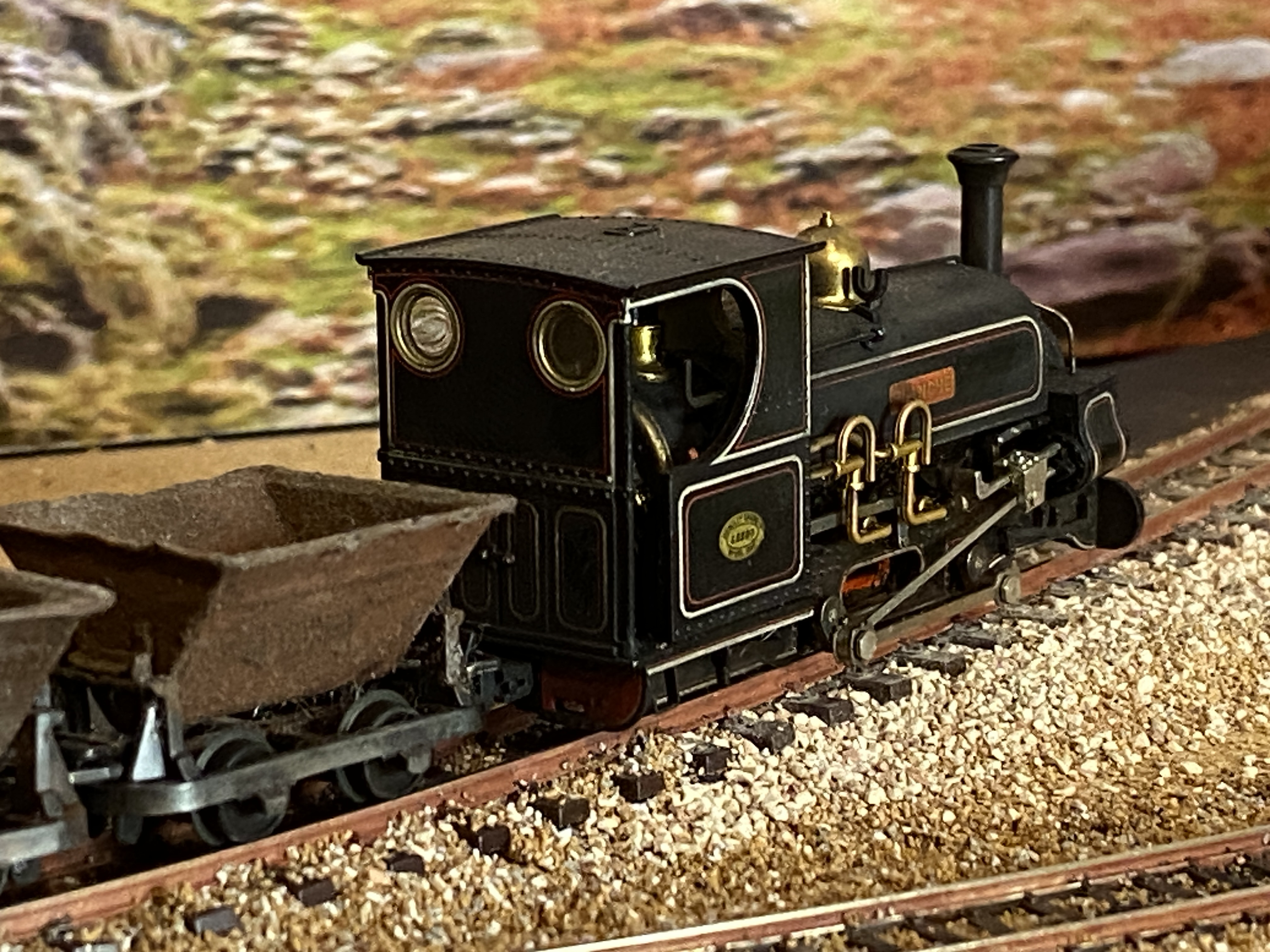

 Meanwhile the Hunslet leads empty skips up the mountain from Tŷ Bach towards Mynydd Meghan.

The layout is to have its first “public” viewing tomorrow. Friends are visiting. Not normally interested in such things as little trains but a special request has been received to “see what it looks like”
The theme will be the 00-9 Tŷ Bach. It’s a bit more substantial than Boghouses for now.
All recently-painted rails have been cleaned. All points have been tested and pass current as they should. All blades close firmly against their stock-rails.
All clutter has been removed from the layout and the desk below is as tidy as it gets.
A couple of staff have appeared as have the scrap skip wagons on the redundant tracks
IMG_8029.jpeg IMG_8031.jpeg IMG_8032.jpeg IMG_8035.jpeg IMG_8034.jpeg IMG_8033.jpeg

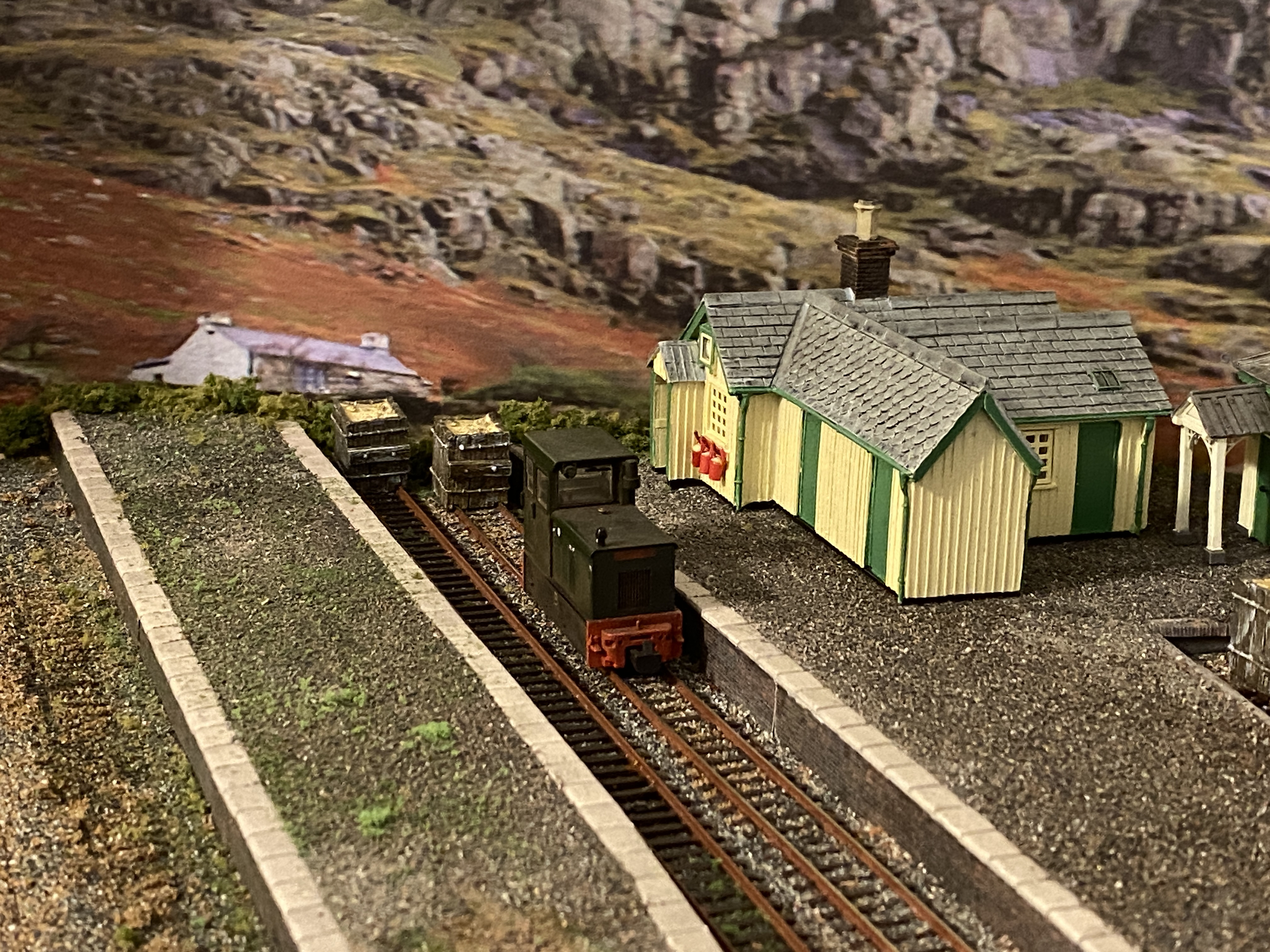

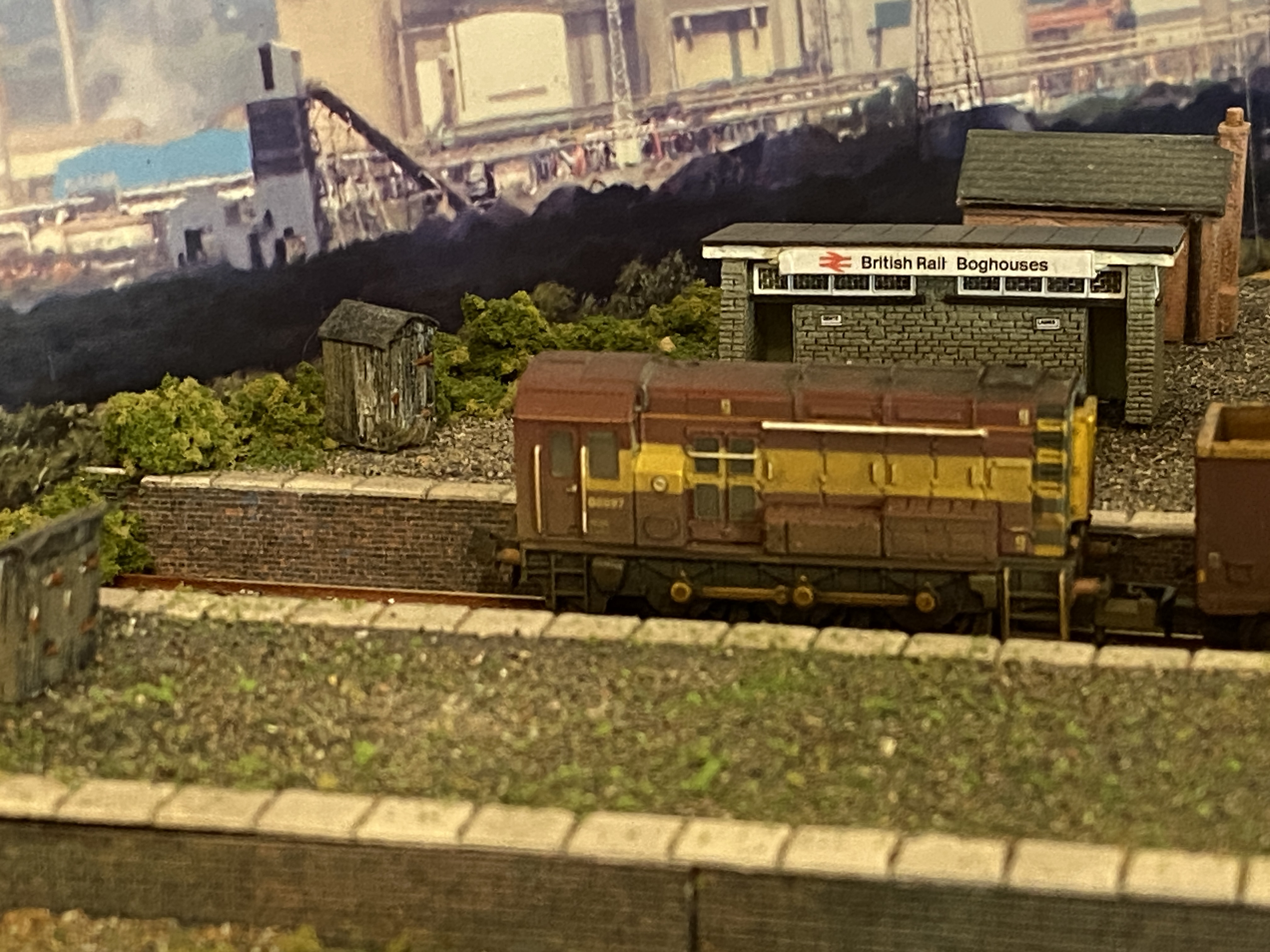

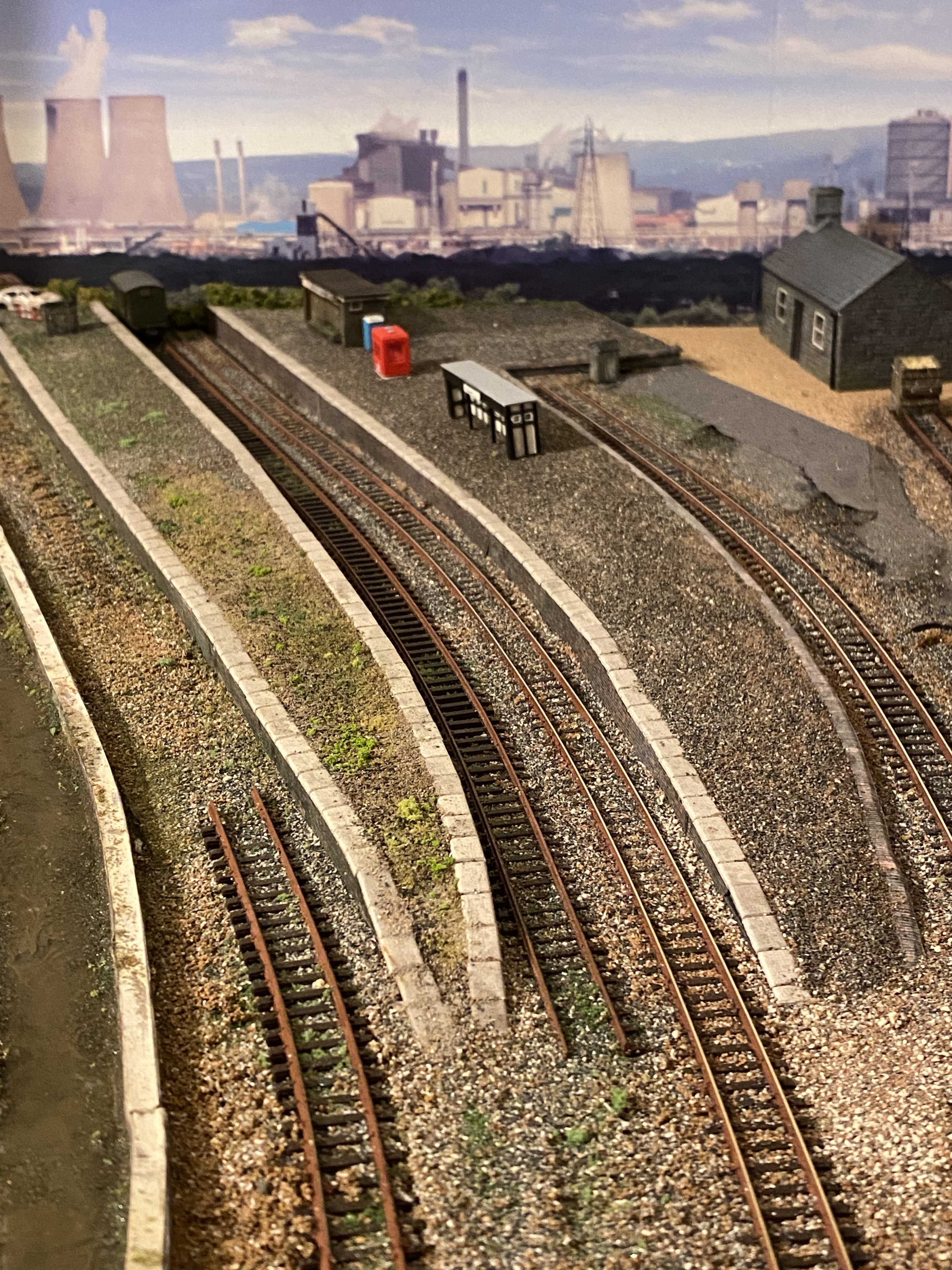

Some ground cover is going in. Careful use of sizes and colours means the greenery and stones are visually ok for both scales.
Boghouses has gained a sign - suitably located!
 Meanwhile Tŷ Bach continues to evolve with platforms now fully covered in sandy gravel. Because I didn’t like the look of half being printed “tarmac” card.

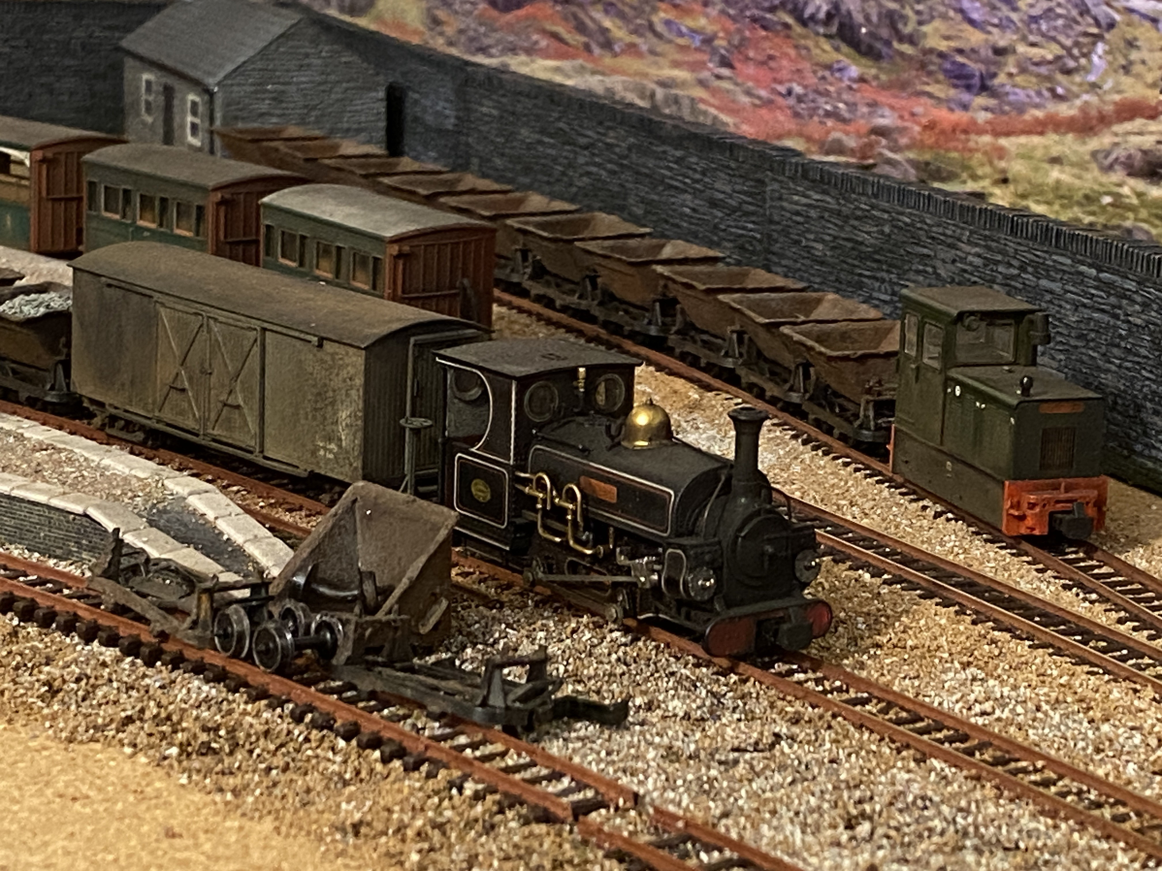

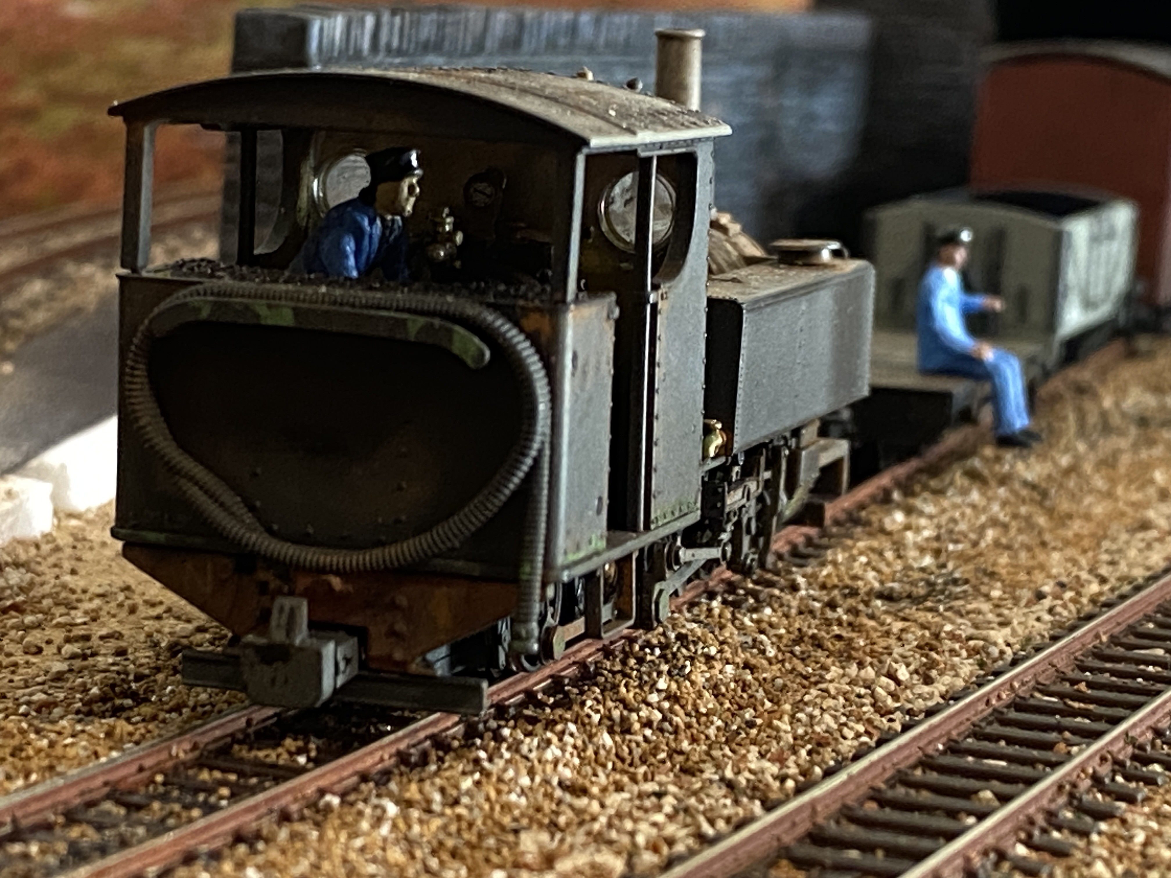

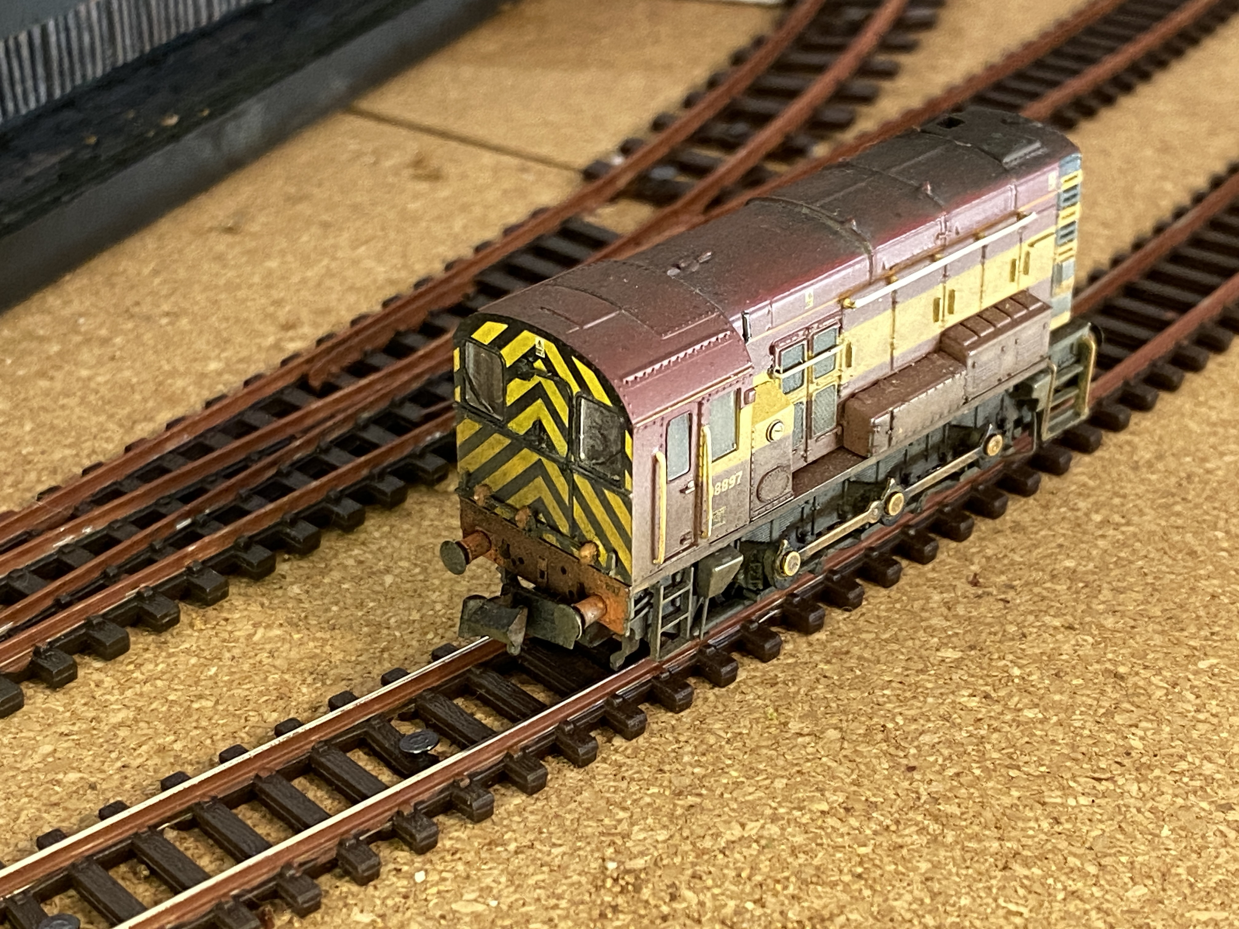

Let’s try those pictures ….. again
Item has a rating of 5 (Liked by Barchester)
#290778

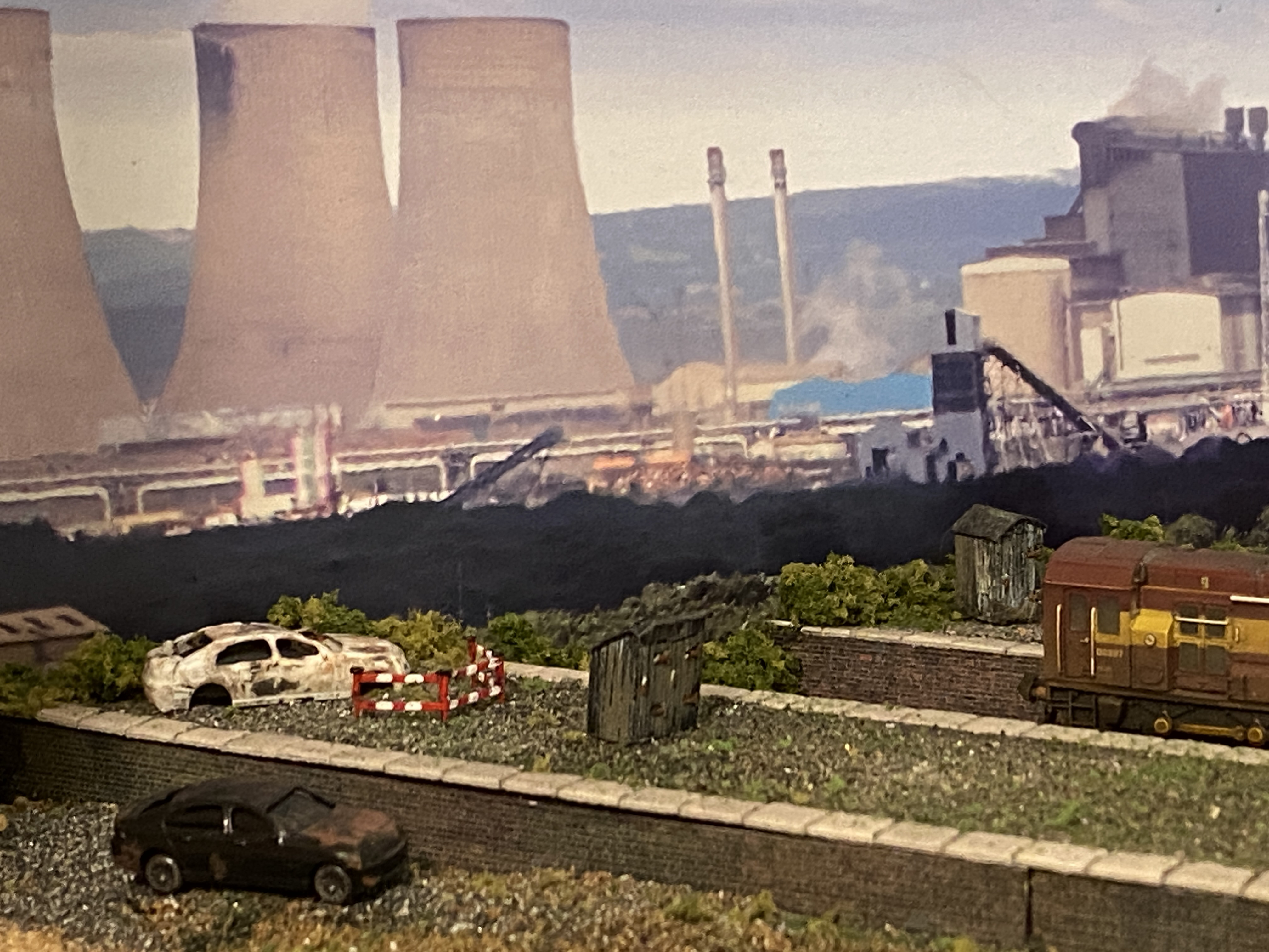

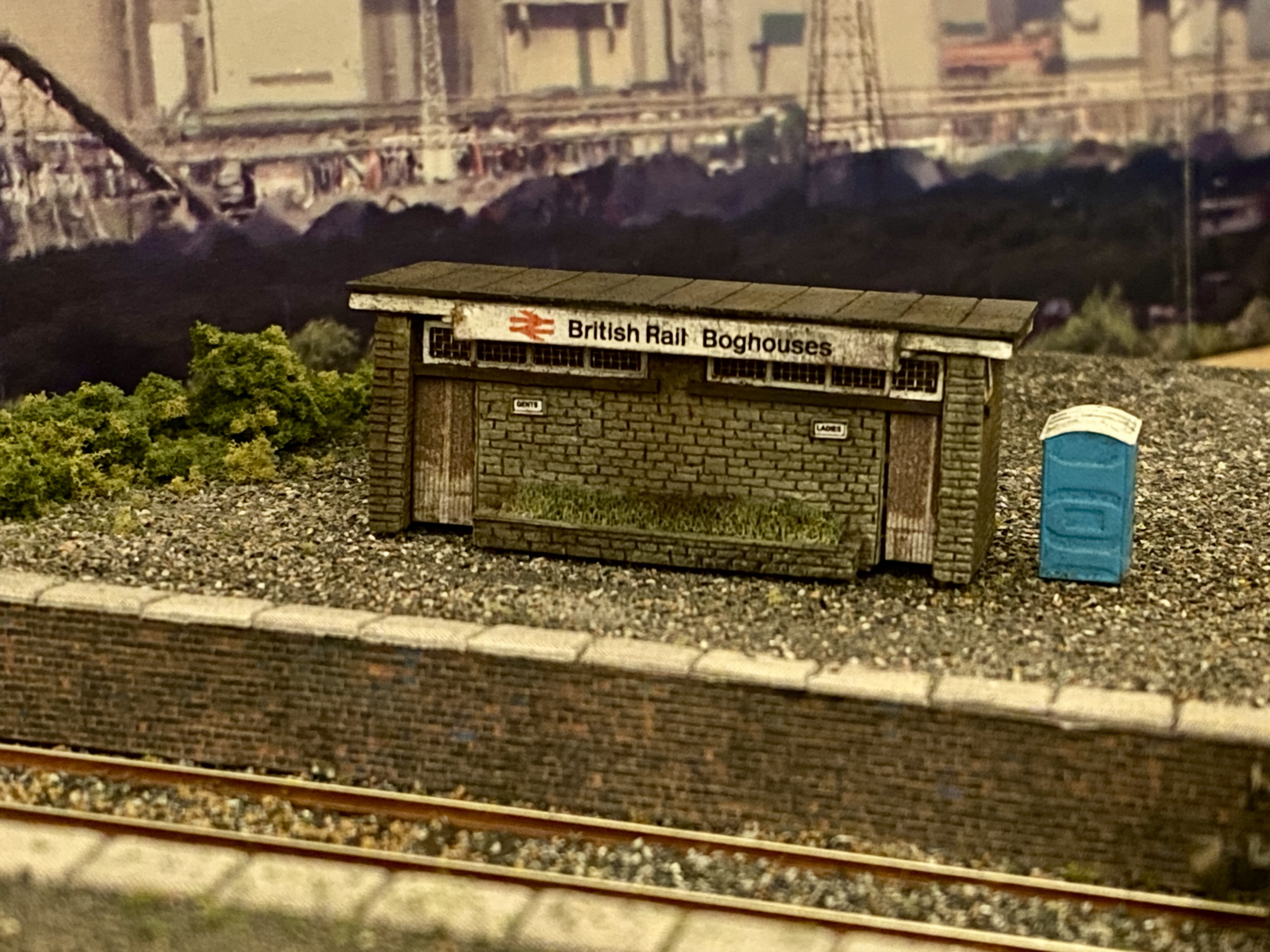

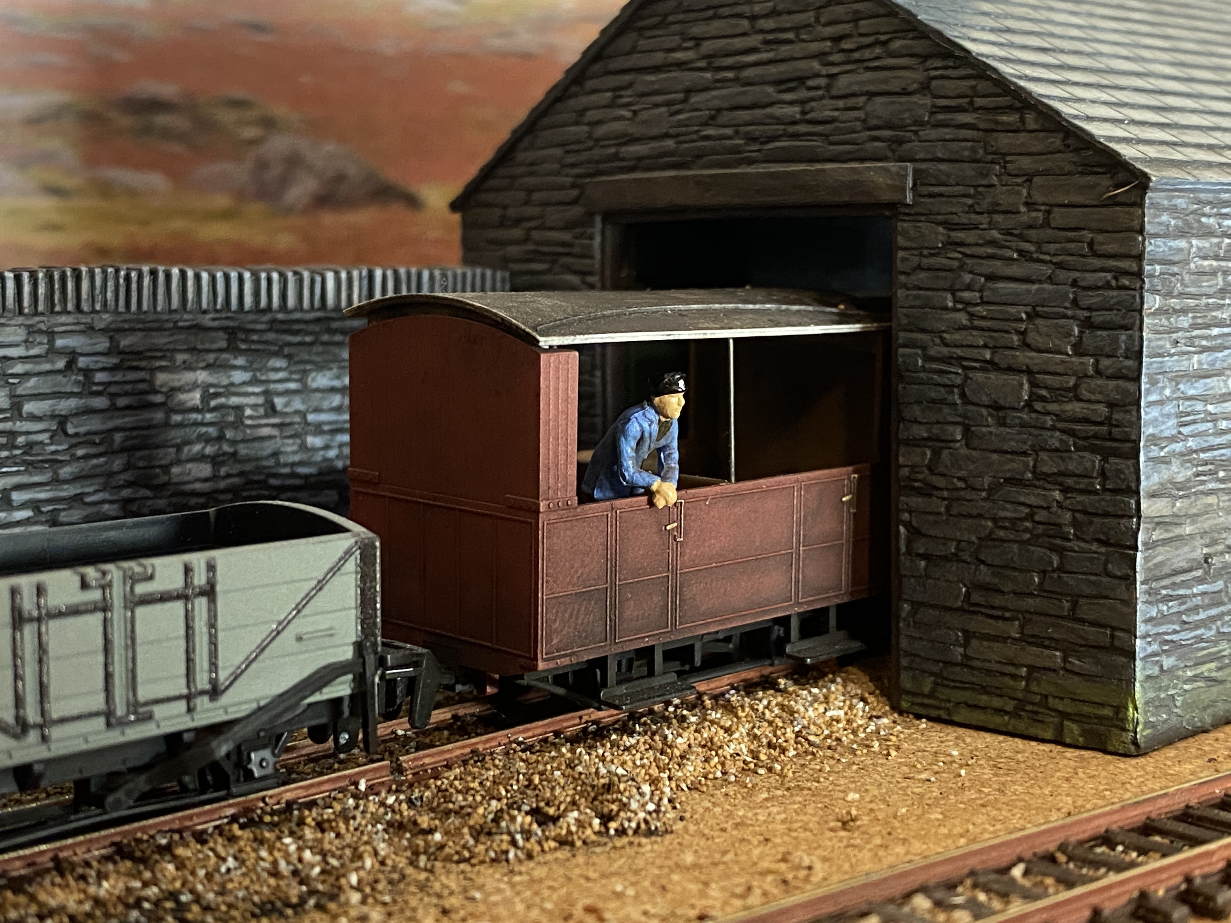

As can be seen from the last image the …. errrr ….. bog-houses have been closed and replaced by a portable “facility”.
Scalescenes corrugated panels have been glued into the doorways. The building has also been weathered.

I was about to say the Boghouses look a little dilapidated but now you've explained ……………………
Suitable scruffy platform ends - I like the scrap car left there.  The backsecene blends in quite well too given the obvious difference in scale.
You didn't mention the public viewing again after the early warning post - does that mean it didn't impress or are you too modest to tell all ?
#290794

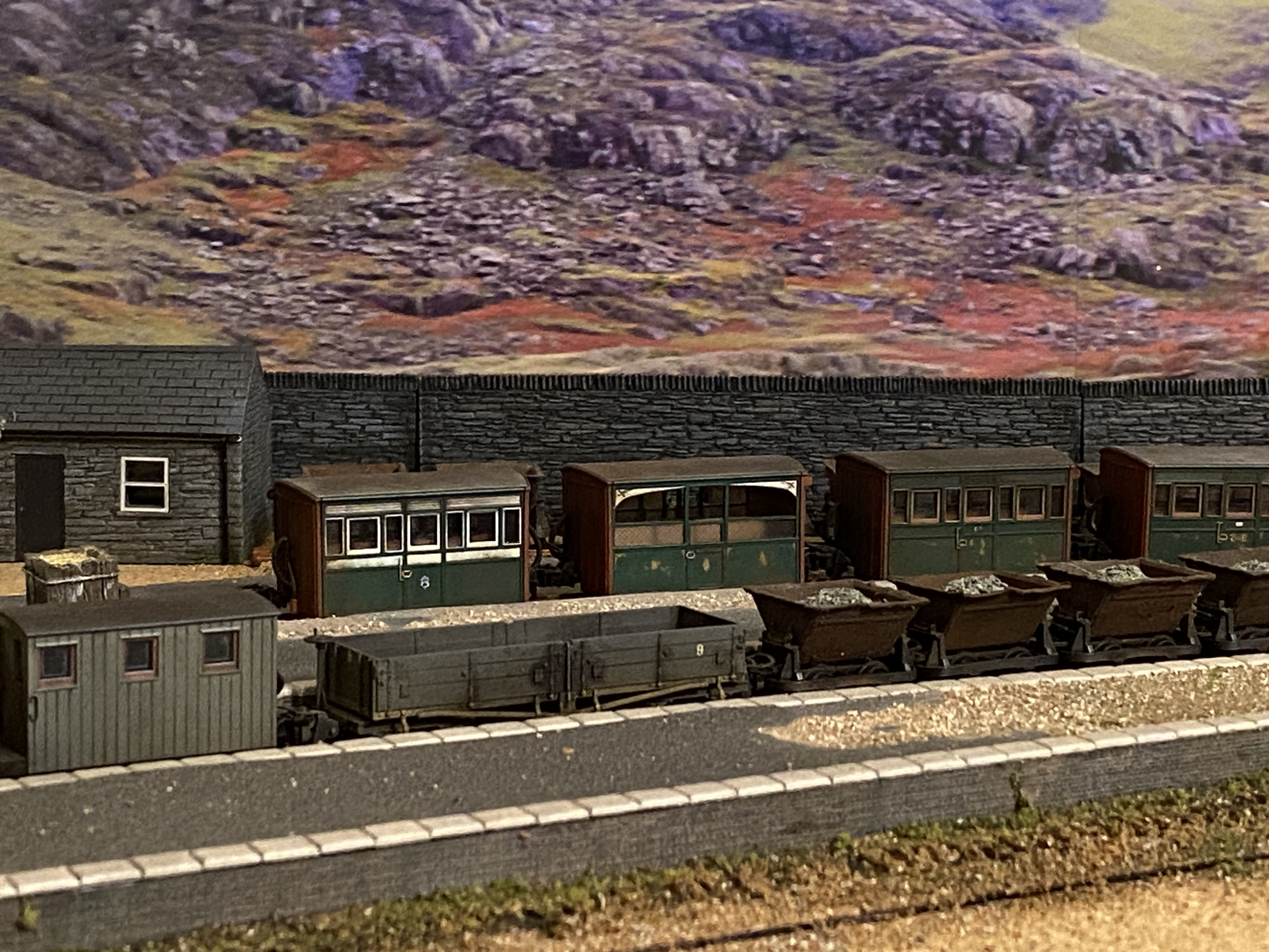

Petermac there should be no difference in scales between backscenes, trains and buildings. All the industrial stuff is 1:148, all the mountain stuff is 1:76.
The difference lies in what is fixed. The platforms, which conveniently allow for both scales in the nearer one (though not the wide-body 009 passenger stock) and the slightly elevated track on the far side allowing those 009 coaches to offer near-ground level access. Or N-gauge locos a berthing facility without looking too high.
Currently the river / canal is in build which again uses a compromise scale approximating to 1:120 (or TT120). The brickwork sheets from Scalescenes are printed at 63% of OO size which offers a good balance. Unless you are a rivet-counting micrometer-toting bricklayer!

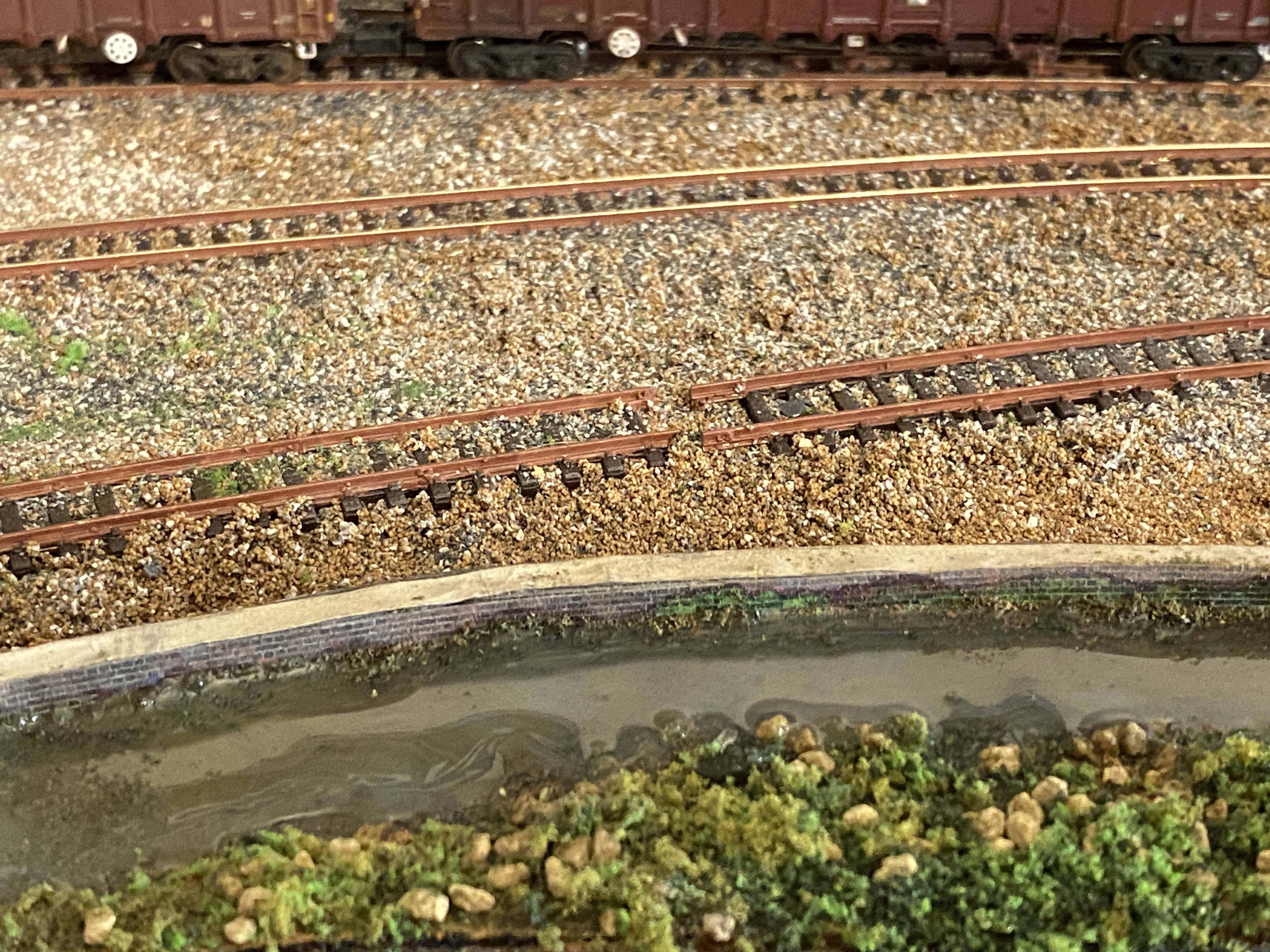

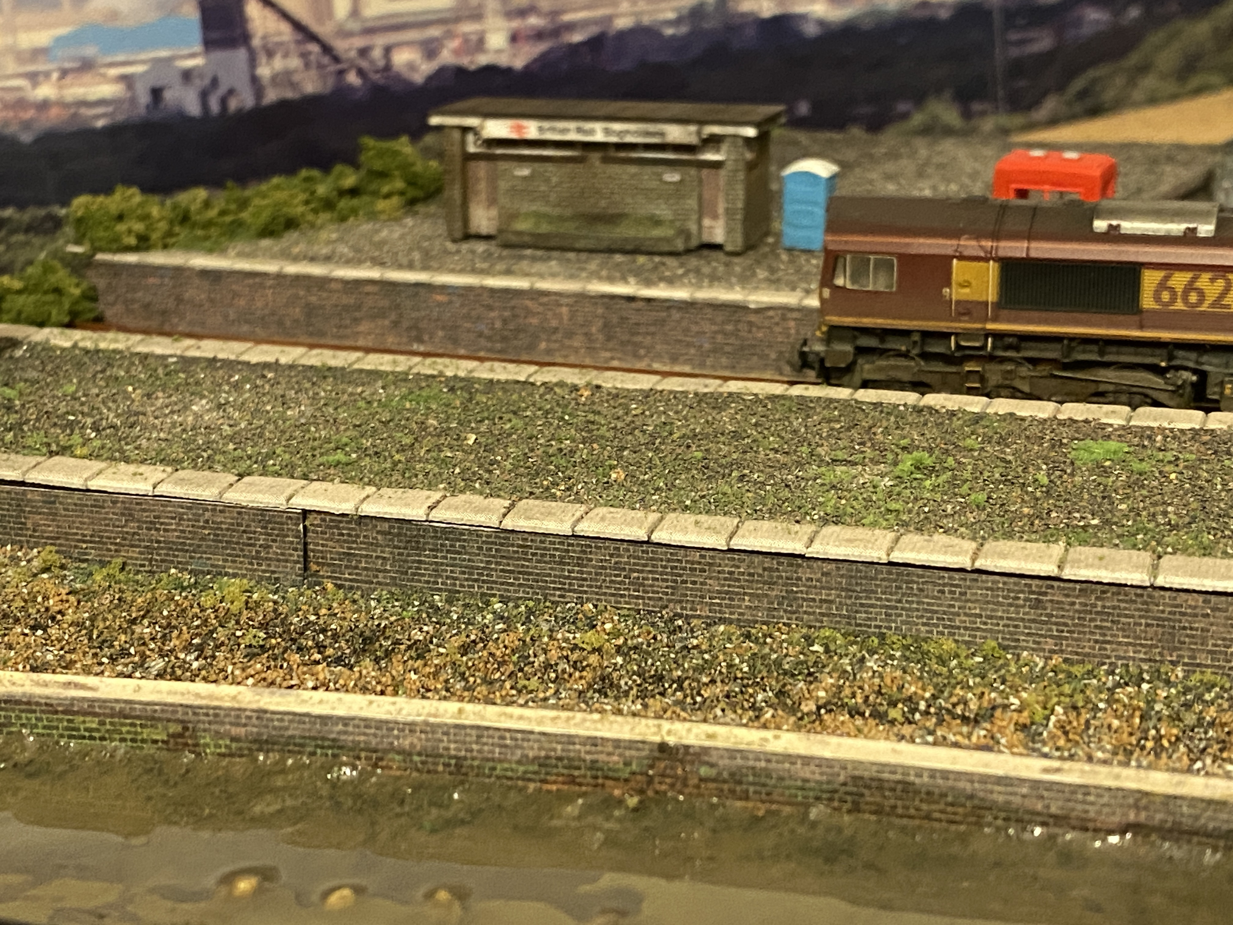

The very last session of the year saw the final pour of water into the canal / river scene.
Two colours have been mixed - a mossy green and a slimy brown - to create the base colour. This has also been mixed into the top pour which gives colour and depth.
A mix of fine greens and browns has been used for the bankside mud and greenery.
The water is Woodland Scenics “Realistic Water” which has bled slightly into the brick-print paper edging. I don’t mind the effect as it reminds me of slimy riverside brickwork.

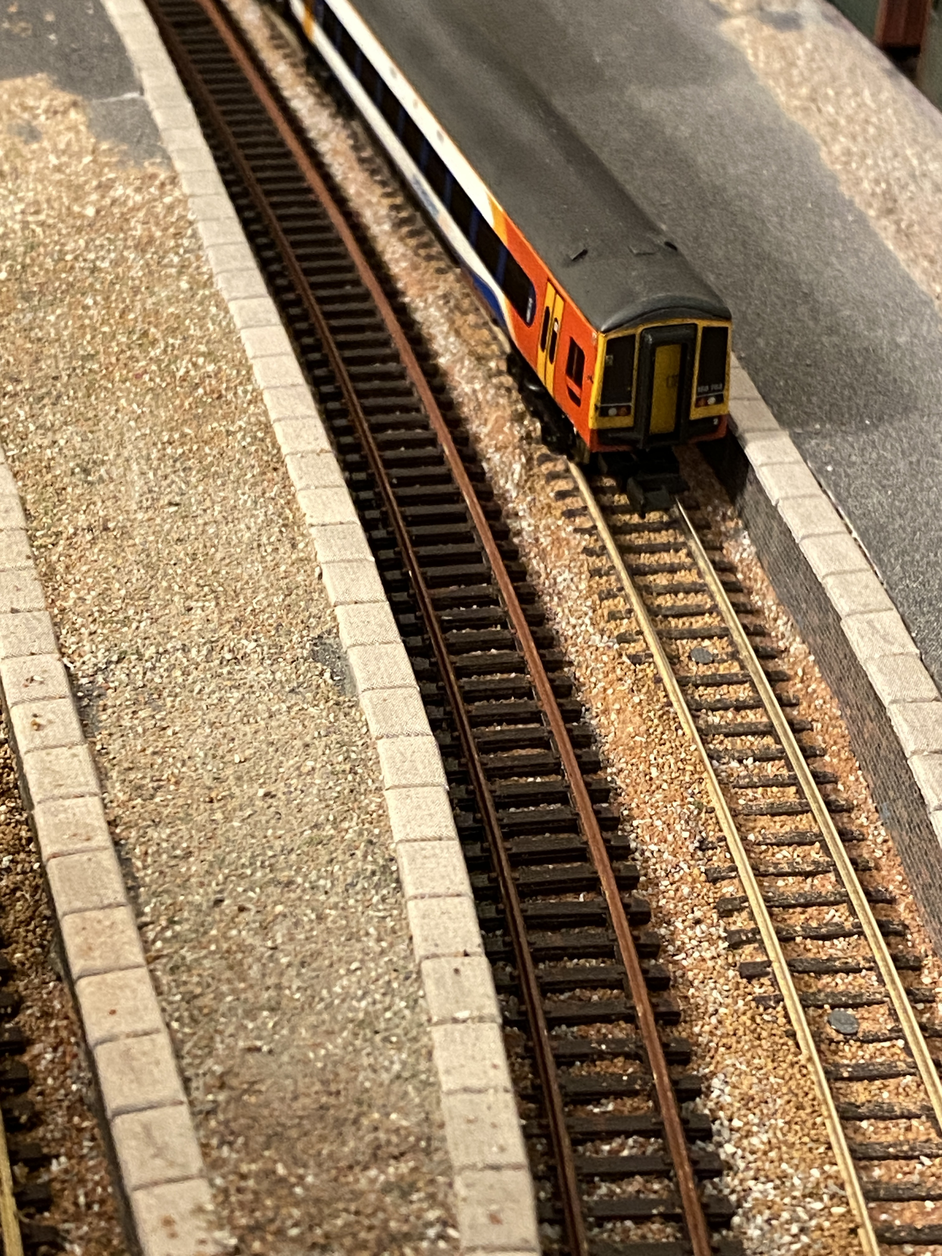

The first update of 2025. Happy New Year

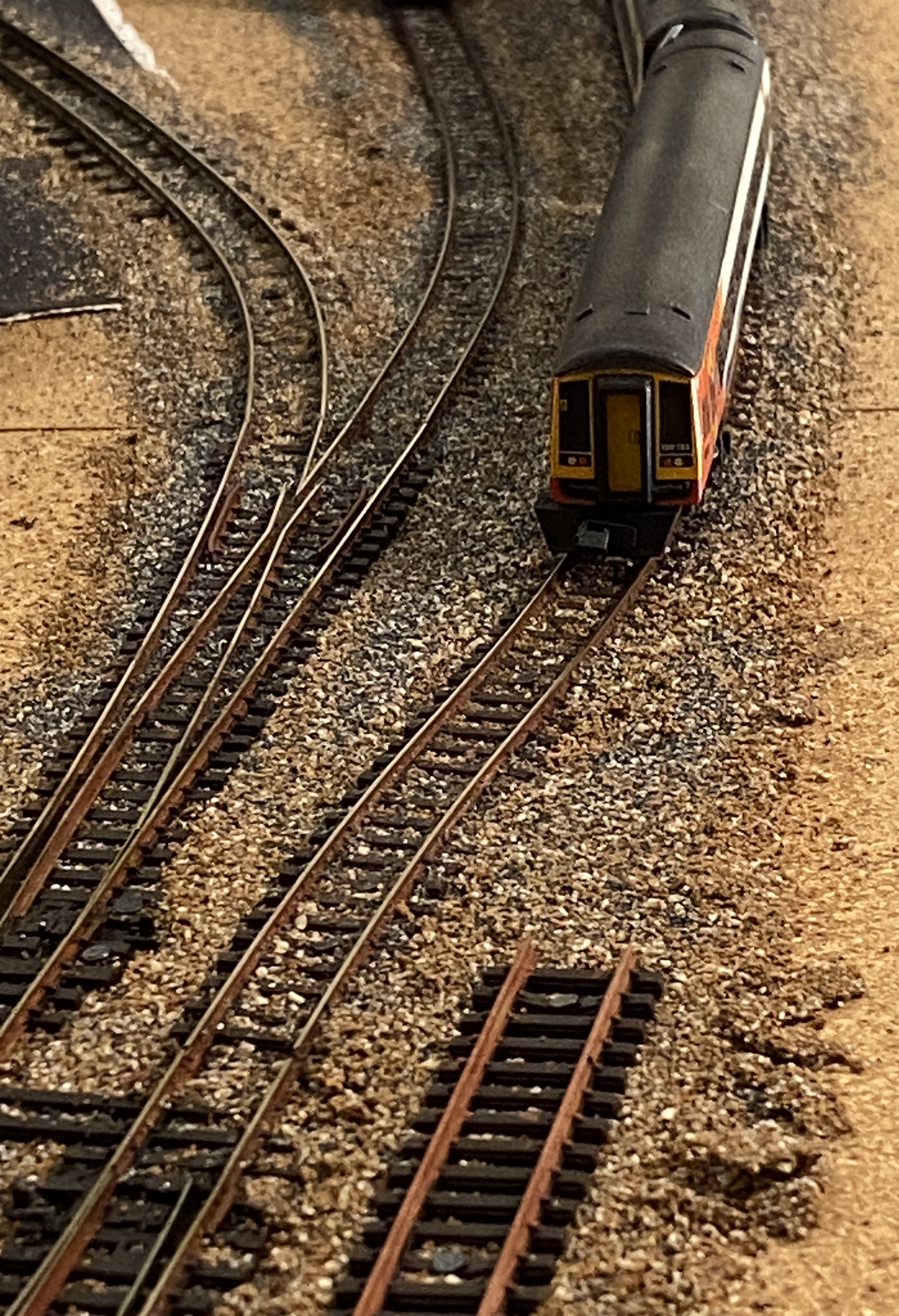

There is an offset in the main-line track on the approach to the station seen with tge class 158 negotiating it.
This is because at some point the double-track has been singled. Odd lengths of rail remain to show where the rationalisation took place.
The main-line would at one time have entered straight and fed to the now-disused island platforms. To the left of where the class 158 awaits time to return from what was once a through station. It has been a truncated terminus for many years now.
