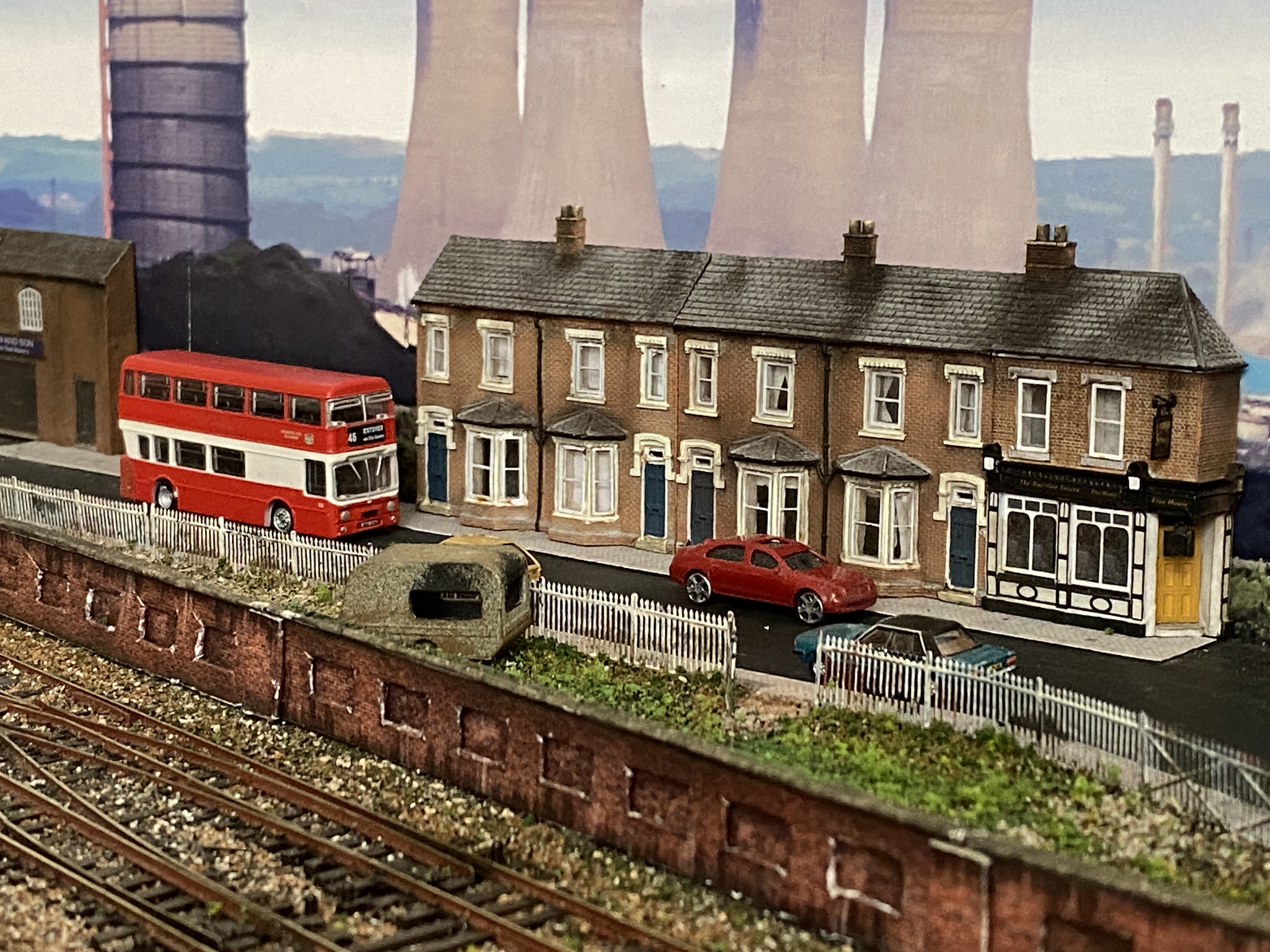

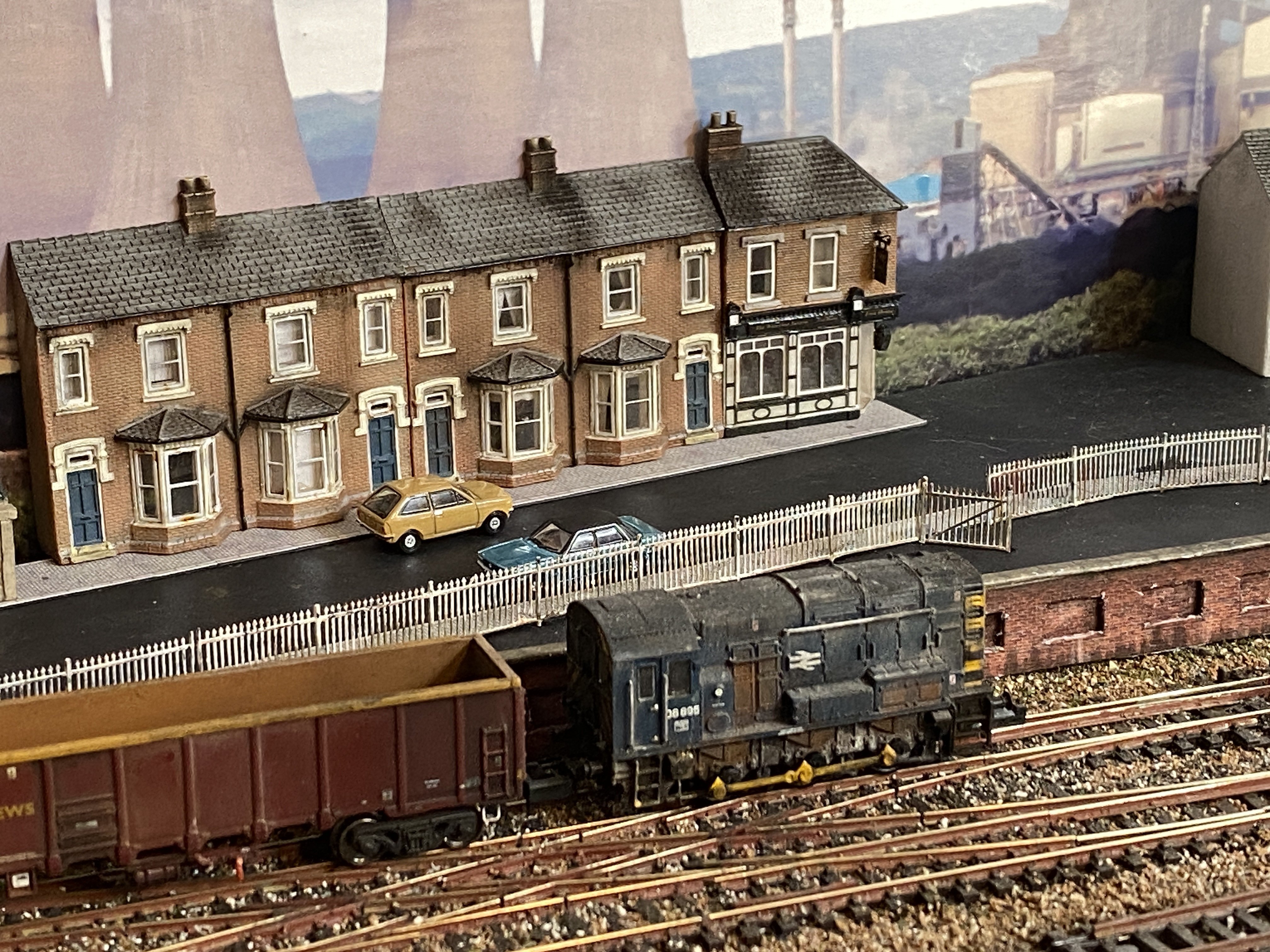

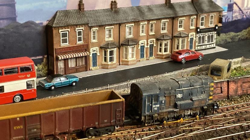

#292047
The additional buildings which will form part of the Boghouses street scene have been weathered, had curtains fitted and placed to gauge the effect.
The later pair of terraced houses has drawn-back curtains and pelmets rather than plain drawn or none at all. Fiddly doesn’t do justice to cutting and fitting those at this scale.
The bus is a Plymouth Corporation one but there are very few suitable N-scale buses available. It looks credibly generic for an East Midlands independent operator and may well lose its fleet name and crest.
I am not yet sure whether the final version will retain the alley-way gaps currently between the buildings.

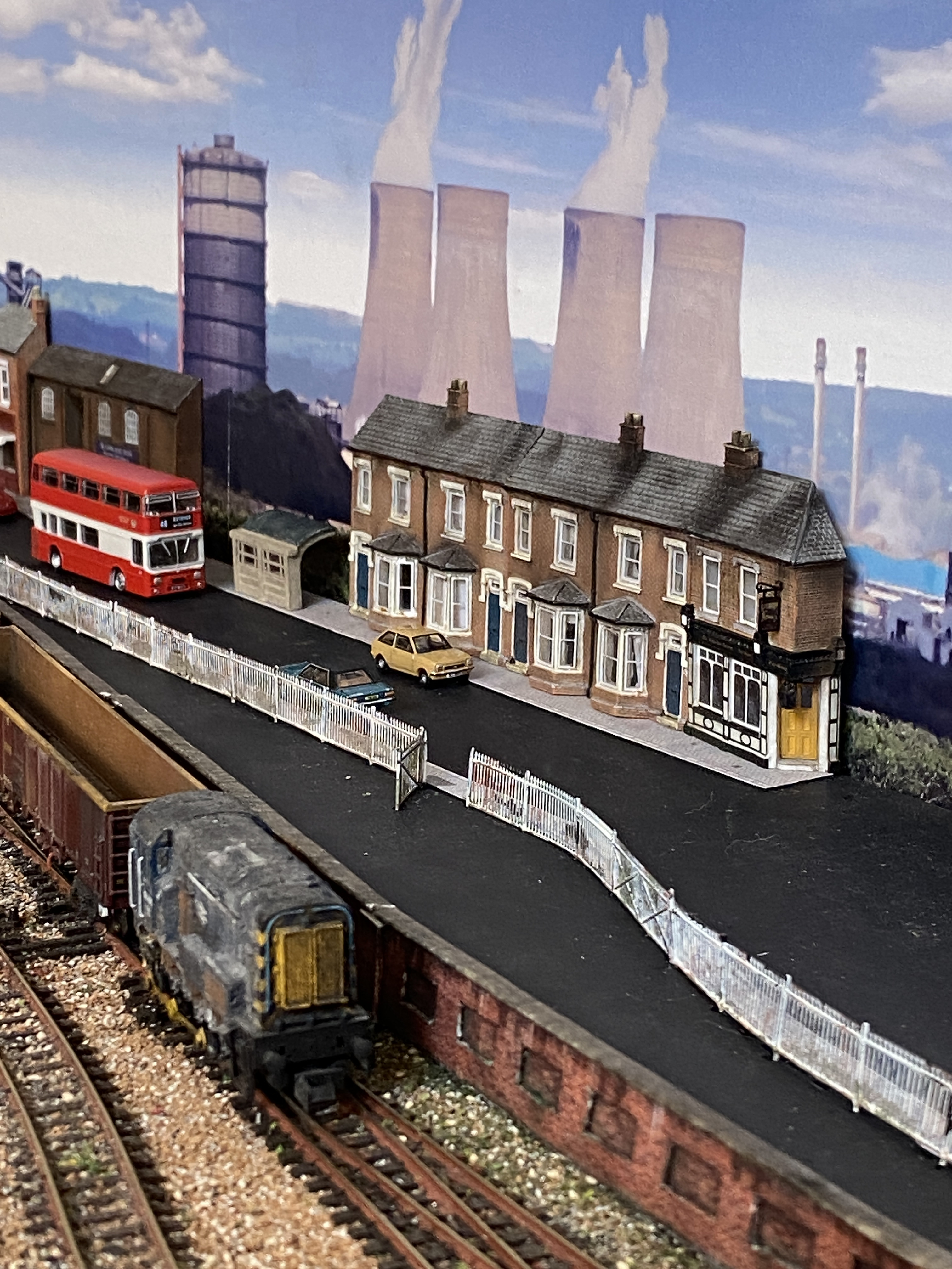

So what’s been going on recently?
Not so much. I have suffered an attack of gout in my fingers - a first as it’s always been in the feet before now.
But today I started on the N-gauge street scene with footpaths going in. A bus shelter has been fitted between the industrial unit and the houses.
Slow progress but it’s progress. And it’s fiddly.

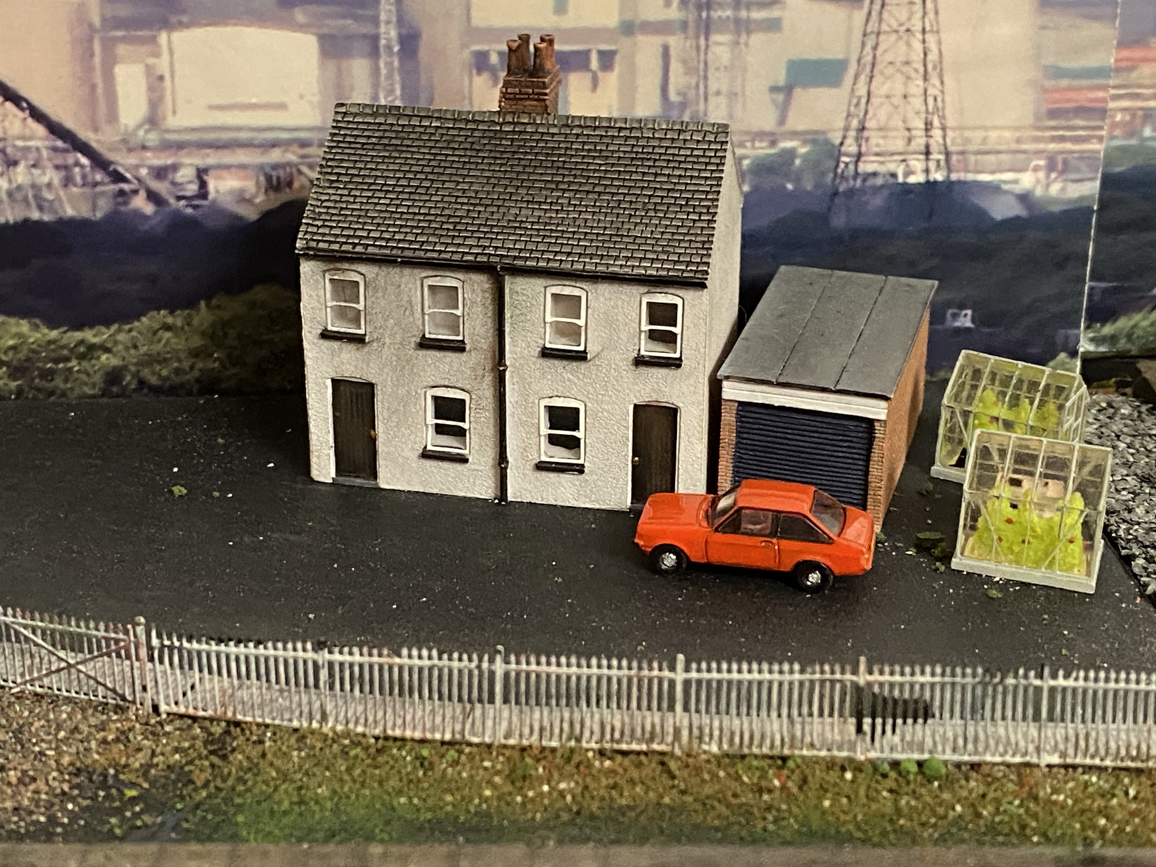

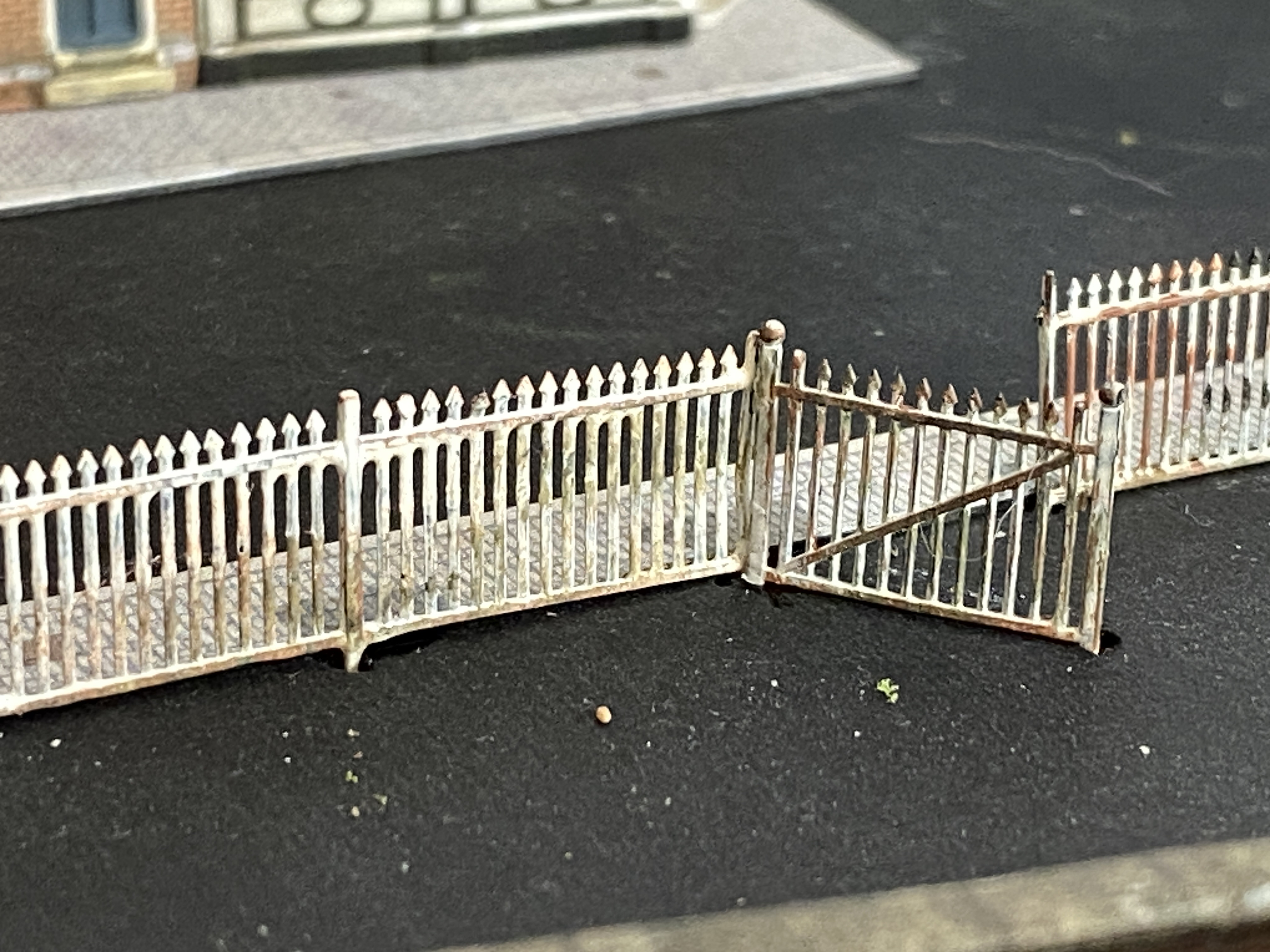

#292164
There hasn’t been much movement at the station in recent days. I have been both awaiting parts and busy elsewhere.
Yesterday the N-gauge spear fencing arrived and was painted. This morning it was fixed into position.
Black plastic has been painted with “warm white” acrylic then dry-brushed with rust, moss green and black and finally run over with a dirty weathering brush to take down any residual sheen.
The enclosed area will become a rough playground / dump.

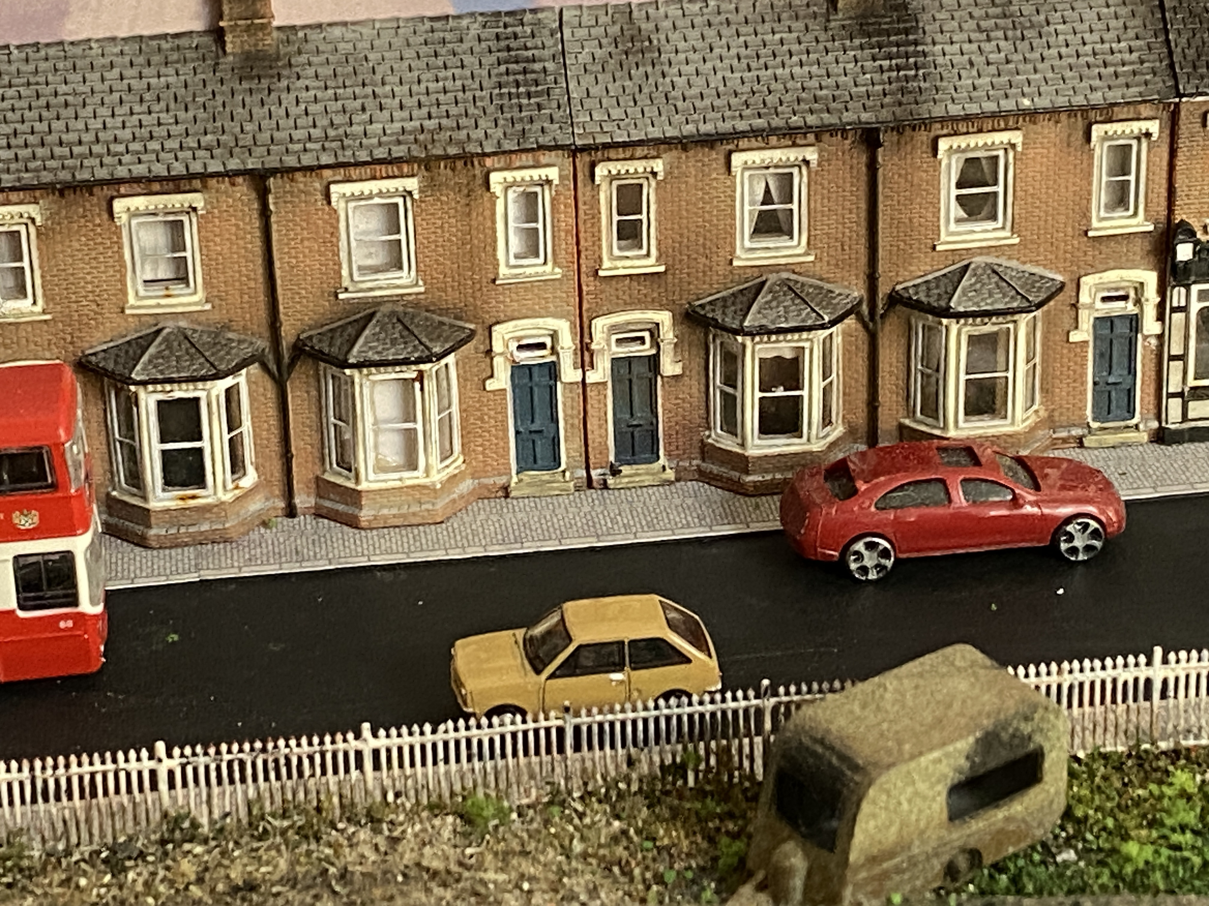

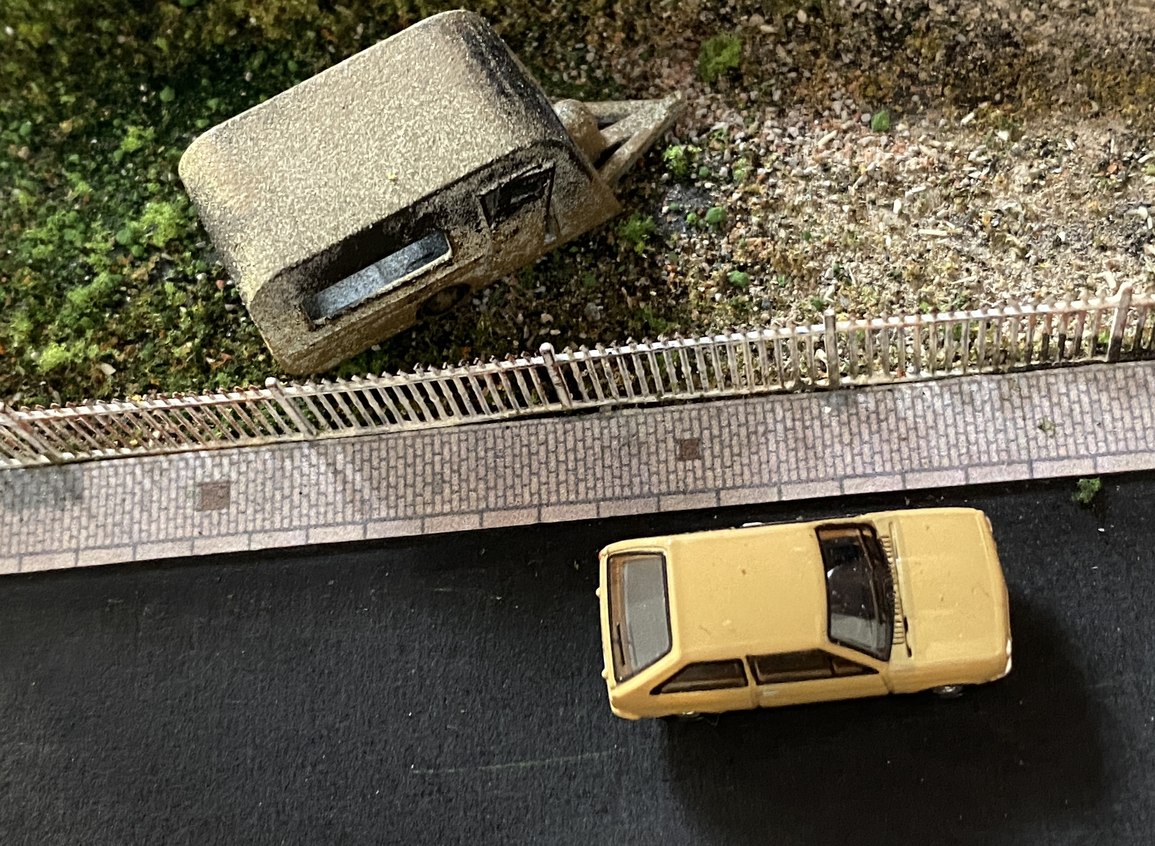

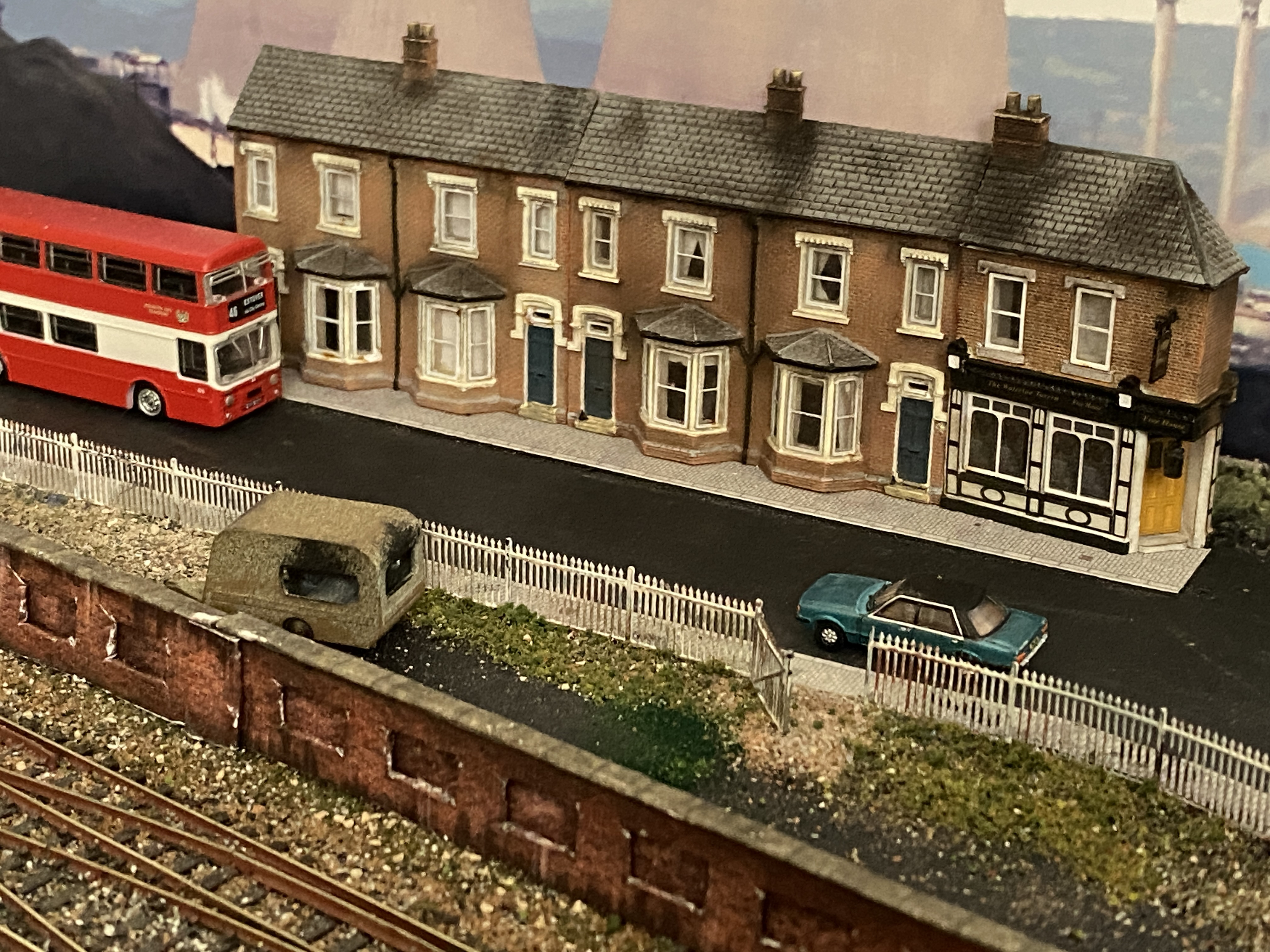

#292165
A bit more complete. The burned out caravan was on the disused station platform but feels more “at home” here. The reverse-angle is hard to capture due to the proximity of the wall so is almost an overhead shot.

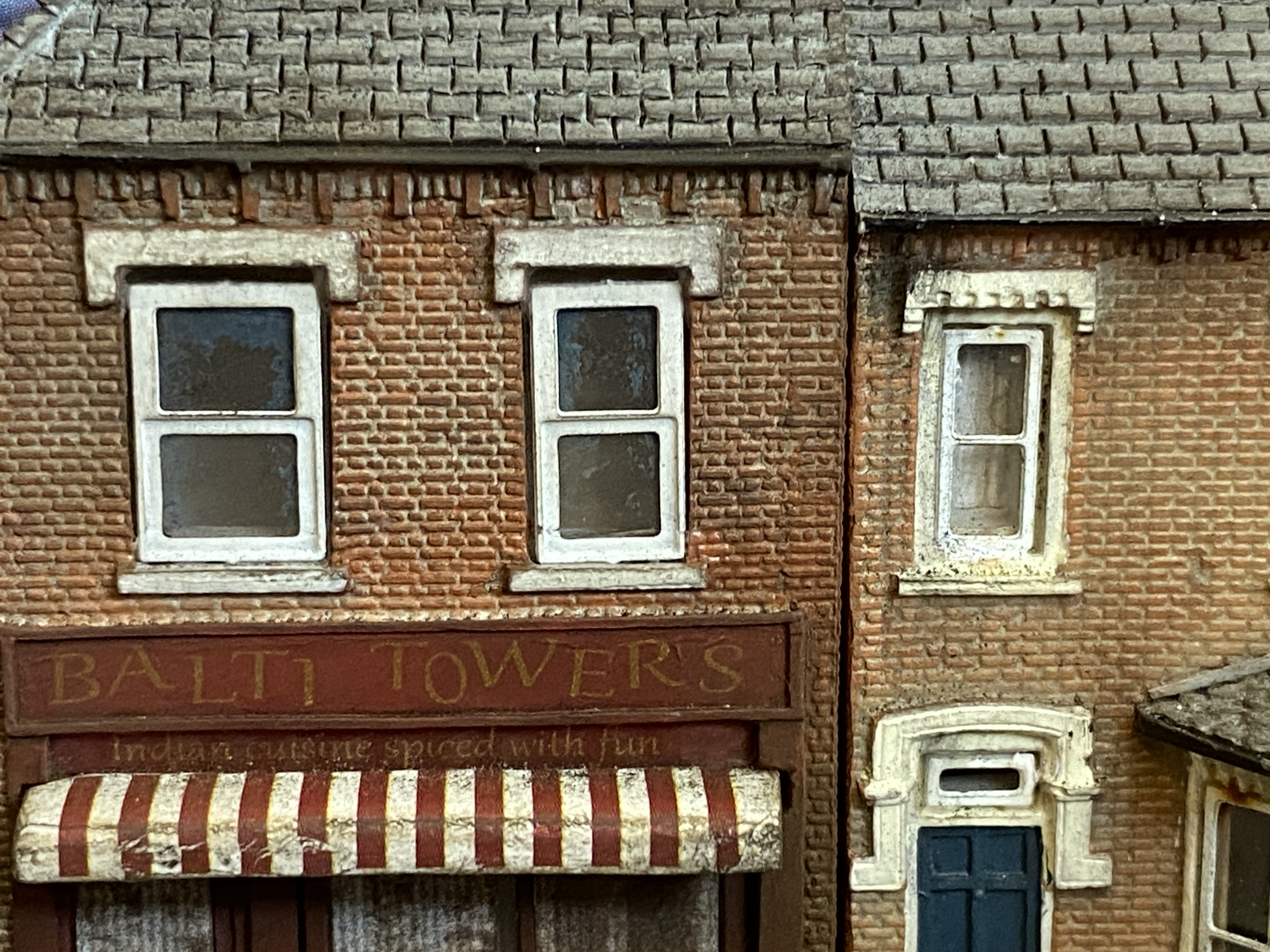

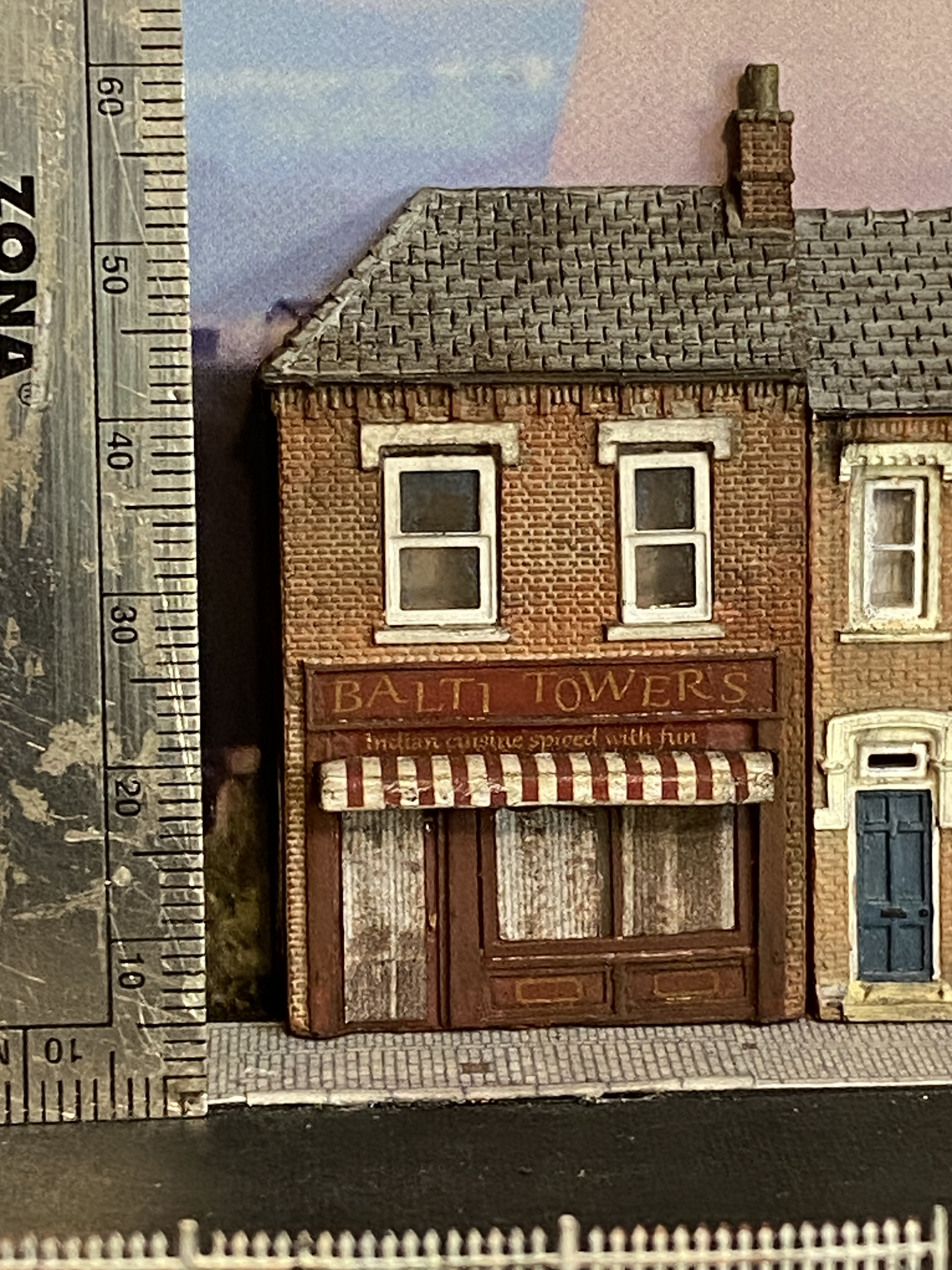

#292166
No more curries in Boghouses. The Balti Towers has closed. Weathered, curtains and corrugated all my own work. Ruler for scale

#292169
Great bit of modelling Rick, it's very small :thumbs3:
#292171
Perhaps the restaurant's name is too close to 'Fawlty Towers'!
Well done - both with the build and with the name.
