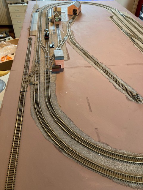

You've certainly got an excellent layout there - and all on an 8 x 4 board !! Plenty of operating potential and even more scenic work to enhance it. Looking forward to progress although I'm pleased you still have the TT stuff waiting in the wings …………
This little layout will be a nice diversion and I plan to take my time putting it together. The big hurdle for me will be wiring up the DCC droppers and the point motors, both jobs I dislike and tend to put off, but I need to do it before I work on the scenic stuff. As you say there is quite a bit of operating potential. I plan to have a couple of industrial buildings and a variety of goods facilities.
It is good to be doing some modelling again to keep me busy over the winter.
Bob

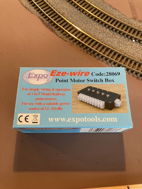

I mentioned my dislike of wiring up points, so to make things a little easier I bought three of these point/signal operating units. They appear to be very much plug and play:
So far so good and I am enjoying the rather relaxed approach that I am taking.
Those point controllers look interesting - I'll do some research although surely you still have to fit the motors themselves and that's just for the control ……
Which motors are you using - SEEPs, surface mounted, slow motion or something else ?
Bob

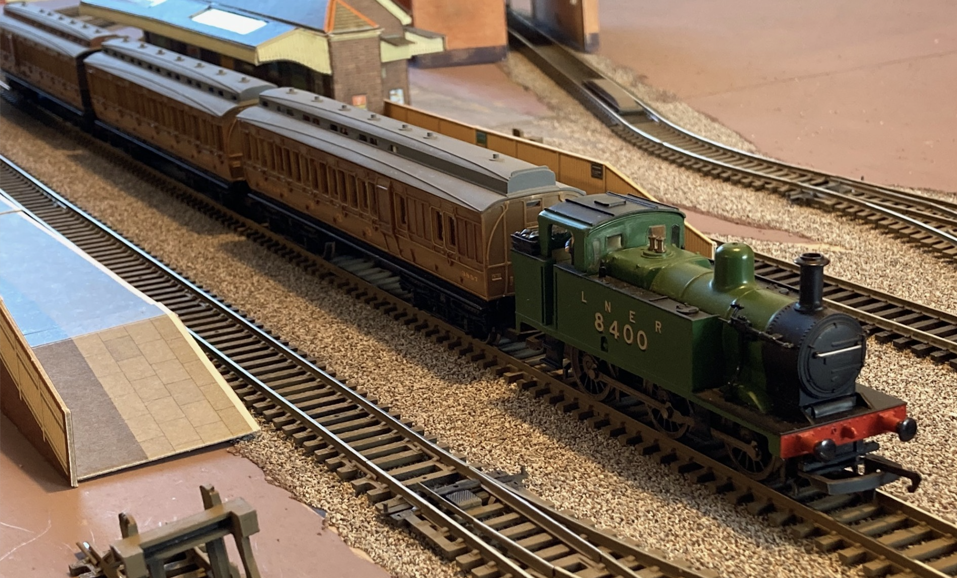

It's a great feeling to have something running isn't it - even if it's just a small circuit - I certainly miss my layout …………..
That's impressive Bob - I love those coaches although I admit the apple green colour scheme wasn't a favourite of mine …………..
From “Post #292,646”, 12th October 2025, 10:20 am
Thanks Peter, it certainly is good to have something to work on. My little J83s are all DCC fitted which makes life easy this time around. I have another three tank engines which will need to have decoders fitted. i'll do a picture of the loco fleet in due course.
Bob

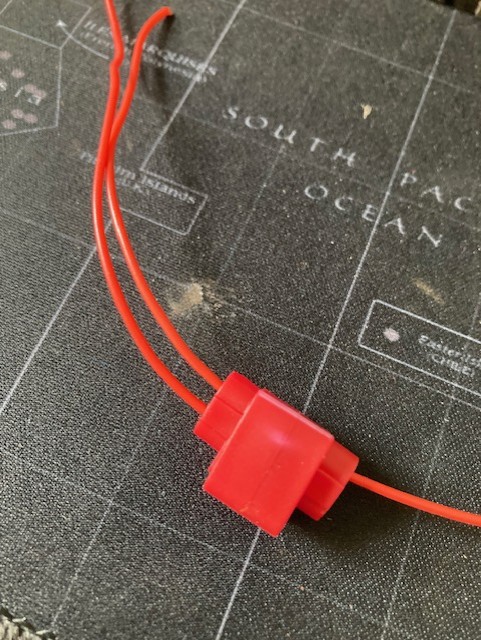

I have installed the DCC bus around the layout and I am slowly adding droppers to every section of track. Not wishing to use solder, I have used pre wired rail joiners, with the wire going under the baseboard through two holes.
To connect the droppers to the bus, I am using little quick splice cable Joints, little clips that create an electrical connection by splicing the wires:
Why 2 wires in/out and only 1 wire at the other end Bob ?
I'm confused again ……………………….
From “Post #292,688”, 17th October 2025, 11:15 am
Sorry Peter, I should have been more clear. This is one dropper from one rail, there of course will be a pair, the other black from the opposite rail. The wire going straight through is the bus wire. The single wire coming in is spliced into the bus wire, forming an electrical connection, no soldering, just clipped together. Hope that makes sense.
Bob

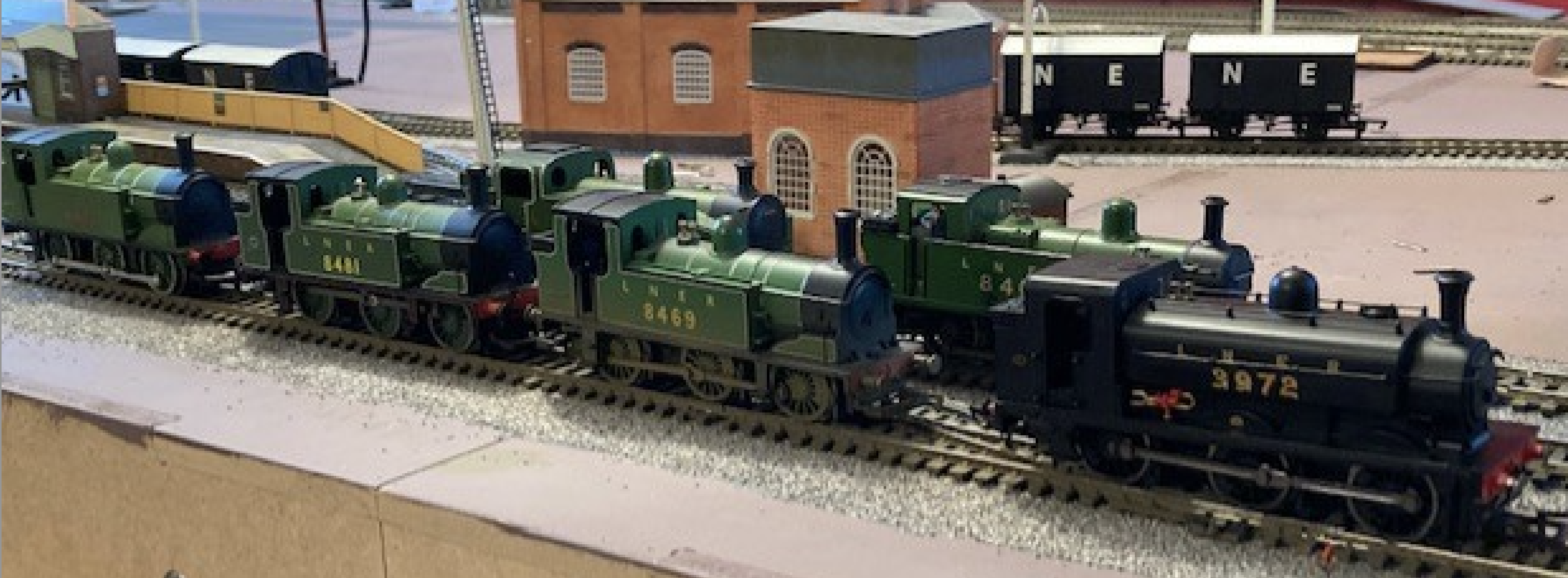

I have been slowly wiring up the DCC droppers and am about half way through the process. I am taking my time, doing a few each time I visit the layout.
In the meantime I have been fitting DCC chips and stay alive units to the locos. Again, this process is about half completed. I now have quite a nice fleet of tank engines, mostly J83s. I actually have more than I need, but it will be fun swapping them over when they end their duties. Here is a sample of the fleet:
That's a nice looking stud you've got there - good luck with fitting chips AND stay-alives in those - not much space under the bonnet ………..
