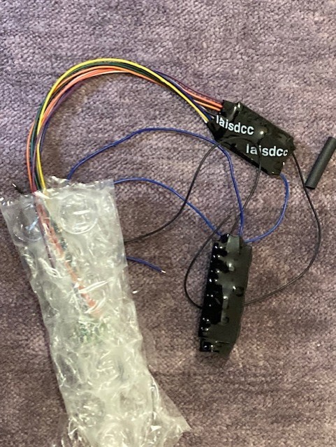

Hi Peter,
I use LAIS 8 pin 4 function DCC with stay-alive option.  They seem to work well in the litte Hornby locos.  The decoder and stay-alive can be hidden away in the smoke box or in the bunker.
Bob
#292889
I ought to have said  that I lean towards sound decoders Bob so I need space for a larger decoder, a speaker and a stay-alive !!
I have used those Lais stay-alives before (on non-sound chips) and they do seem to work OK but with sound, I try to use super caps which are more akin to the old "brick" mobile phones ……………………..:(
#292899
The Lais stay alives work well with sound too. With the charging circuit built in they make the running faultless. With Zimo sound decoders, the duration of the cap's run time can be adjusted, too.
#292907
I didn't know that Pete - maybe I should look at them in a new light …………………
