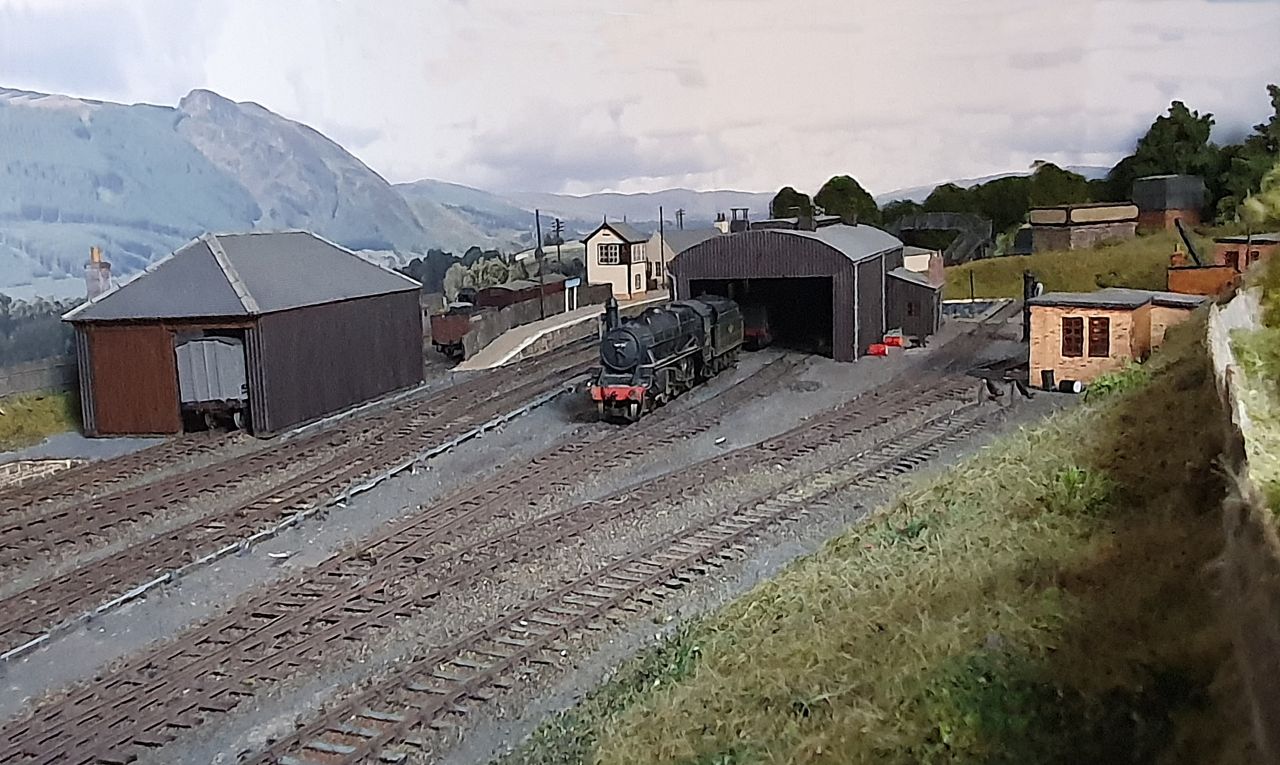

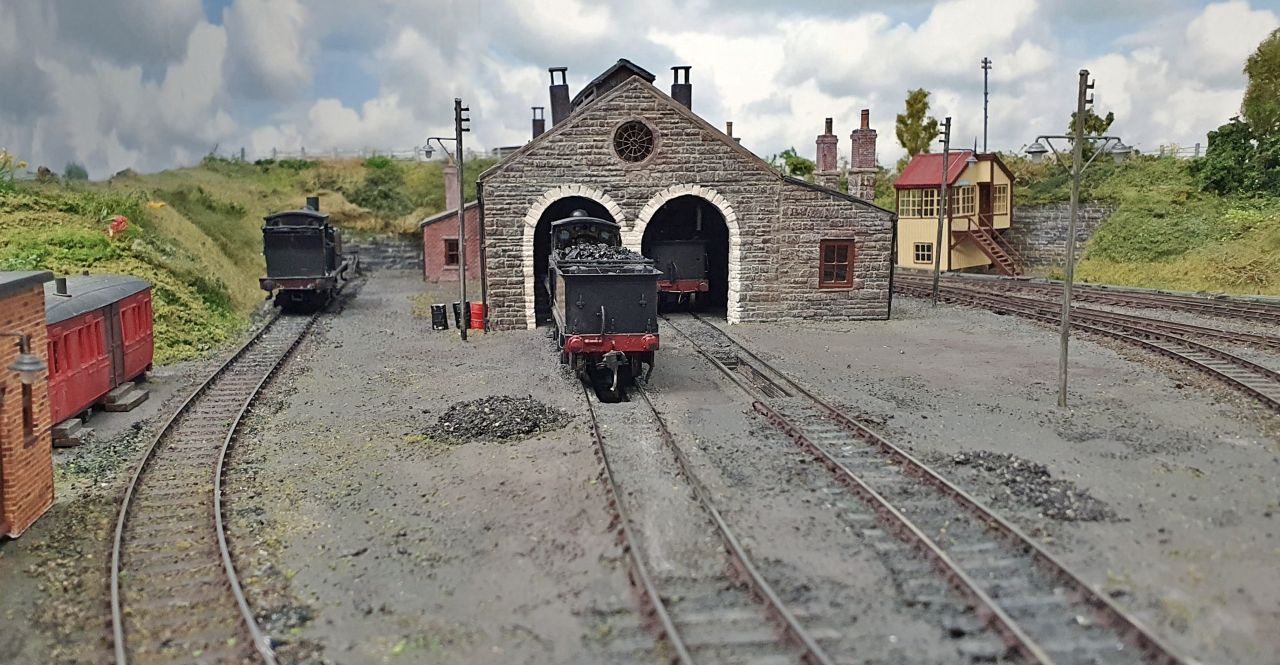

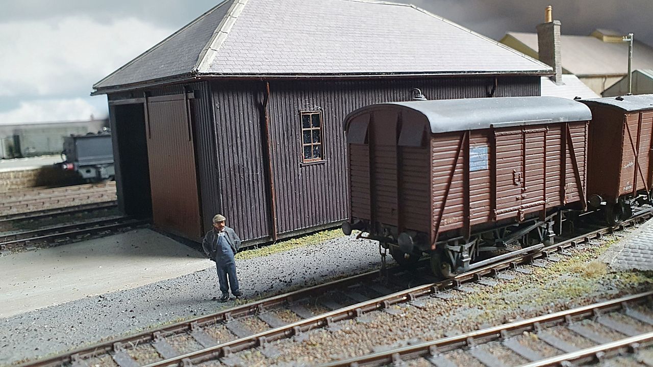

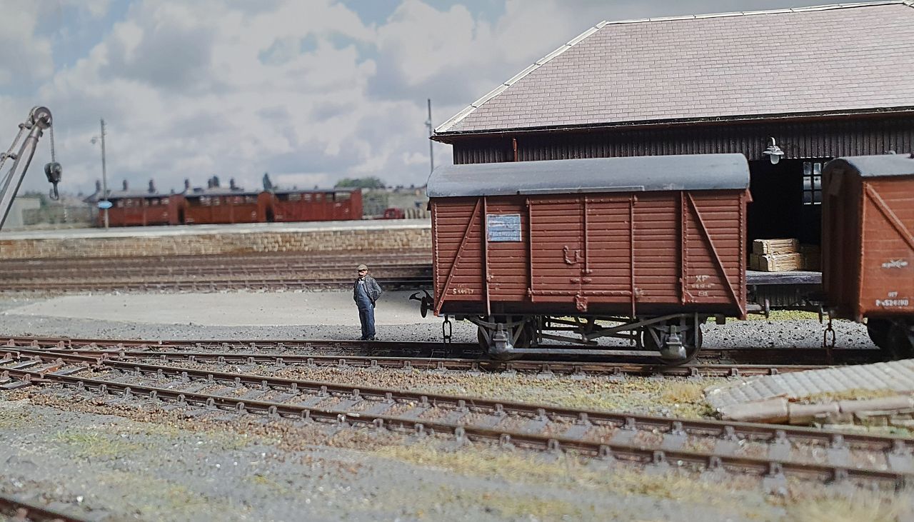

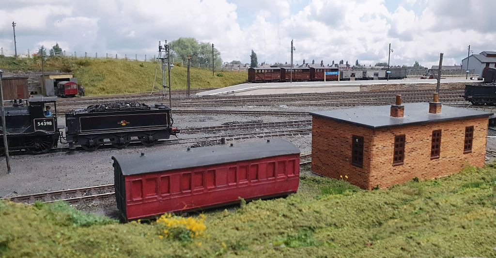

And two views of the yard at Thurso taken in natural light.

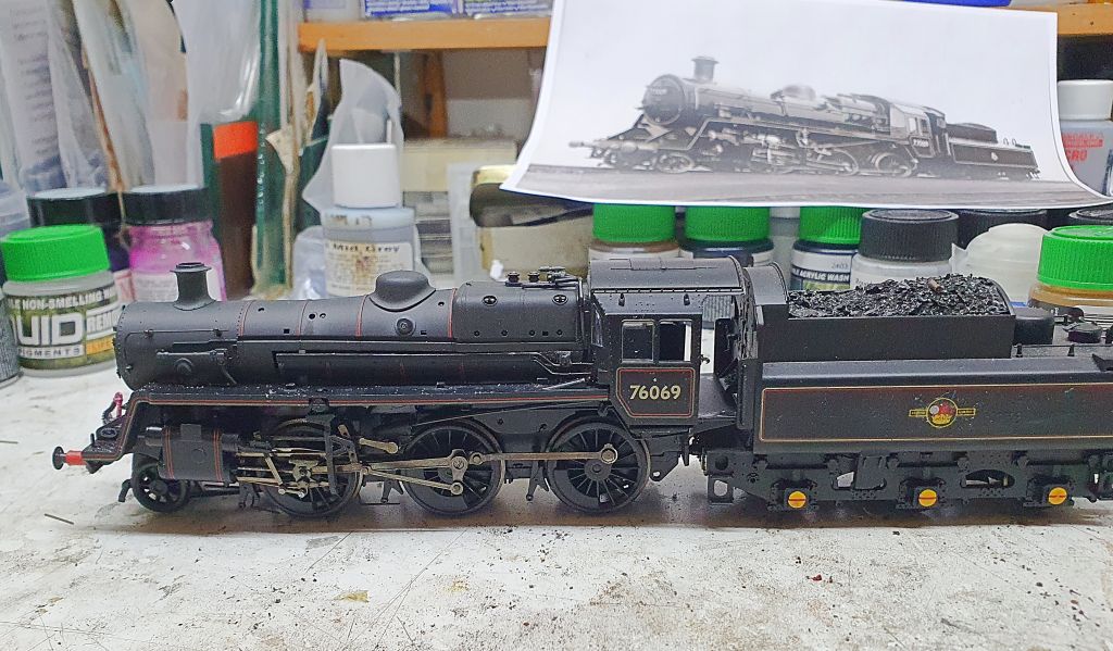

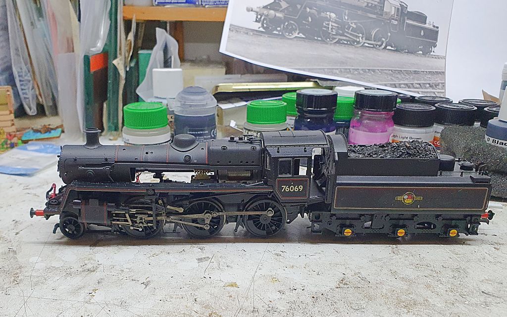

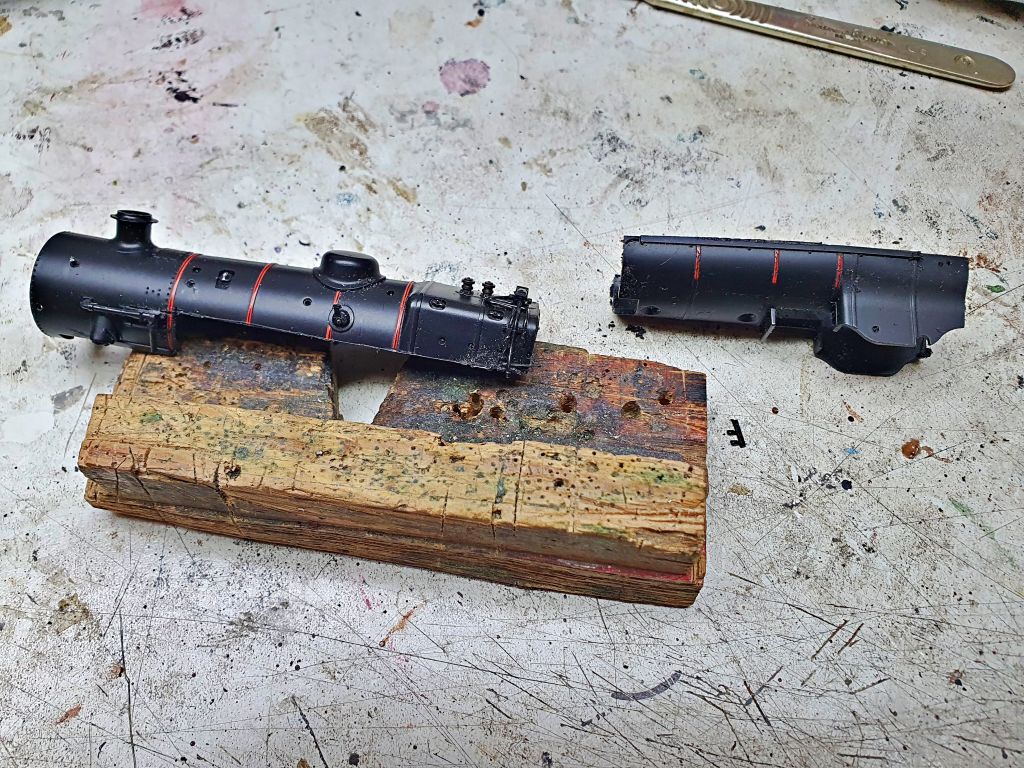

I managed it all without needing anything more than the new boiler to repaint, which saved a good deal of work of relining.
20260204_000017.jpg 20260203_002721.jpg A look at the genesis of the 77xxx now, as promised. As said, a melding of the 82xxx tank boiler and the 76xxx body minus boiler with the missing under boiler added from the cut off 76xxx boiler and the grooves in the 82xxx boiler where the tank slotted into filled in with plastistrip and a good deal of filler. I didn't take pics of that stage  much  but here are the basic bits of it all.
#293605
Well, the usual hiccups over picture and text positioning, but the gist is there - one day I may work out how to do it properly….
The detached under boiler was sliced down the middle and narrowed so the diameter and taper matched the smaller 82xxx one  - crude but effective, I'm afraid.

Intrigued by the 'natural light' shots - is the layout near a window or can you take it outside ?  If the former, I was imagining the effect of summer sunshine but I suspect where you are, summer sunshine is just the odd couple of days when the temperature soars to around 20 C ………:mutley  Where I am just now, we're being hammered by highs just a tad over 40 C and night time lows all the way down to a freezing 25 C ………………

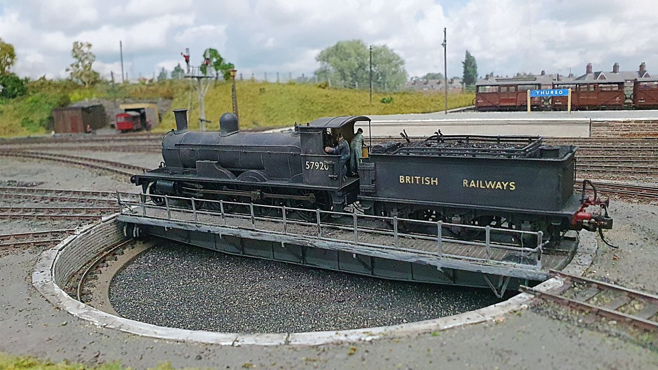

20260620_000113.jpg 20260629_232202.jpg Couple of recent shots - an overhaul has been going on and I'll look in to it in more detail later, but the Thurso turntable has been enlarged with a Kitwood Hill 57' one instead of the previous 50'  which gives a lot more operational potential. Some shots of the destruction…
#293651

It is in a small attic with a Velux window and illuminated by 6500k natural daylight tubes and I find the best true daylight shots are on an overcast sky, which gives a "scale" daylight - a bright sky produces too strong a light and shadows, but the tubes are a good second option.

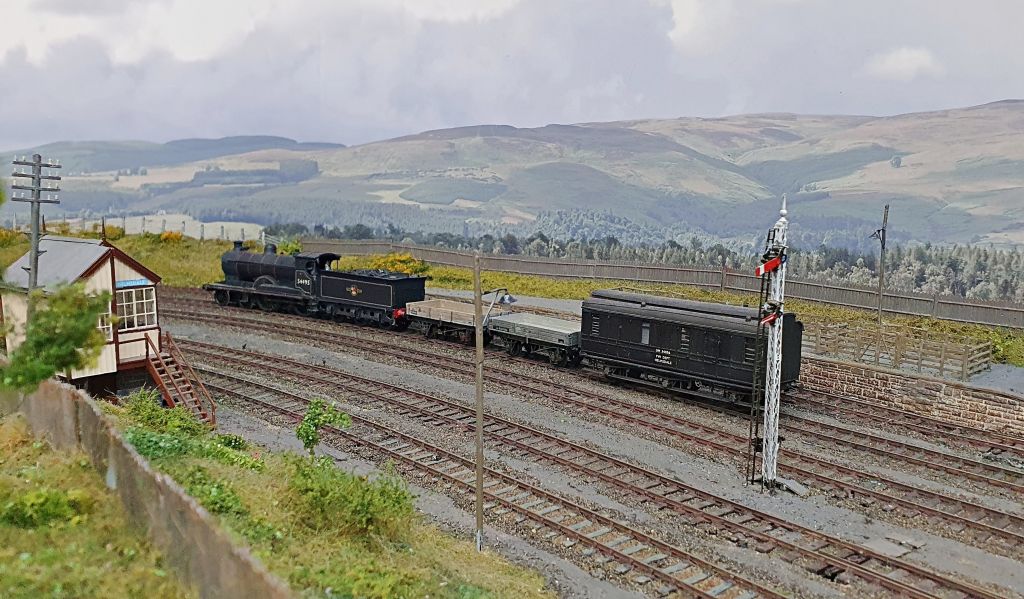

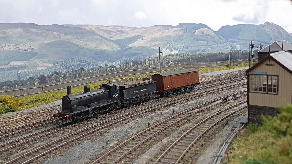

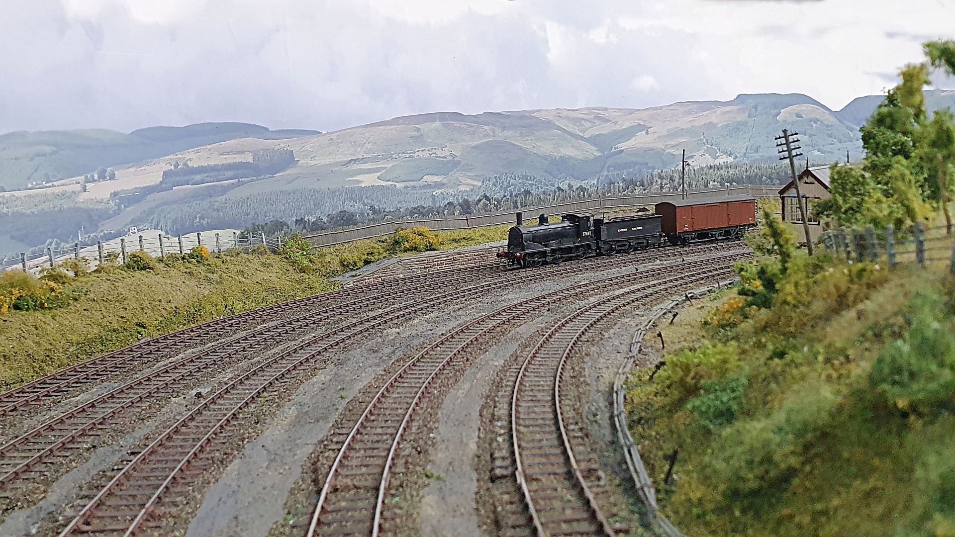

20260805_221719.jpg 20260805_215942.jpg Couple of random Helmsdale pics here … 20260805_215843.jpg

Lovely shots Richard - I love those big sweeping curves and the scene captures the 'emptiness' I'd imagine the line experienced regularly.  Having said that, not many small isolated stations could warrent 5 tracks !!
#293708
Ha Ha! From L to R, the recently extended goods yard line that was also used as an overnight stock storage to keep the up and down lines clear. the next two the up and down through lines and the last two in reality were two storage sidings  but I have altered that to the engine shed access road and the furtherest right a storage siding.

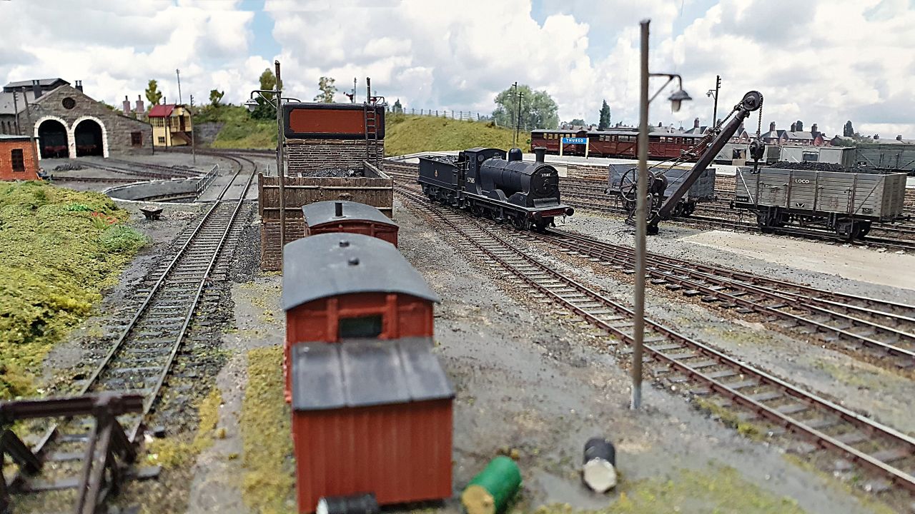

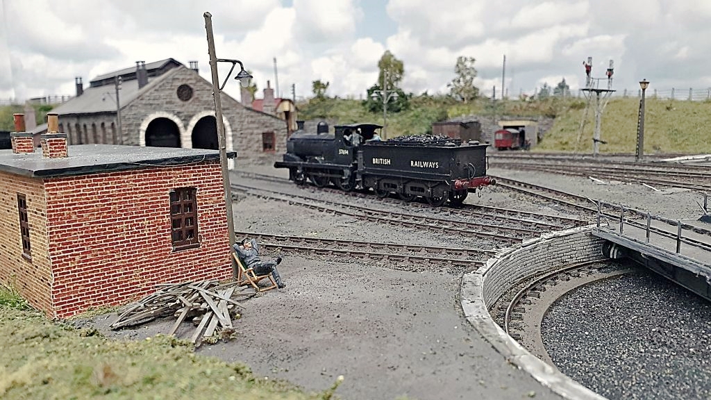

20260730_235731.jpg 20260730_003529.jpg 20260730_002749.jpg Couple of the finished turntable and coaling stage here.

As always amazing photos!
