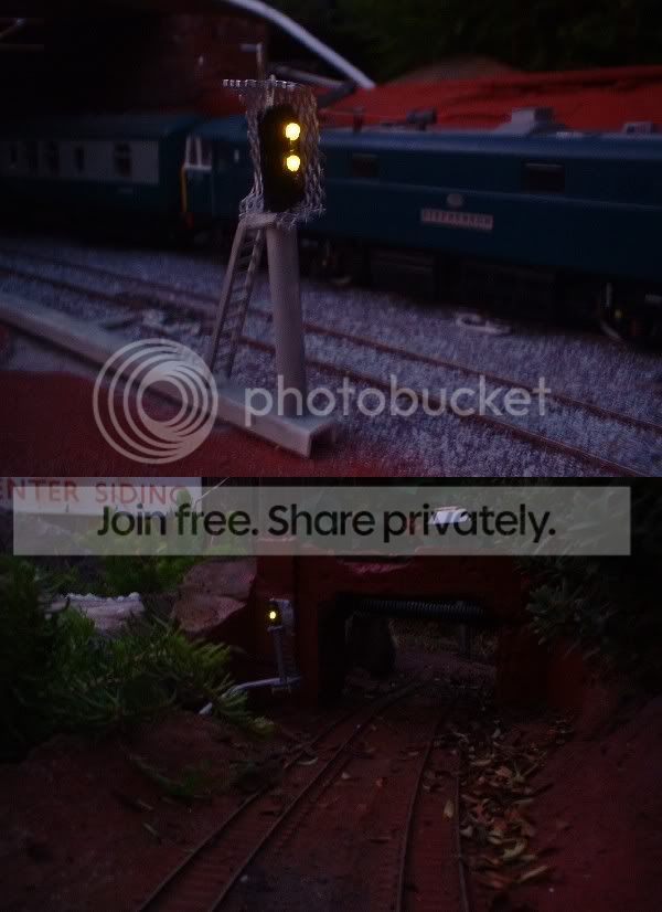

Thanks Michael dont think about it too long though. It's taken me two years to get this far! Tonight I decided to temporaly wire in the signals at Byerley Parkway station………
The red on the left is for the branch to Cobblers Hall. This line will be bi directional so should be fun wiring that one up! The green on the right is for the down main line. This signal is switched via the automatic station stop system that I built earler in the year. However as the system has only two outputs red/green I need to modify it to work the yellow aspect. Im going to wire it so that instead of showing red all the time it will now display yellow untill a train leaves the garage. On entering the wall section the train will trigger a latch that will change the yellow to red. The train will then approch the red signal as before at the end of the platform. The timer is then activated via a reed switch. This kills the track power for a pre set time. After about thirty seconds the timer changes the signal to green whilst also switching the power back on. The train then departs and resets the timer system that puts the signal back to red. I will be fitting another signal further down the line so I can use the reed switch for that signal to also reset the latch changing the red back to yellow. Sounds ok in theory just have to fit the extra switches and see if it works!

#27912
rjr
I like the signal Dave, Are the LEDs waterproofed in any way or are they good enough as is ?

Thanks guys and hi Steve (already left a message in the welcome section;-)). No John the leds are just as they come as they are already sealed however the paint helps to cover the wiring anyway. The signal used was the one I built in the tutorial section that origanaly was to be used for st Davids station however since the track remodeling it became redundent. A new gantry is being planed for its replacement. Another tutorial perhaps? Talking of tutorials would it benifit anyone if I did one explaning how to automate the signals operation?

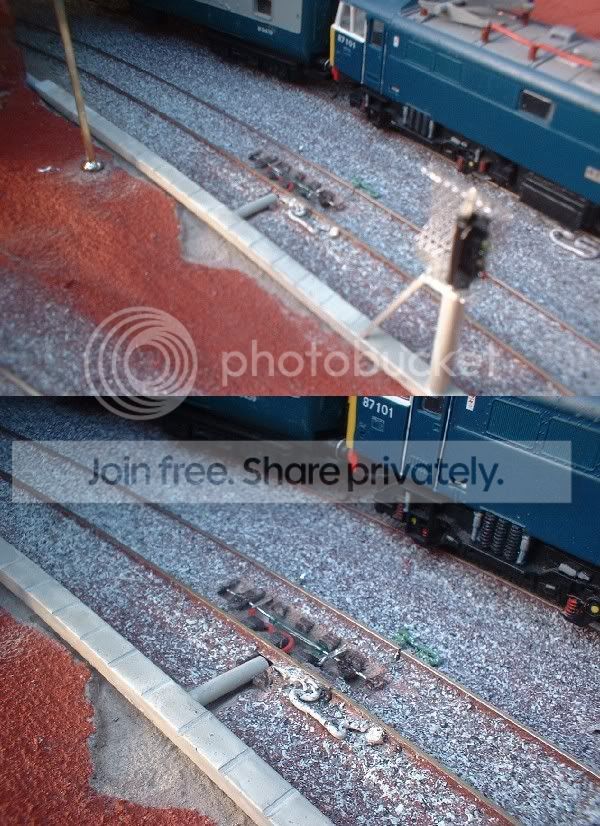

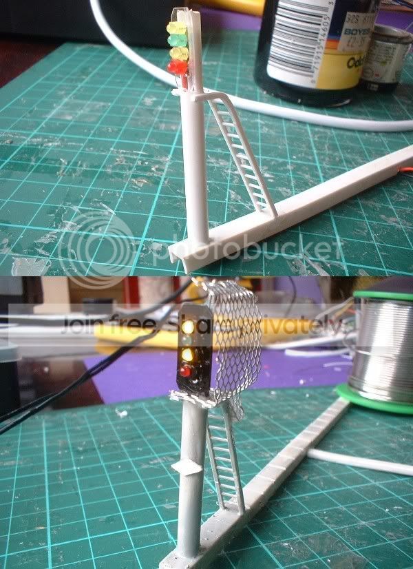

After building the signaling module I decided that it was about time I started building some more signals to go with it! Each signal is unique to the location it will eventualy be located in as there are variations in heights, bases, etc. For example here's one I made yesterday……
This signal is for installation at the end of the viaduct just before the short cut and cover tunnel. The track bed at this location is about a foot deep of solid concrete so a way had to be found of concealing the cables. The solution was to mount the signal on some U section the route the cables underneath then hide them under the tunnel. The wires for the reed switch were brought out through a short piece of pipe.

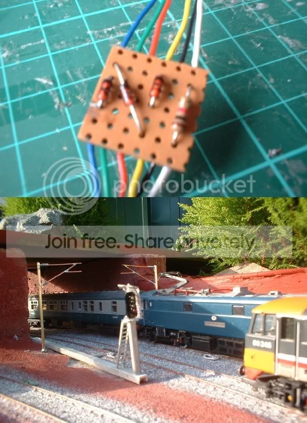

The diodes and resistor for the signal were mounted on a small piece of strip board that fits into the junction box……
Part of the track base was chipped away to allow the signal assembly to be located…….
This is actually the third reed switch that I mounted as I broke the other two. As you can see I cut away a space between the sleepers for the switch to fit in. It is held in place by melting the legs into the plastic sleepers at each end. Once sealed with some araldite the switch will be hidden under a AWS ramp. Also today I ran the cables up from the control box to the signals…….
The next job now that they are working is to fix in place with some araldite provided that I manage to pick some up tomorrow! The signals operation has been tested using a coach fitted with a magnet and looks quite realistic changing to red as the coach passes the signal. Tomorrow I'm hoping to finish off the signal gantry that I started tonight. Just one final thought. I quite fancy having a go at building an automatic level crossing for the back of the layout. The only real problem would be getting the barriers to move outdoors. Anyone had any experience at building one of these on there indoor layouts?
