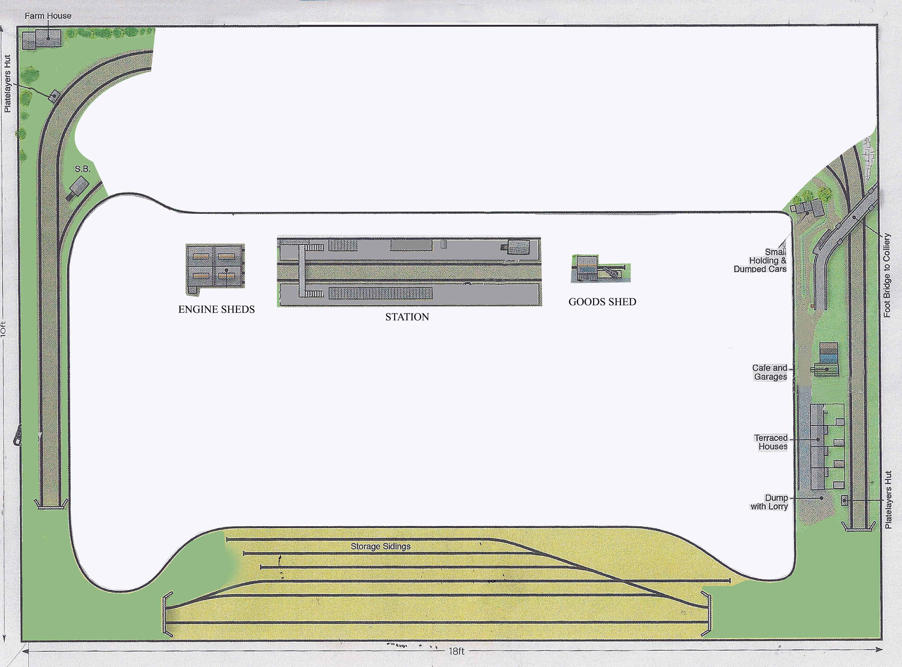

Yeah, but not so easy coming up with a good track plan 😳
This is what I would be left with.

That's a nice space Phil - one I'd give my back teeth to have at my disposal just now………………..
Glancing at it (without too much thought), keeping it all nicely square against the back wall is a little too symetrical for my liking.  Initial idea - bring the curved mains on the left down to tight behind the signal box and have the station running diagonally, front left to centre rear.  The engine shed could go either top left, slightly behind the station (roughly where the mains are now) and the goods shed somewhere in the empty lower right triangle created by the station and smallholding area thus being handy to serve the village area (terraced houses).  The remaining "empty" space (where the mine was) could either become the start of a village/small town or open grazing land, contoured to hide the mains at the right hand side whilst leading naturally into the smallholding area.  The "cutting" at back right created by the contours is an ideal area to place that wonderful bridge that used to sit between the station and mine area - a shame if that's not used.  Having a couple of rows of little terraced houses, end-on,  climbing up steep cobbled roads leading off the road serving the existing terraced houses and cafe/garage up towards the railway cutting would make a superb scene after you've waved your magic on it.  You could even send the mains underground roughly where the colliery footbridge is to allow slightly longer rows of houses.
Alternatively, if the bridge really is surplus, my address is ……………………..:mutley:mutley
Sorry - not much good at playing with arrows and super-impositions so you'll have to try and guess what I'm talking about …………:cheers2_2:

Hi Phil, how about taking out the station and any other bits you want to save, leave the Colliery in place, possibly even the engine shed etc, and adapt  the remaining track to form some storage sidings, shunting yard scenario. This would then allow you to do something with the original storage sidings area to move the station to the front? And create some new scenes down there. Yeah ' too much work' I supose but, but it's Pen Y Bryn ! You gotta do something !
" Save Pen Y Bryn! Save Pen Y Bryn !    :happy10:
Any thoughts yet ?
