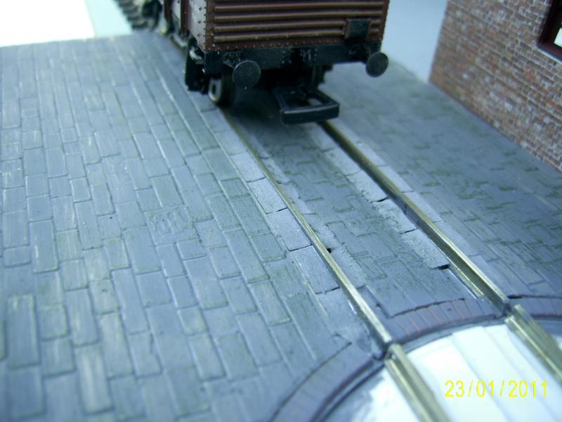

It also shows the coupling hook being raised, before the wagon is turned. This is done by moving a magnet under the turntable, which would happen once the loco has pushed the wagon into place.
Stu

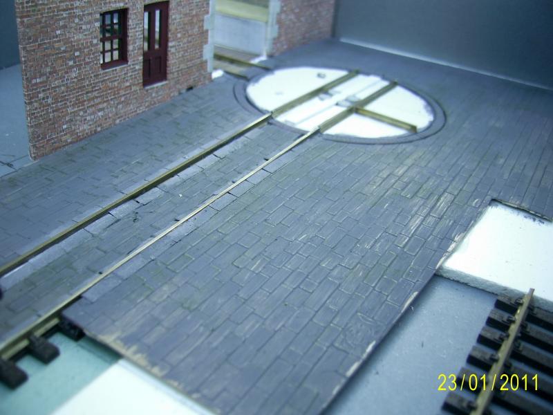

The next job will be to finish the ground works around the table, so I can add the track. I've found that I can use the Ratio / Wills window arches as a circle of edging stones. The table will have scribed styrene as a wood effect - not sure yet whether to add the other tracks at 90 deg - did tables always have crossed tracks on them ?
Of course, progress depend on what other domestic duties are conjured up for me…
Stu

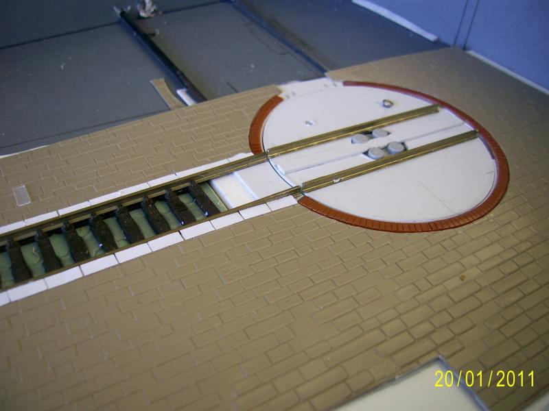

The white edge stones are simple card punches.

I'm not sure whether to use coffee stirrers as the wood base - they work out at a scale 1'3" wide, which I think is too wide. Another option is to use embossed plasticard, but this is to thin and will need packing up first.
Stubby47's Bespoke Model Buildings
All photos I post are ©Stu Hilton, but are free for use by anyone.
You could always scribe a line down the middle making each one two planks.I'm not sure whether to use coffee stirrers as the wood base - they work out at a scale 1'3" wide, which I think is too wide.
Thanks Ian.

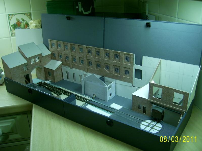

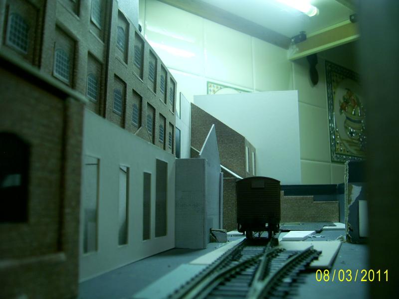

Box 2 is now coming along nicely. I've added the main building for the wagons off the turntable to be processed, with the rudiments of the roof and second floor added as well. This bit, of course, will be removeable.
I've also managed to source a suitable rod for the point control - the original wire in tube was fine for the older dead-frog point, but failed to move the new live frog variety, so something had to change.
Apologies for the odd background in these photos…
