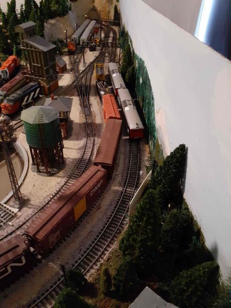

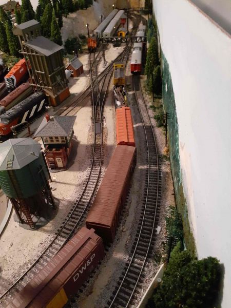

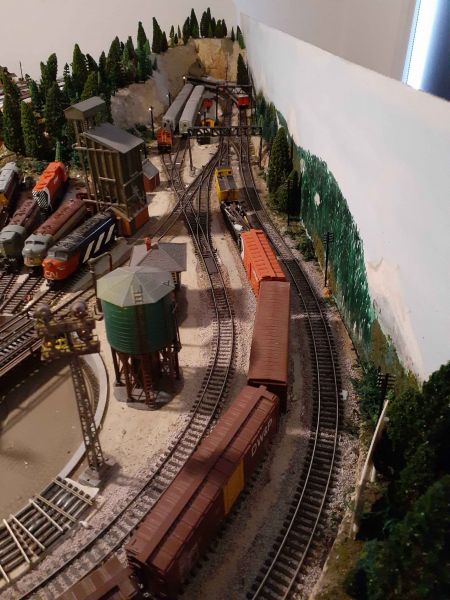

Just following through on the pictures, here is a Budd RDC pair at the back of the layout in several positions to illustrate what I was talking about…
The gentle curve back provides a bit of visual interest and certainly gives the impression of a bigger layout if only in pictures. I took a number of pics of the layout in its early days minus the backdrop in place now and many people I showed them to were increduluous when I told them the size.
As I said earlier I would have with the benefit of hindsight put an outswinging 200 plus inch redius at the front rather than the straight section!  On a smaller layout as you are planning where the eye can take in the whole layout, it may look exaggerated so I would suggest reducing the curvature a little but keep one just the same!
Hope this helps someone if not yourself as an idea!
Trevor
PS,  Near the roof of the cabin which you can see in the last pic (the greyish "triangle")  I had a figurine of a guy lazing as though sitting on the grass, watching trains… that would often be my eye view as well or close to it!
