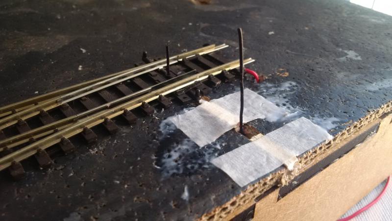

The first stage of the 'tube in groove' point control method. Basically the florist's wire is a very snug fit in the tube (from a very cheap plastic spray bottle) and a groove is cut into the cork/cardboard base. It then moves as a whole supported either side with braces, very quick and it works for me.You'll notice I'm not taking the rods to the edge as I know I will damage them as my board is constantly on the move, so I'm connecting the operating end to various movable features on the board to disguise them …or so I hope …

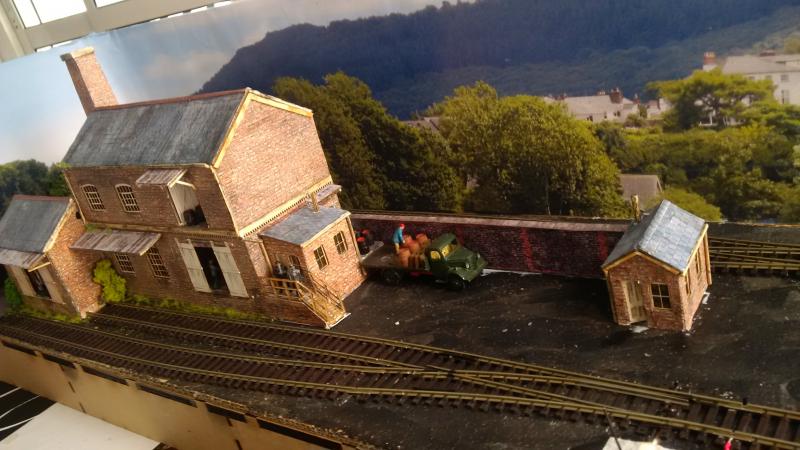

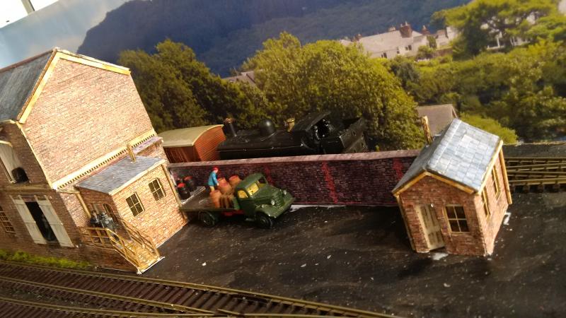

The gatehouse is now complete (a relic from the building's days as a tobacco warehouse). Yard surface and lamps to complete as well as scenics and lots of barrels … oh yes and the driver's days as a redhead are numbered … its Saturday so its vino tinto later, have a good weekend all (since posting the images I've moved the manager's office drain pipe towards the steps away from the truck … before toto spots it)
