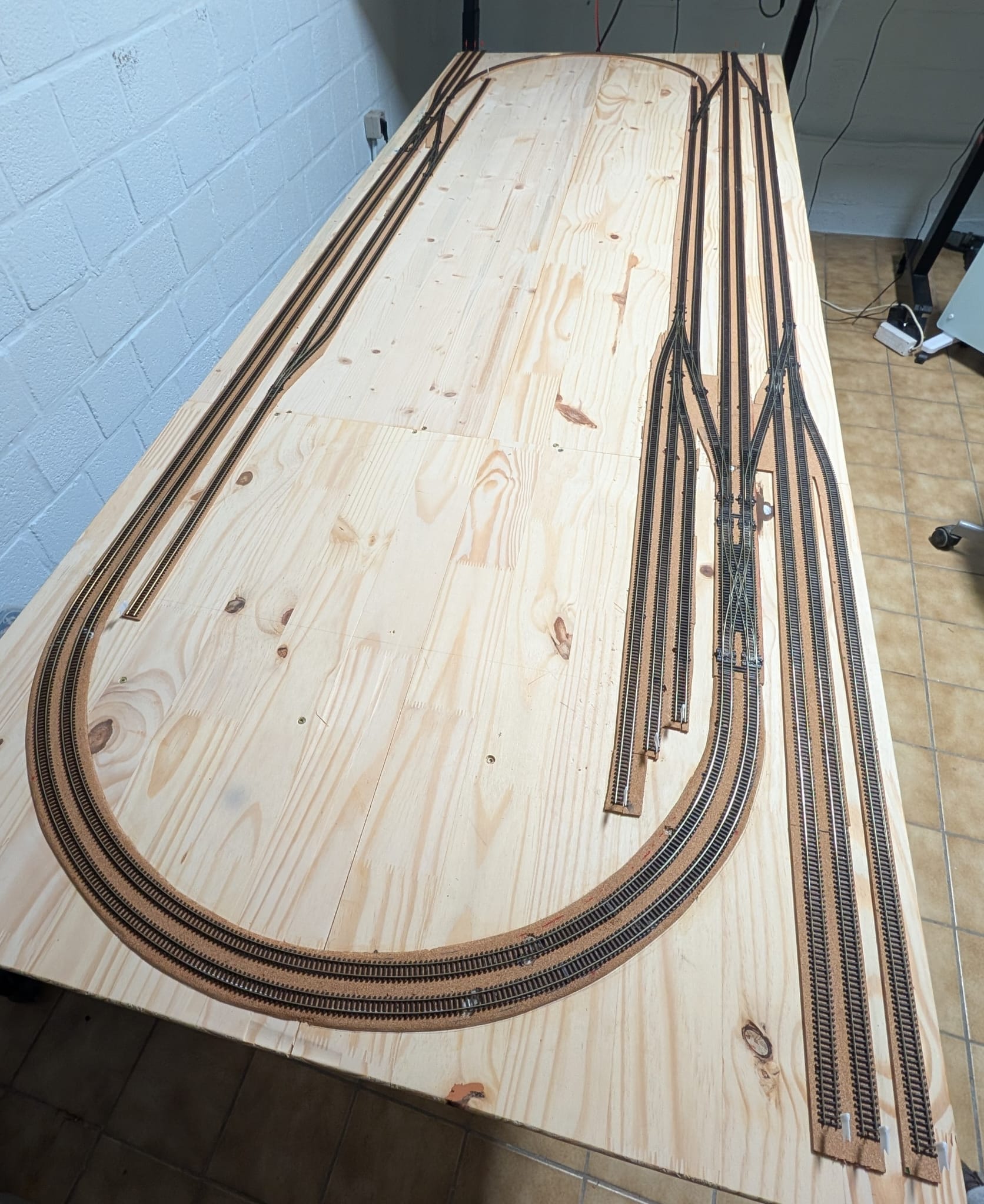

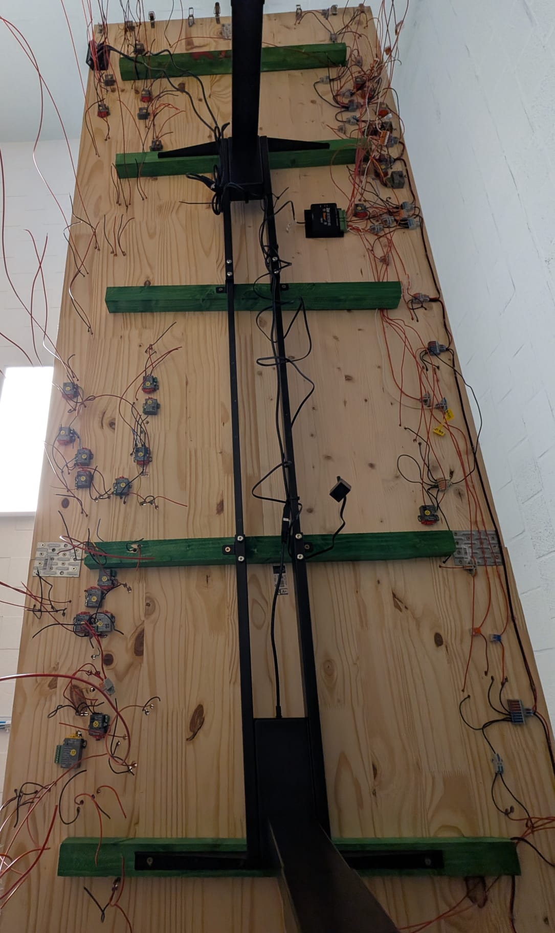

Hi Claus,
Laying of tracks on the first module is completed. Now I'm working on the turnout drives and electric connections.
Last edit: by Mario PL
Item has a rating of 5 (Liked by Mario PL)
#293077
No wonder you haven't had the time to post. The underside looks amazing. Fantastic job, Mario!

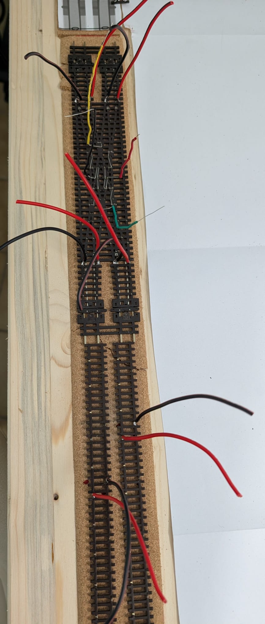

If wiring is your question, I found explanation on this page very useful:
How to wire a Peco SL-E383F Electrofrog scissors crossing for DCC - Hookstone Models
There is one difference though - for the scissor crossing I use 3xDP1 by MTB and one DP4 which distributes the voltage to the green and yellow frogs. This is in DCC; I am not sure how this wiring works in analogue control. Anyway DP drivers by MTB are designed for DCC. Drivers MP are more suitable for analogue.
Best Regards
Mario

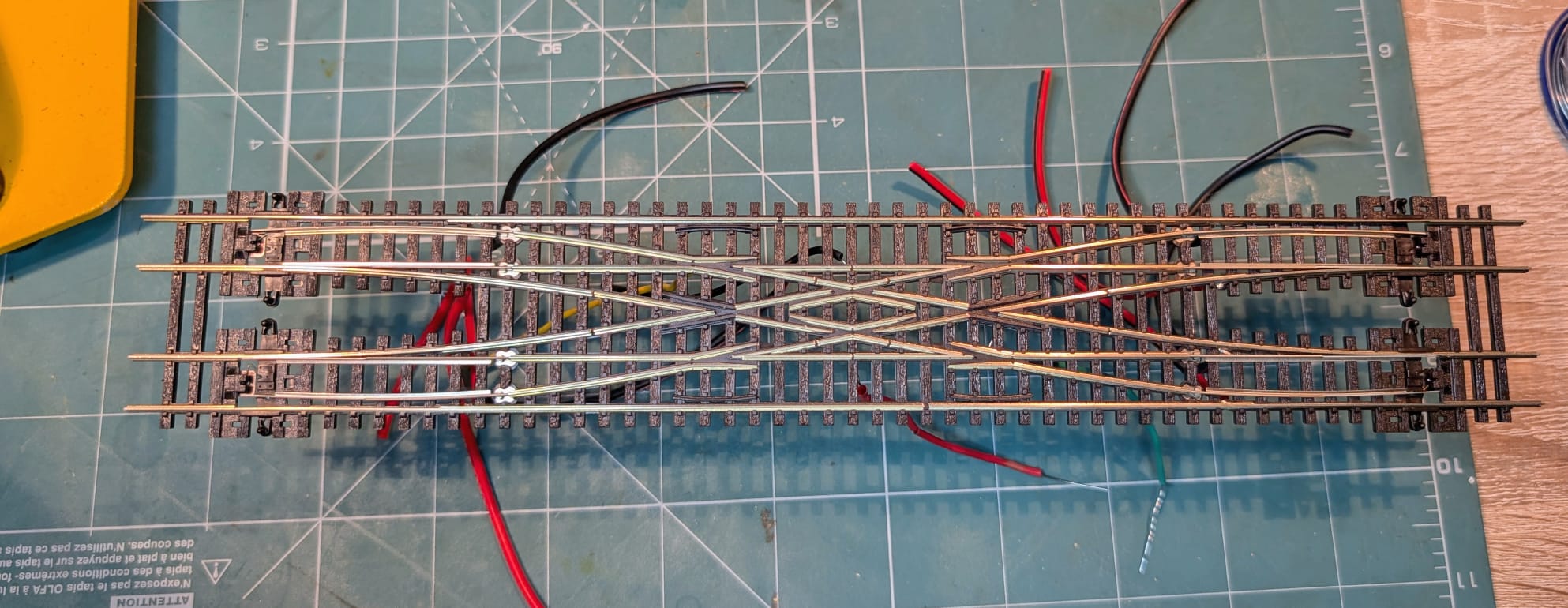

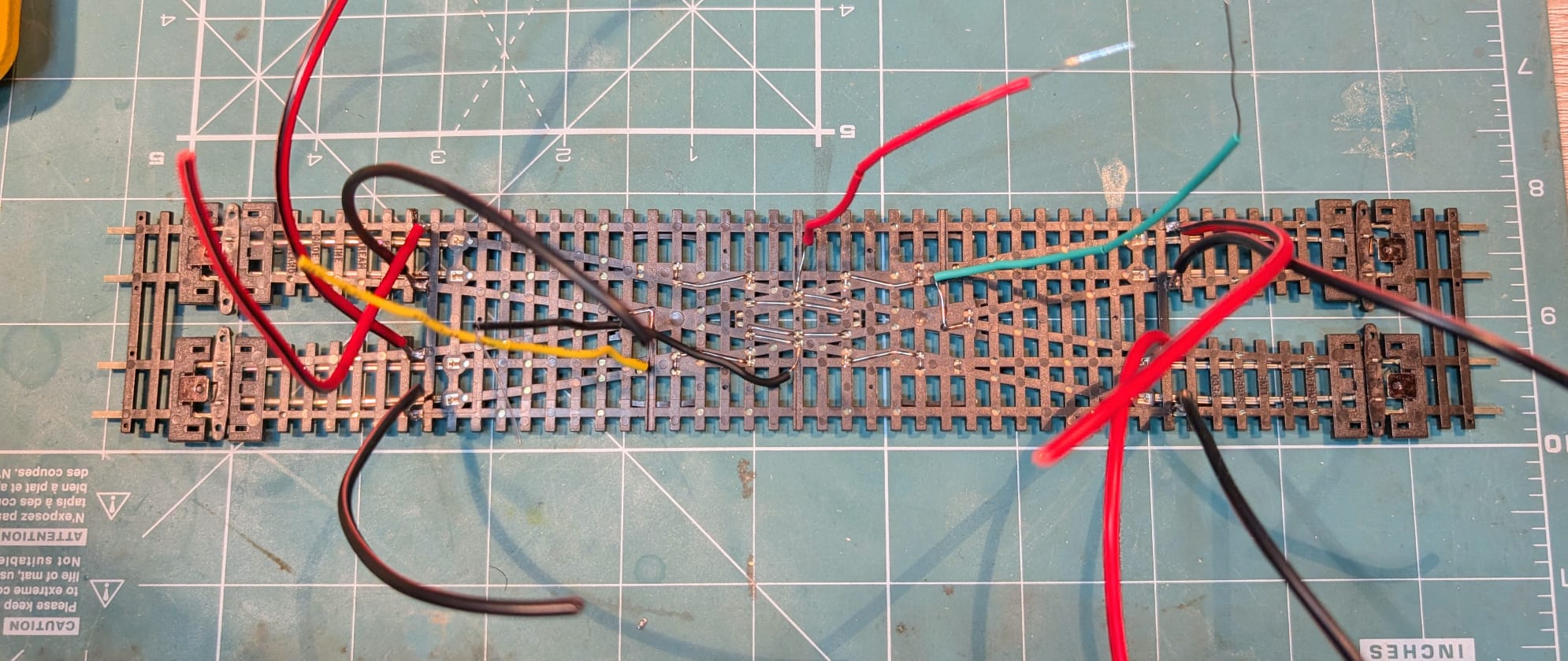

Actually, the wiring is not too complicated if you use coloured wires. Black and red are normal power supply wires while yellow and green are frogs’ power supply through DP4. I attach pictures of how I did it.
wiring Peco scissor crossing 1.jpeg wiring Peco scissor crossing 2.jpeg wiring Peco scissor crossing 3.jpeg

Clever design - just 2 frogs for the whole set-up.
Somehow, it's hard to get your (my) head around what it in fact, 4 points but with just 2 frog wires.  I'm guessing you'll use 4 motors so does each frog wire go to just one motor - i.e. one of the pairs of motors ?

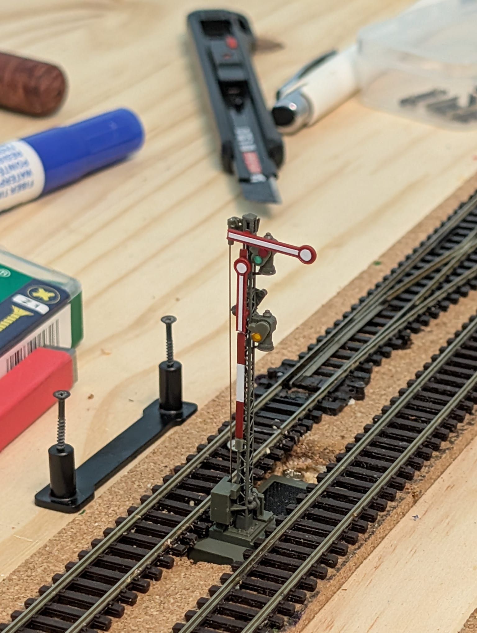

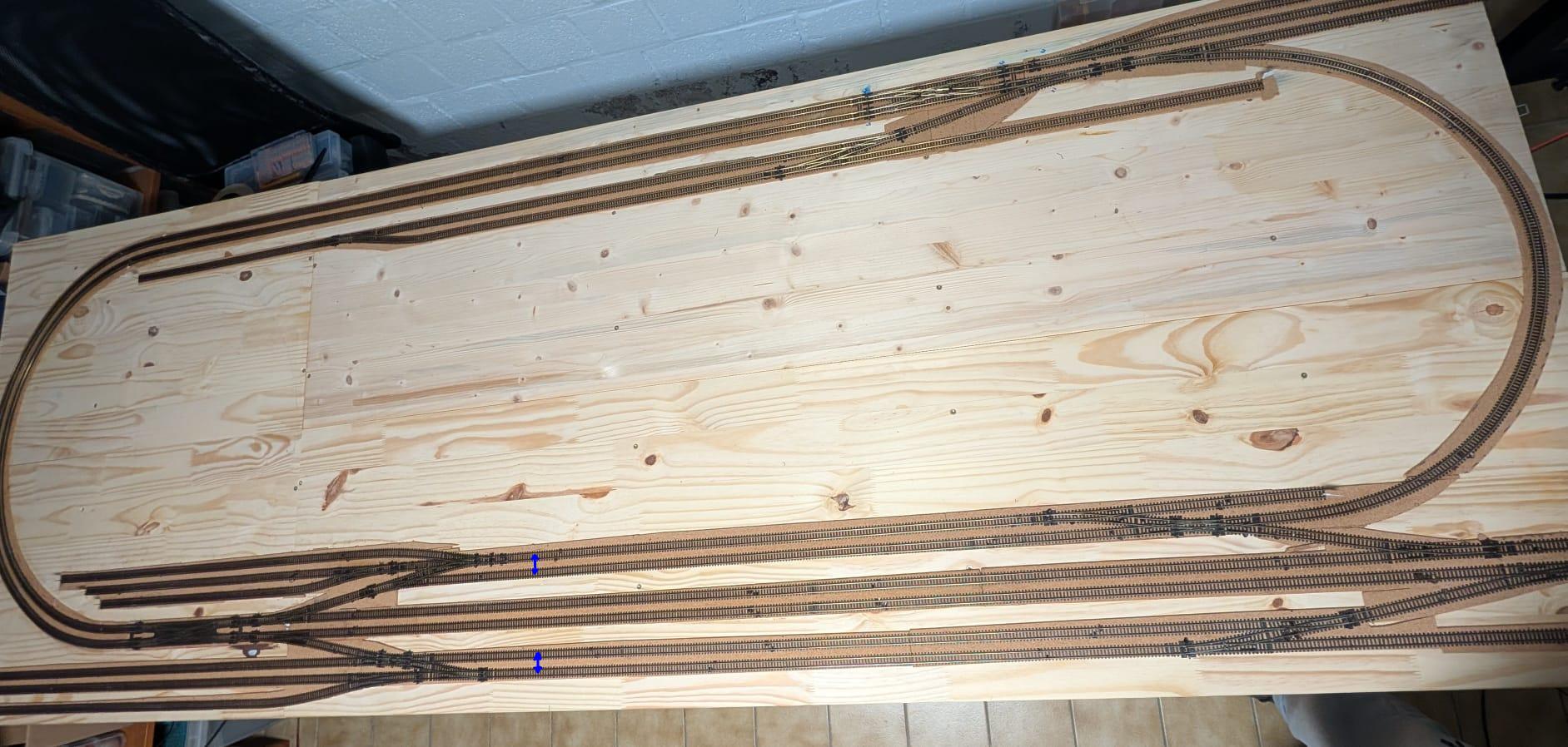

Small report: the wiring is finished, trains run smoothly and runs are well coordinated with iTrain. But I run into a problem of too little space between side rails which makes installation of shape semaphores imposible. The space between rails is 27mm and I used track spacing gauges but apprarently this is a few milimeters too little for Viessmann 4471 because trains can not pass them. I think 3-4 milimeters more would be OK.

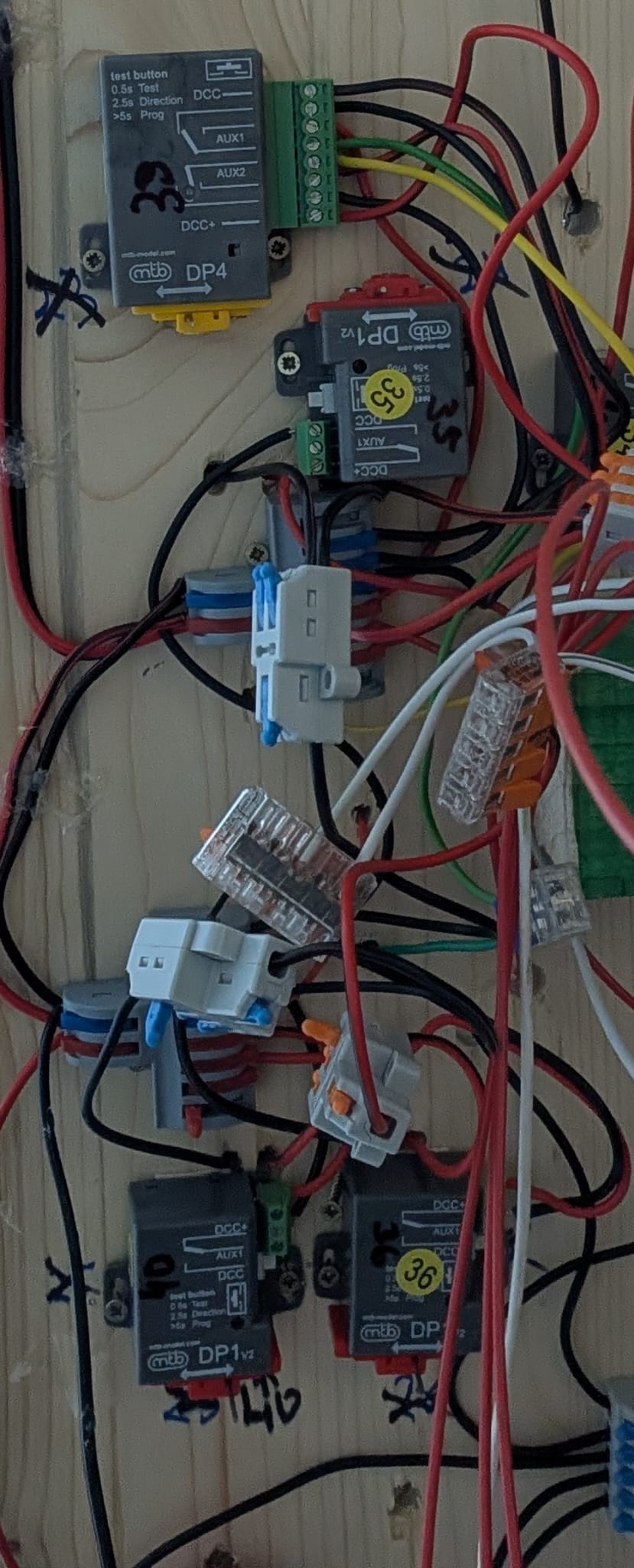

Here is how the double crossover peco is motorised. One DP4 and three units of DP1.
