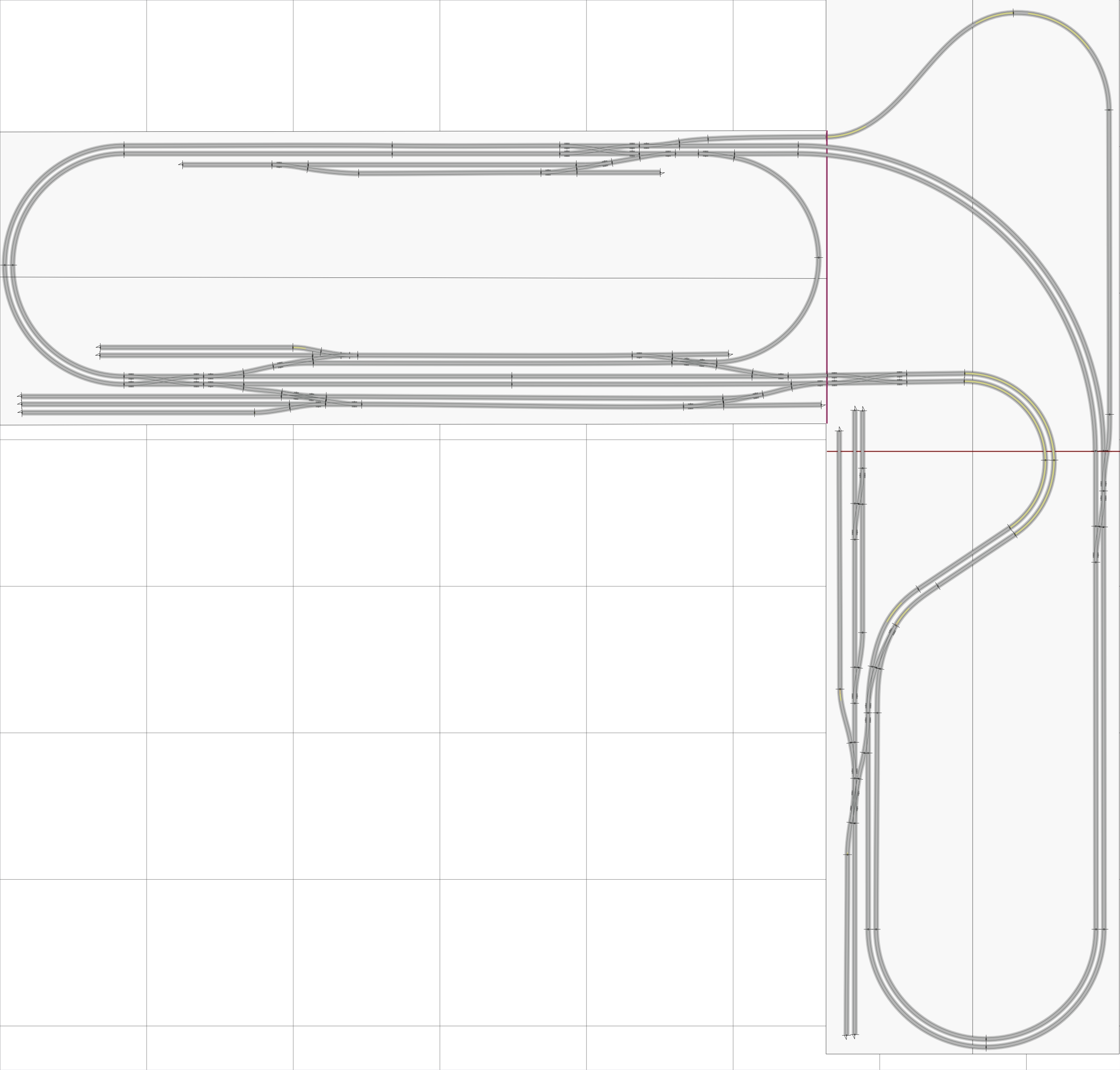

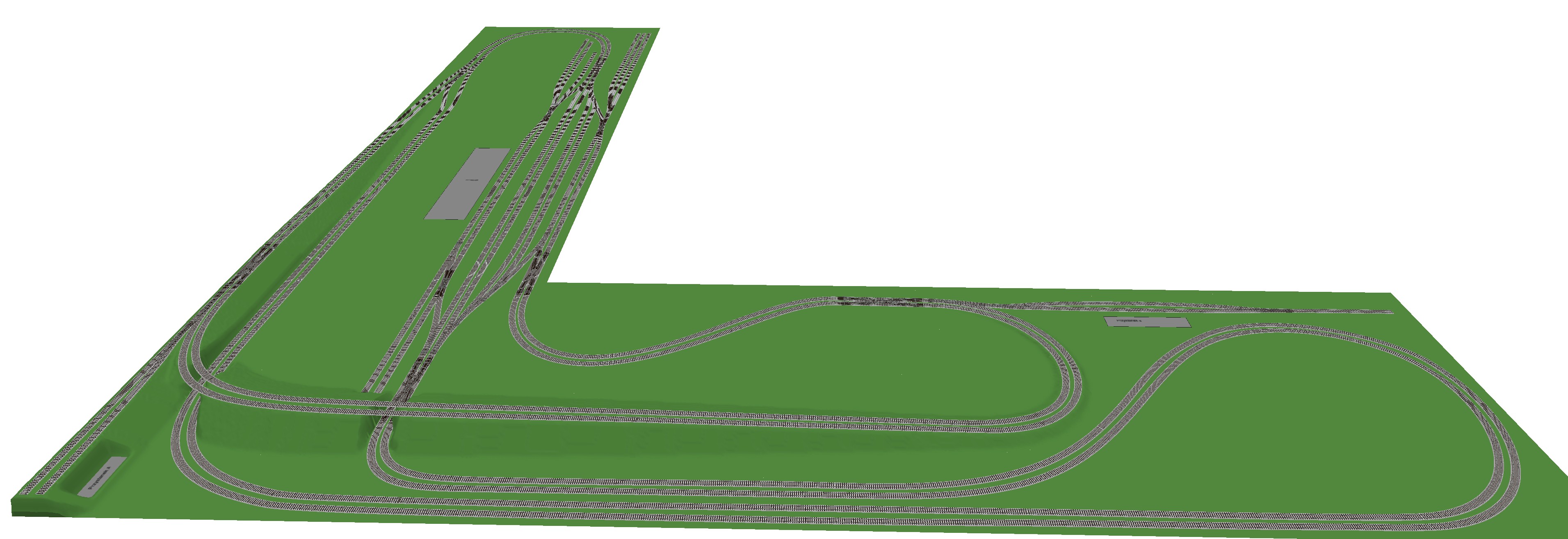

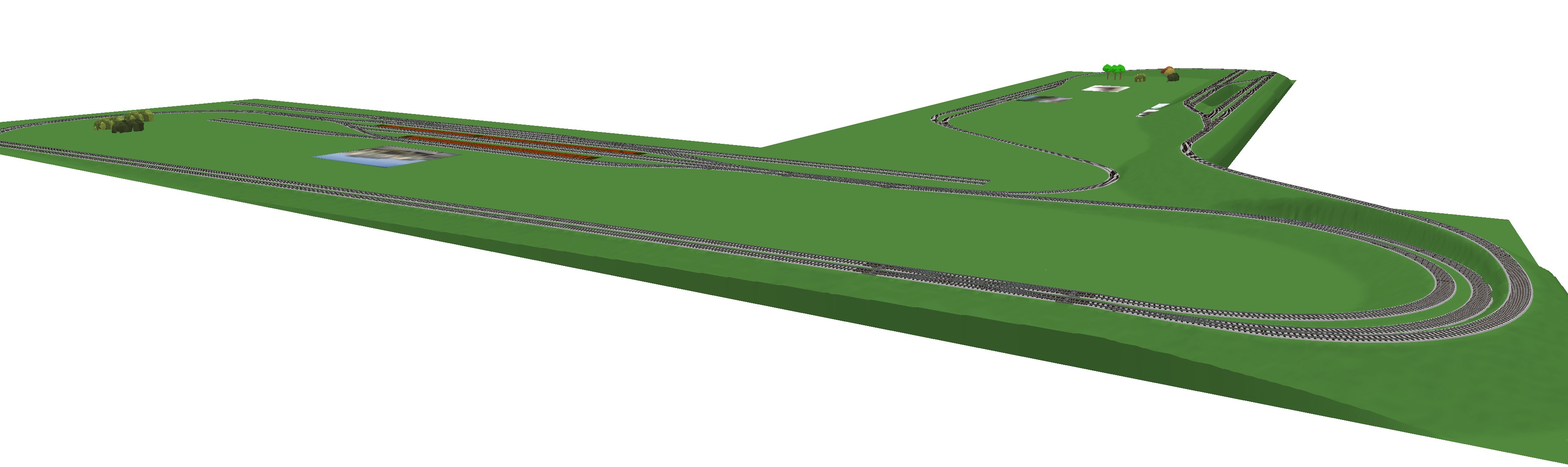

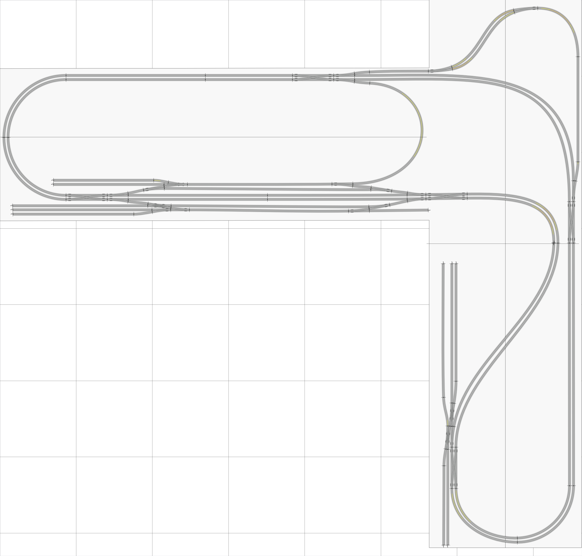

To enjoy running trains on a multivariant schedules in layout which looks as real as possible

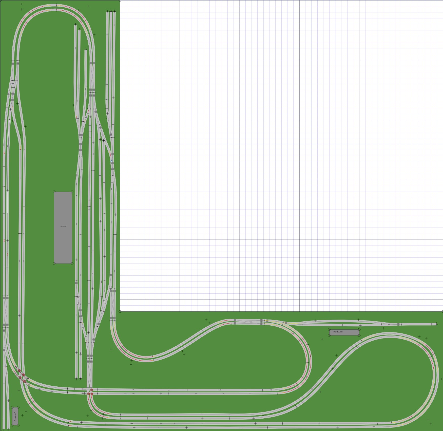

I decided to make a N scale layout for which I have an L -shaped area with a width of 1 meter and a length of 3.7m and 3.6m measuring on the long sides. Below I attach the first versions of the plan of tracks and stations/stops with a request to honorable colleagues for favorable (which of course does not exclude criticism) reviewing this plan and commenting. As I said in the description, my objective is to enjoy running trains on a multivariant schedules in layout which looks as real as possible. Comcode conformance error (A tag, media_set, was not closed) at line 1

Welcome, Mario:welcome:
The layout will certainly give you a lot of scope for running trains. It looks good, but I am not an N-scale expert. I will let more experience modellers do the comments.

 :hismiley: Mario and Welcome.
Sorry for my late reply but I've been on holiday.
You seem to have a lot of track  in the plan, are these mainly passenger trains or freight? UK outline or something else?
Certainly looks to be interesting running.

That’s an impresssive track plan! I don’t have experience either with N or something that big.
One thought though, can you reach that siding in the corner of the L?
#292519
Good point, Darius. What or who is the siding serving?

Access to the most distant points is an issue indeed. I work to solve it. I use Z21, AnyRail for planing, iTrain for running.

My first thought was those curves are tight on a 1 metre wide board but then realised you are modelling in "N" Gauge.
Is this UK "N" Gauge or continental (I see you're planning Deutsche Bahn livery so presumably continental N) - rather stupidly, there is a difference !?
It looks very complex but the computer will handle it !!  I have minimal experience with AnyRail but absolutely none with any of the computer running systems …………………

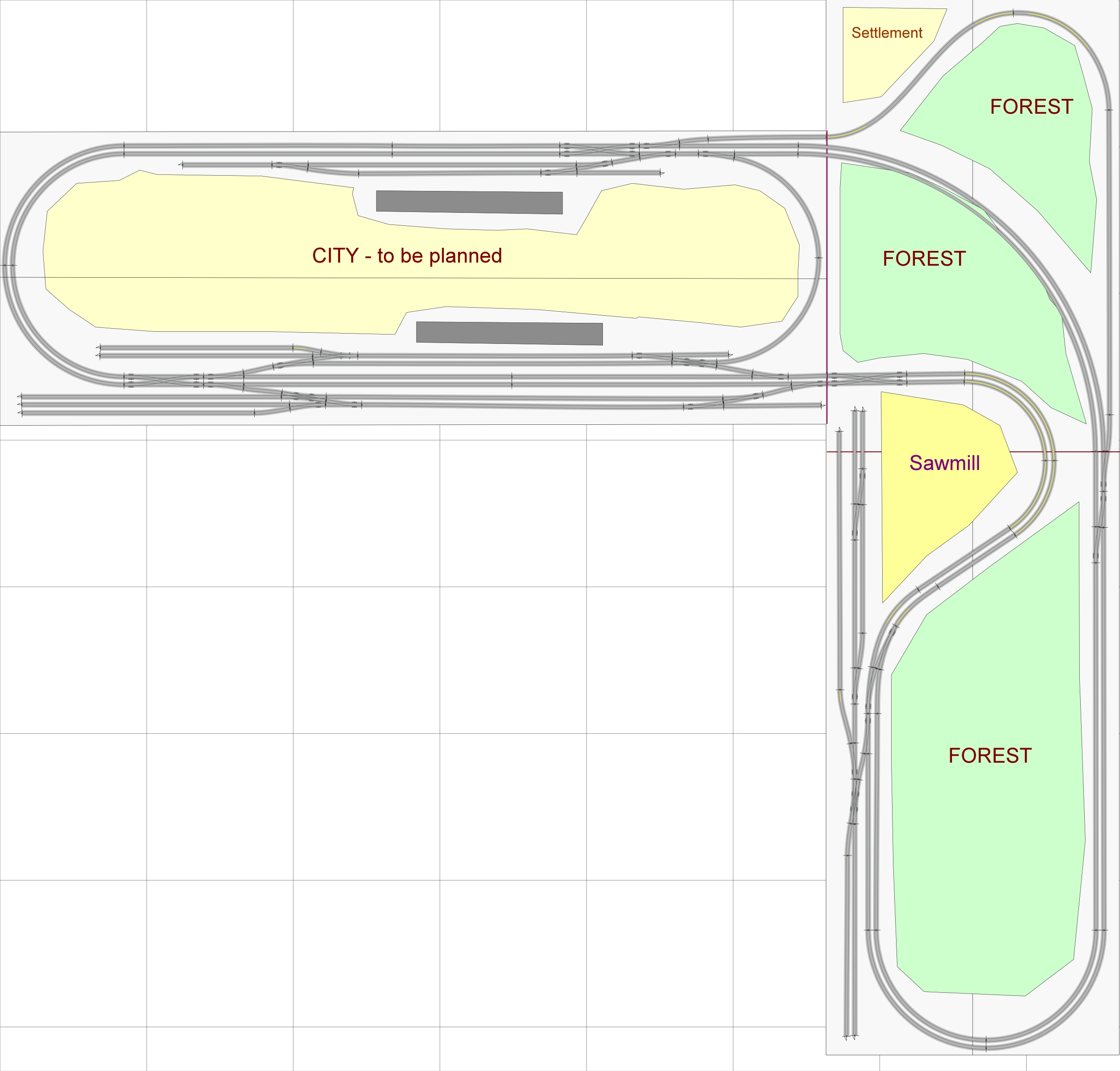

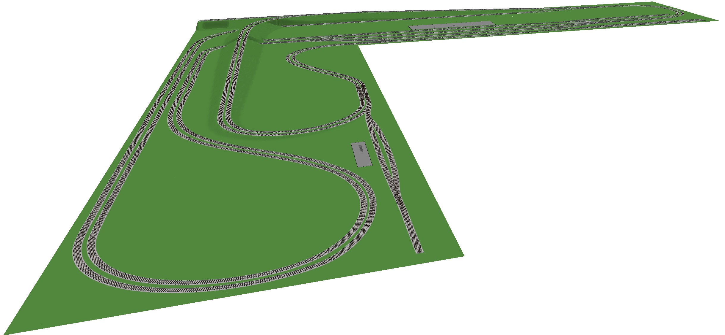

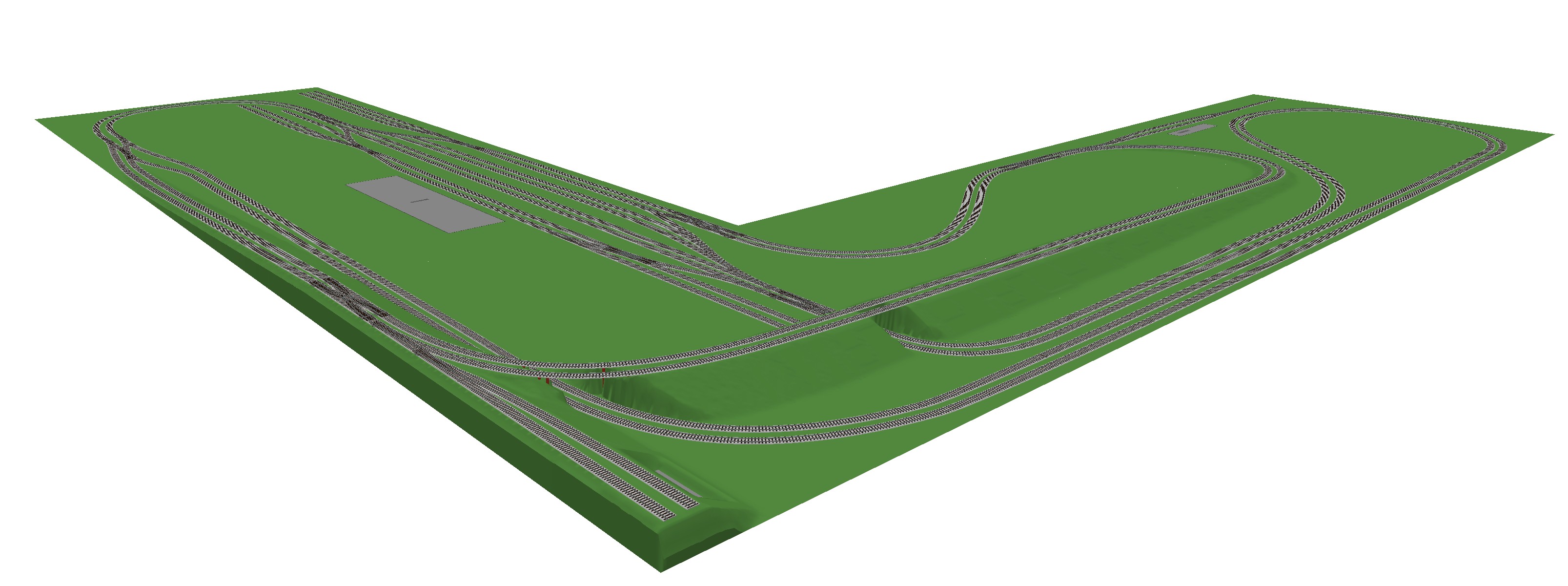

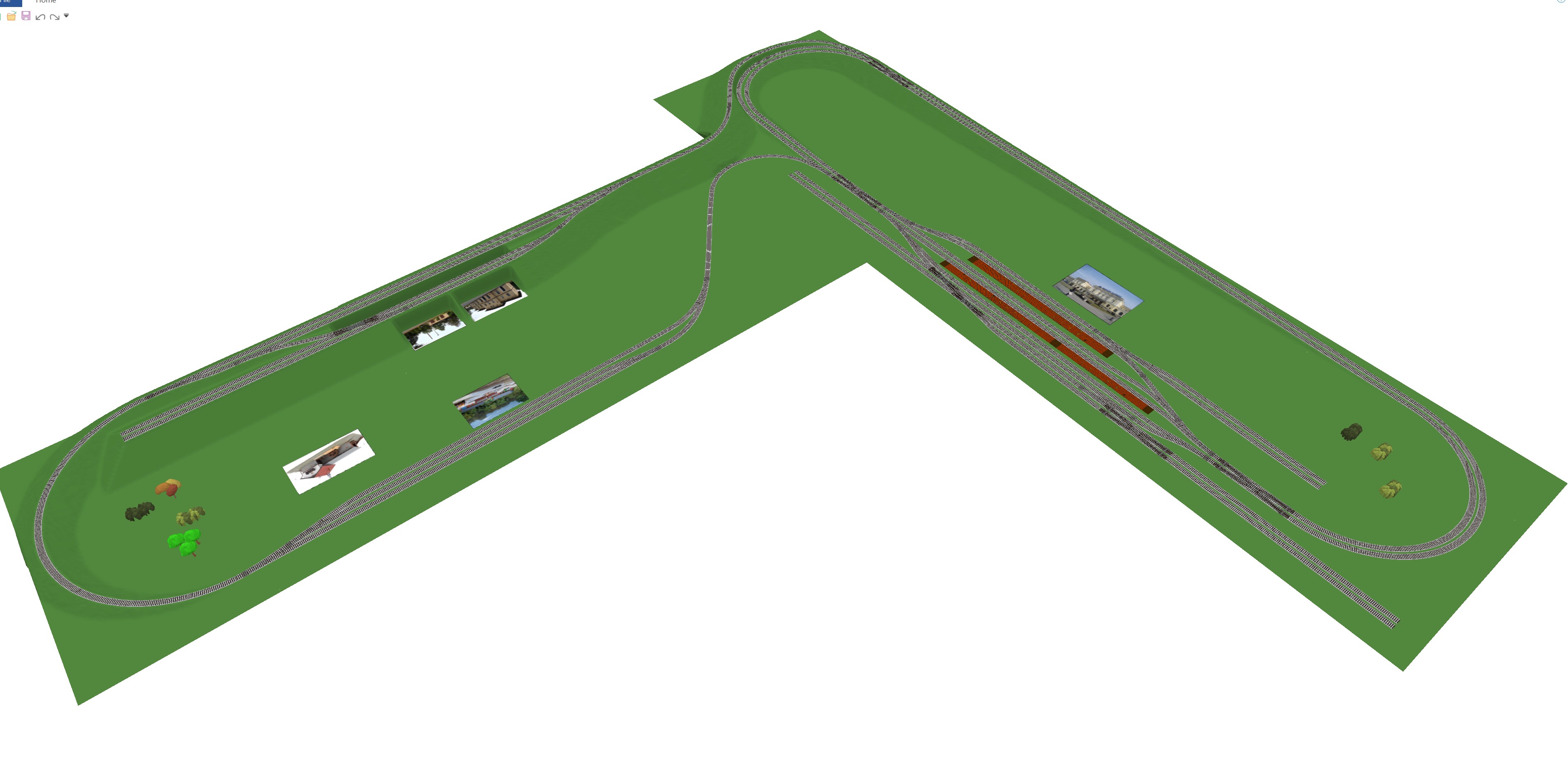

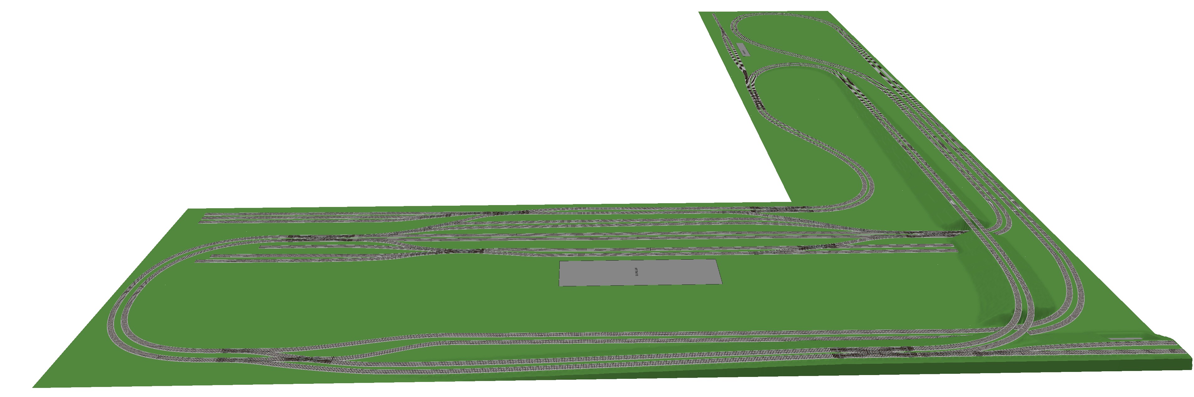

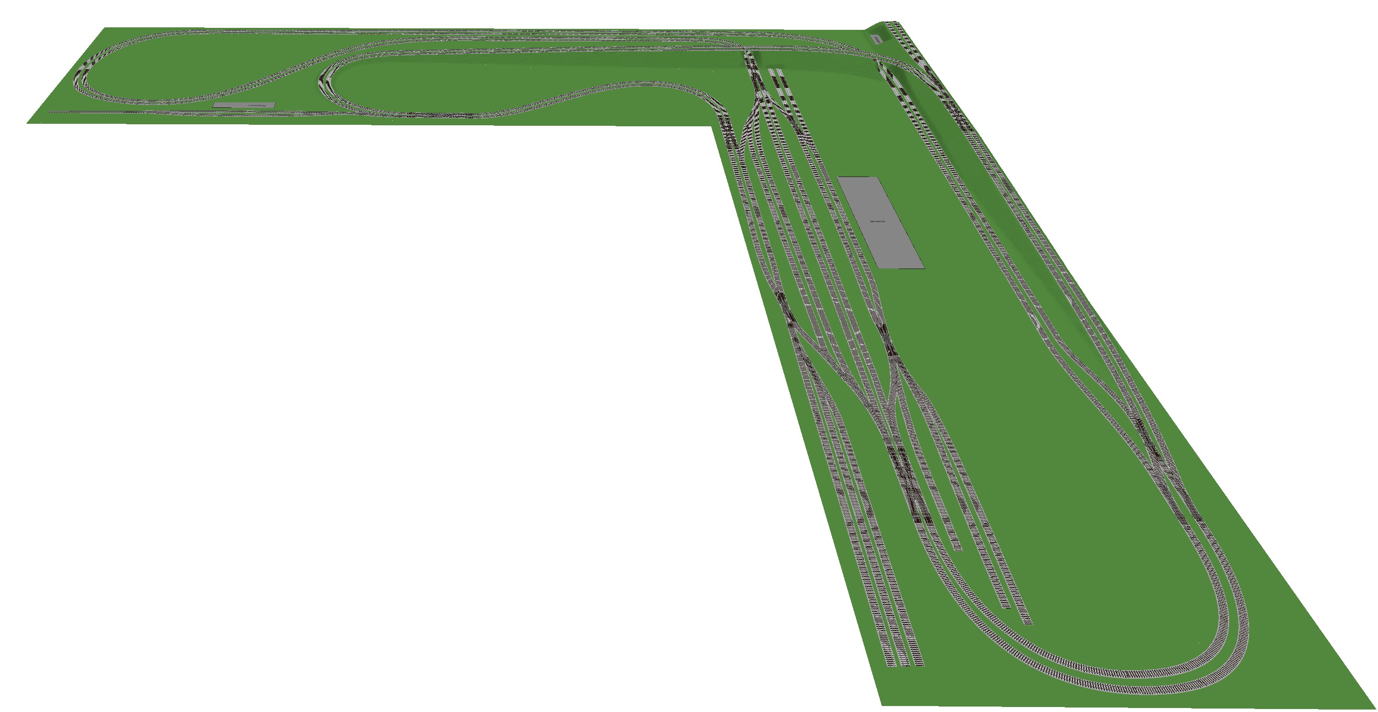

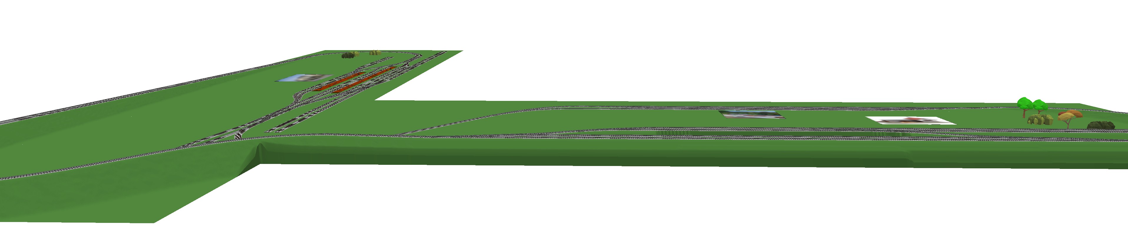

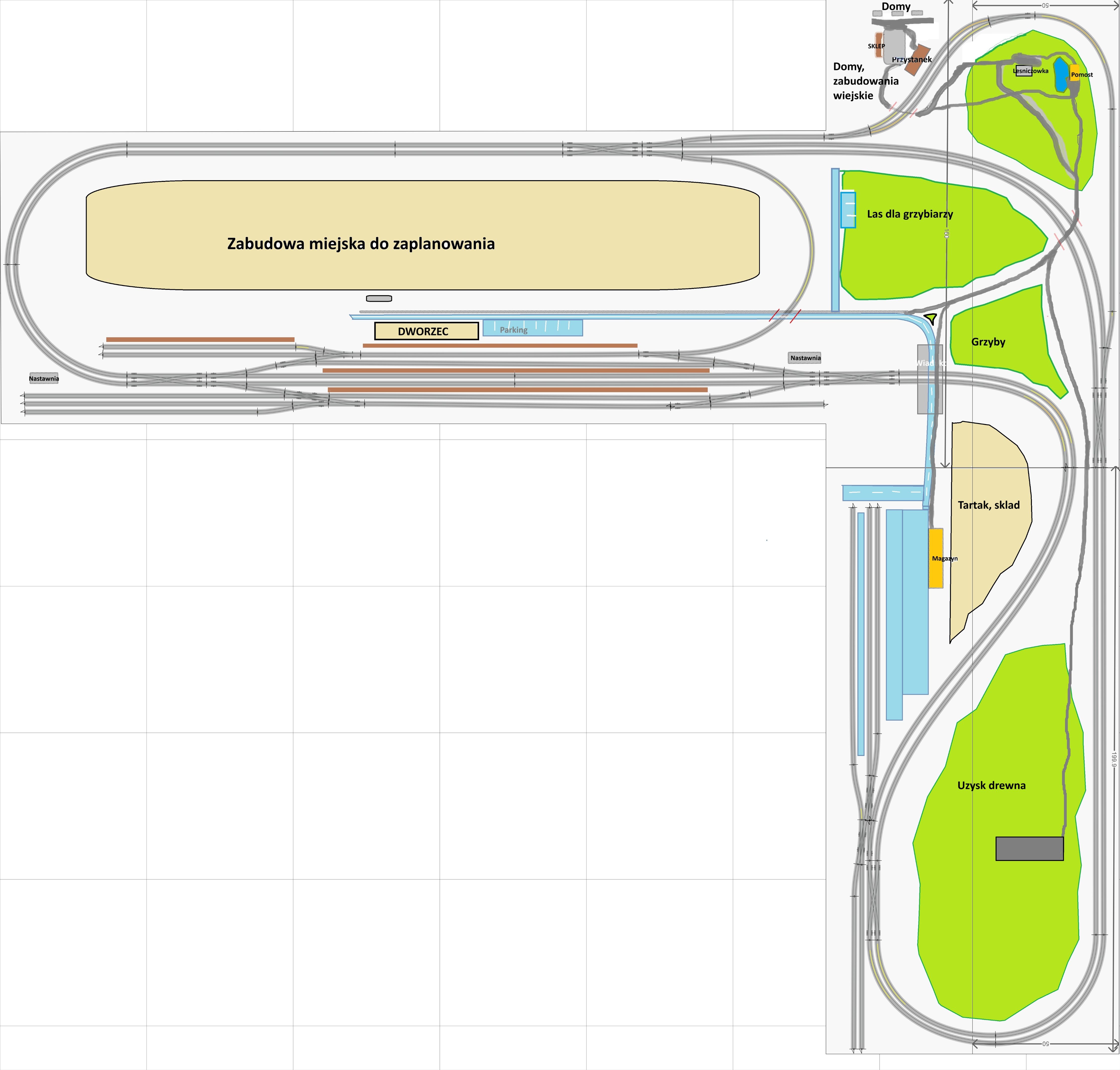

After some reflection I have decided to change the planes. I have simplified the plans and change shape to have better access to all places in the layout.  This is how it looks now:

Are there enough sidings to store locomotives, carriages and wagons?

Hi Clauss,

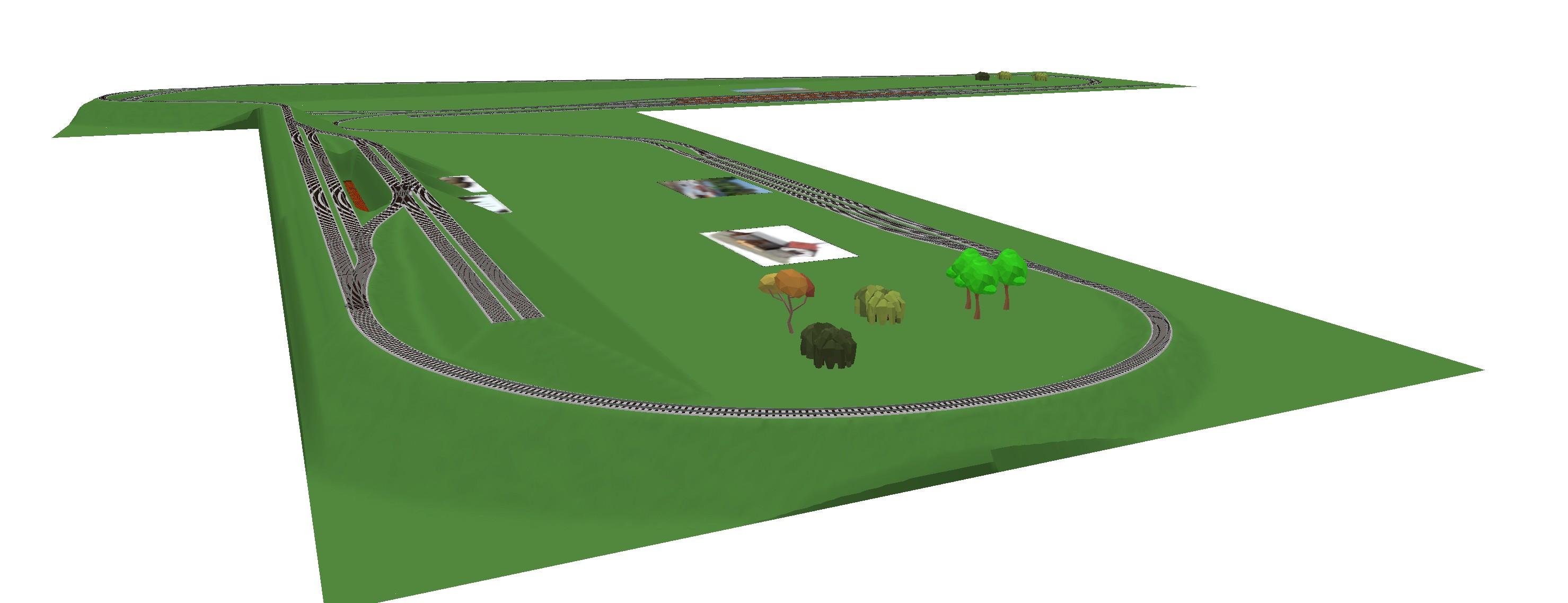

Thank you for your interest. You are one of the few :thumbsup1:. The concept is evolving. Please see the attached plannes and am I sorry that the text is in Polish but you can easly figure out that above the station is citi area to be planned, the green are forsts, and yellow are timber and storage. In the top right corner you can see a train small stop  to serve a lumberjack habitat and a forester's lodge. When comes to sidings, I have too many wagons, caariages and locos to accomodate them all on the layout, so I had to relax this objective.
There are still some issues to be solved such as, for example, holding tracks for a sawmill and a wood warehouse but I slowly begin constuction of the layout.
I would appreciate your comments as I want to get max pleasure from making and using this layout.
Take care!
Mario

Hi Mario,
The layout looks great with a lot of different routes for the trains to take. I am sure you are on the right track 😉

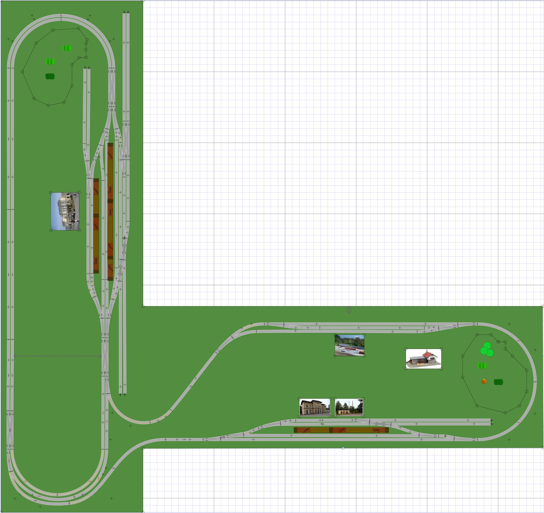

I think it's time for an update 😉
#292887
Hi Claus,
I have just finished planning and fine-tuning and here you are - the final (I hope) version of the layout.
Best Regards,
Mario
