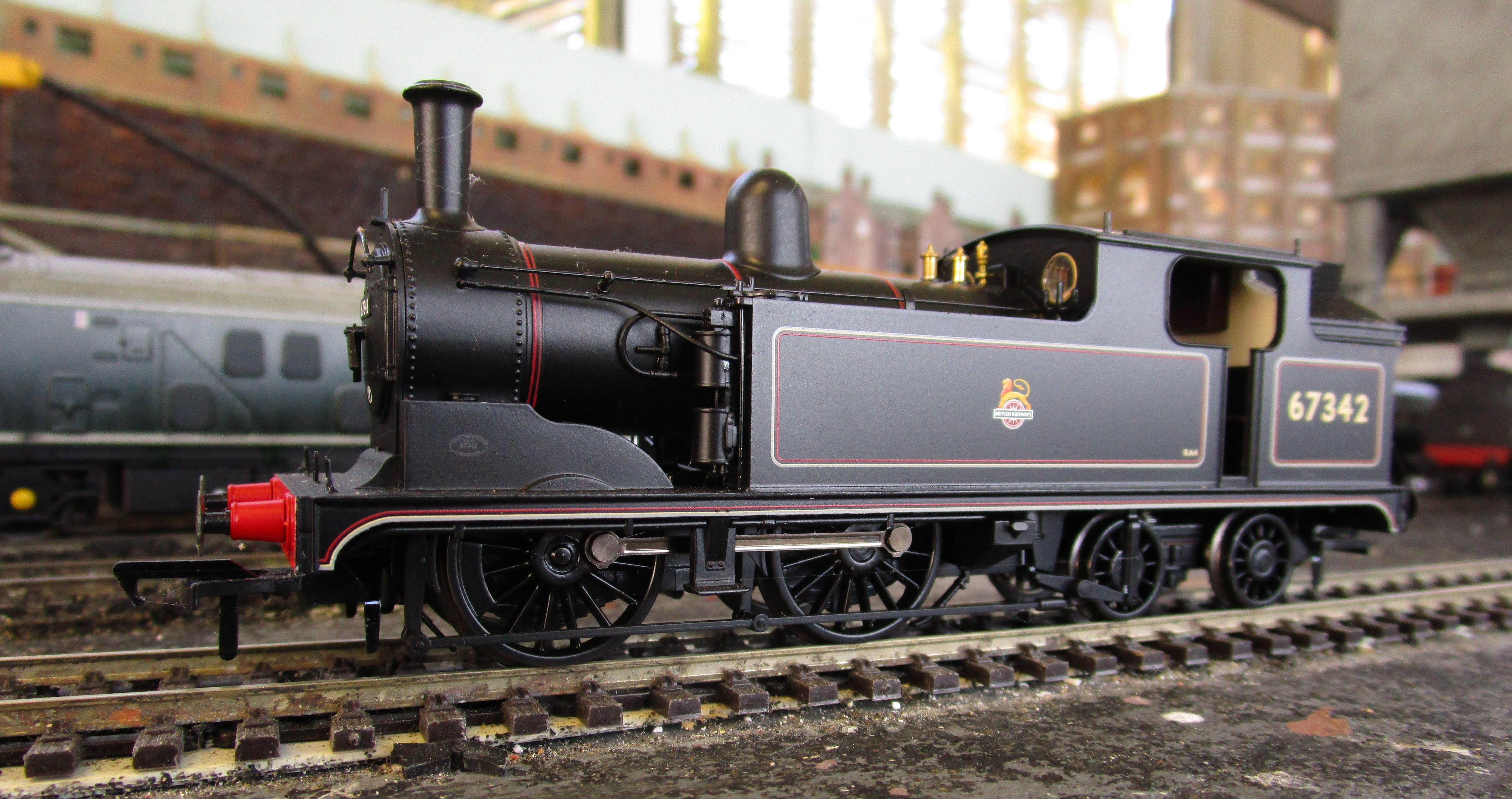

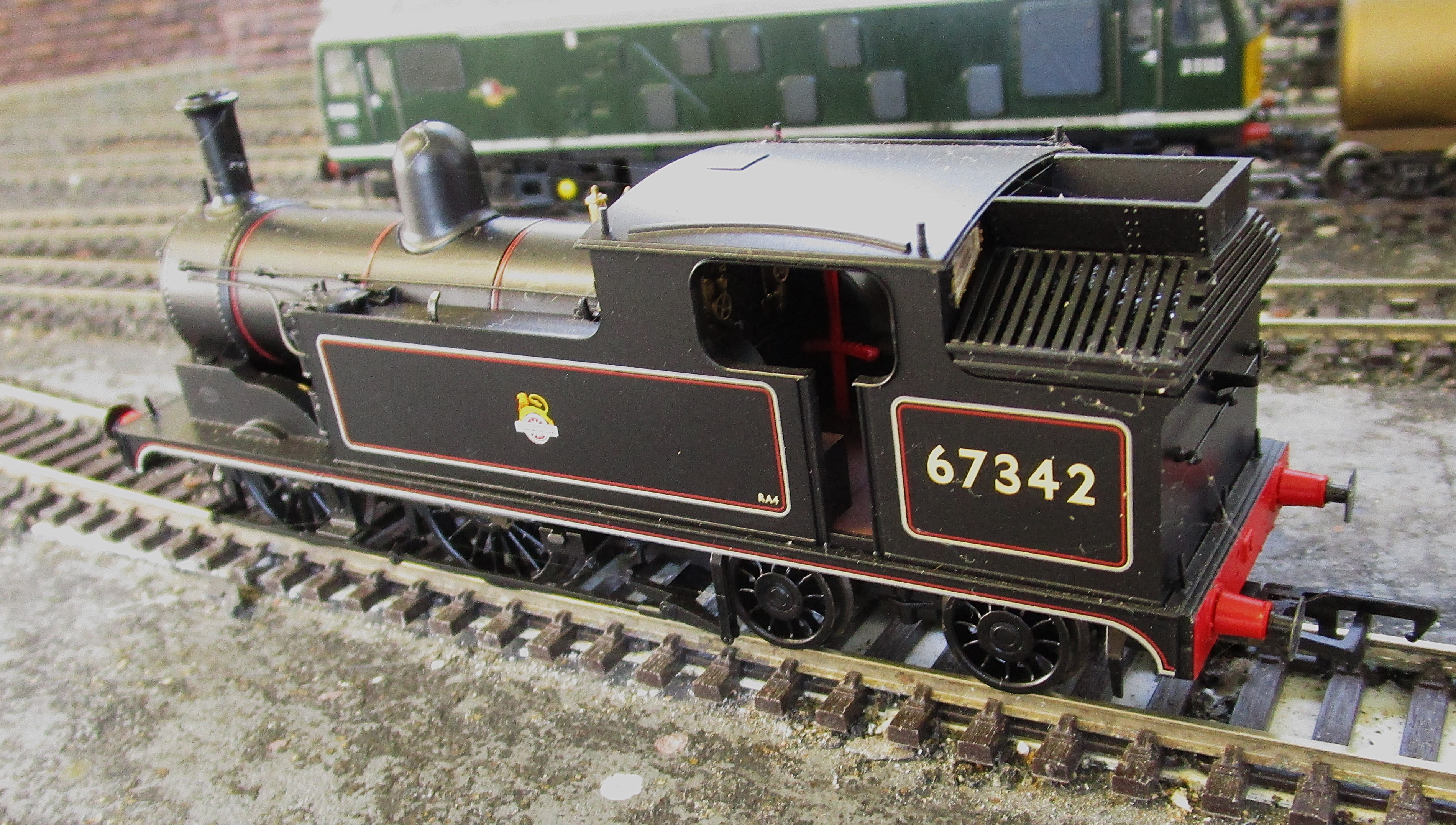

IMG_1930.JPG IMG_1920.JPG Sorry Barry - got delayed by "garden chores" yesterday - we had gale force winds over the weekend followed by very heavy rain so my handler wouldn't let me go to the train shed until she was satisfied with my clearing of debris !!
Whilst the G5 is a lovely little loco, I think I'd baulk at paying £150 for it (plus almost as much again to fit sound !).  Railway modelling has reverted to being a rich man's hobby after several years where mere mortals could dabble.  For that reason, I buy very little nowadays. Hopefully "Rachel from accounts" will increase my pension sufficiently to enable me to buy a pack of rail joiners this year ……………………..
Having one tight curve on my layout, I didn't fit the steps but I'll have a bash and see if she'll go round with them fitted.  Here's some (very poor) photos of her - sorry - hand held 'point-and-shoot'  £20 camera but it does at least show the accumulated dust and cobwebs on the thing !!  :puppyeyes::whistle:

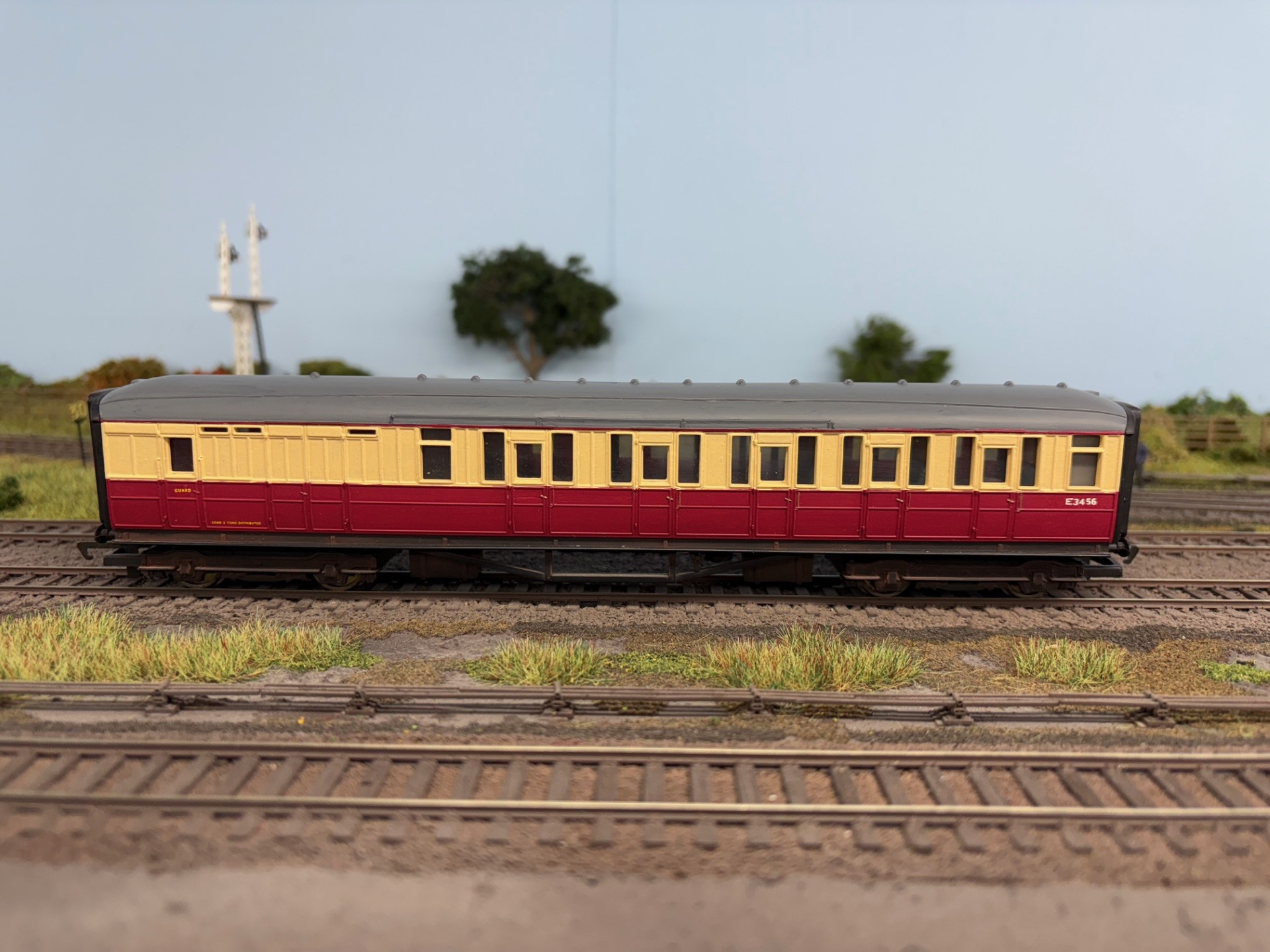

At the other end of the expenditure scale, I had an old Hornby Gresley Brake composite from the Breakdown Set (N2 hauled crane and mess coach).  It was a rather natty shade of pink/red plastic so a repaint using Humbrol Railcolour into "Blood & Custard" was required.  Decals from HMRS.  This is brush painted and cost £nil.  The inside is fully painted too and it will gain some passengers in due course.
And good fun too!!

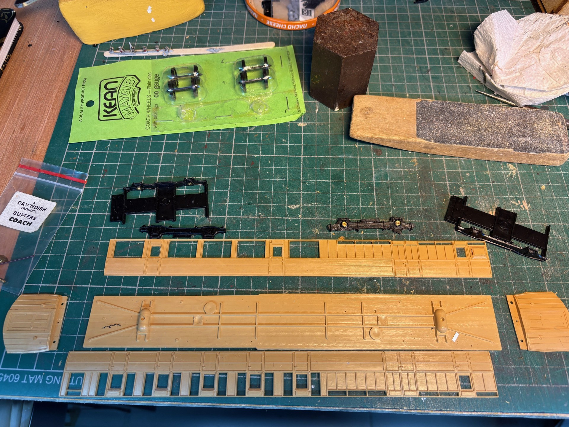

I know that eBay is a bit "marmite" but I'm a fan and a known source was selling this Ian Kirk Gresley Brake 3rd kit for £25 which I considered a true bargain.
A bit of research suggests that this is a Diagram 37A 61ft 6in Brake 3rd built after 1930 (later underframes).  The photo shows the kit in the early stages of construction with the Kean Maygib wheels waiting to go into brass "top hat" bearings in the frames.  I can't say I'm a fan of plastic bogies (particularly the old Ratio ones) but these have cleaned up well.  The floor is not at all straight and may need some gentle heat to get it back into shape.  The sides come in two pieces, joined where the brake section is recessed in typical LNER fashion of the period.  There is a ducket on one side only for some reason - prototypical according to photos I have found.  I get that it might be for spotting signals and station approaches but what if its running the other way around?????
The kit is carrying a fair amount of flash suggesting old moulds but after a bit of work, so far so good.  The interior is included as are Cavendish buffers but I will need to source some NEM pockets for the couplings.  I will probably go for a Blood and Custard livery again after my last effort.  A bit of a faff but the results are pleasing.  I still have plenty of HMRS Pressfix transfers for BR coaches to provide "Guard" and "Weight" decals.  Again, I will manufacture a running number from whatever I can find.
In the days of £60 for a coach, producing something for half the price and from your own kit-building skills is certainly to be commended.  For those who haven't tried it, have a go with a Parkside or Ratio or (even) Airfix open wagon.  If all else fails, you have (i) gained experience for the next one and (ii) got a wagon to park at the end of a siding being unloaded!!
Bashing on………
Barry
#291785
Cheap=DIY/bashing=more. Apply the 3-foot/1 meter rule. Nice looking kit, and KM wheels. And it's an Ian Kirk kit. Hot water and some weight to straighten the floor.

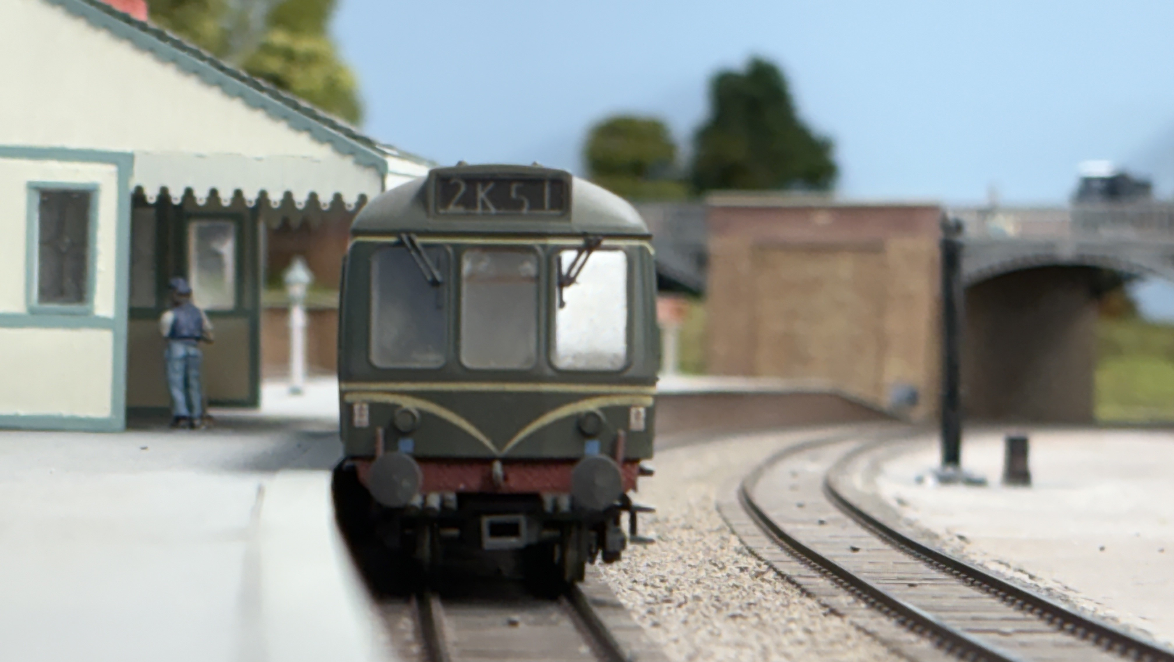

New YouTube video uploaded - the first for a long time!  I have been squirrelling away at lots of little jobs that needed doing before the magazine photoshoot and thus things like video making took a back seat.  Things have also been busy on the social front, but thats fine - it avoids me becoming a shed hobbit.

Hi Barry,
Maybe a bit agricultural but would a coat of matt varnish do any good? I like that DMU.
#292119
I too like that DMU - did you weather it Barry ?
#292123
Hi Guys
I will try a matt over the gloss to see what happens.
The DMU is "out of the box" about 5 years ago so that's a "natural" weathered look  :mutley

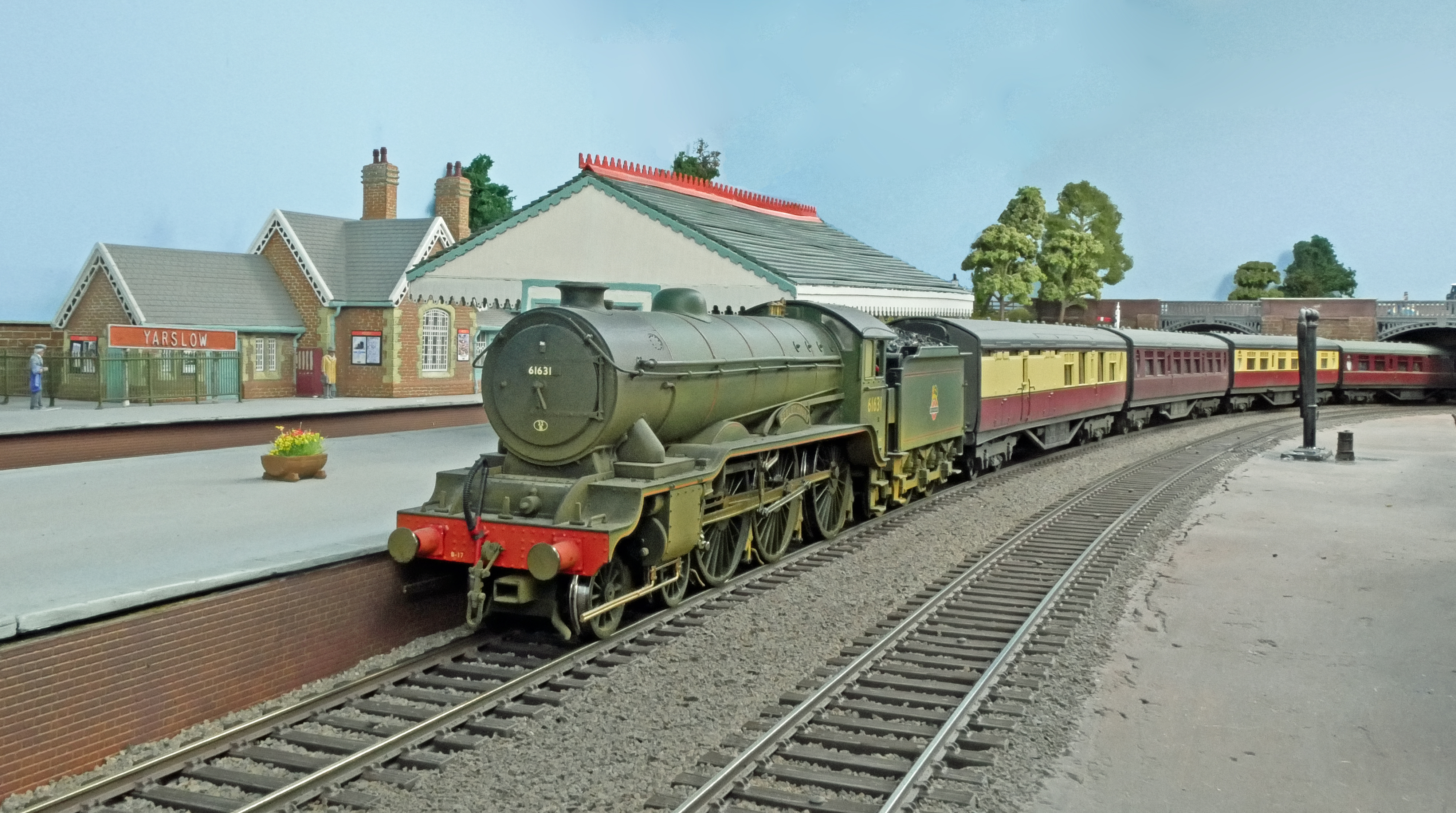

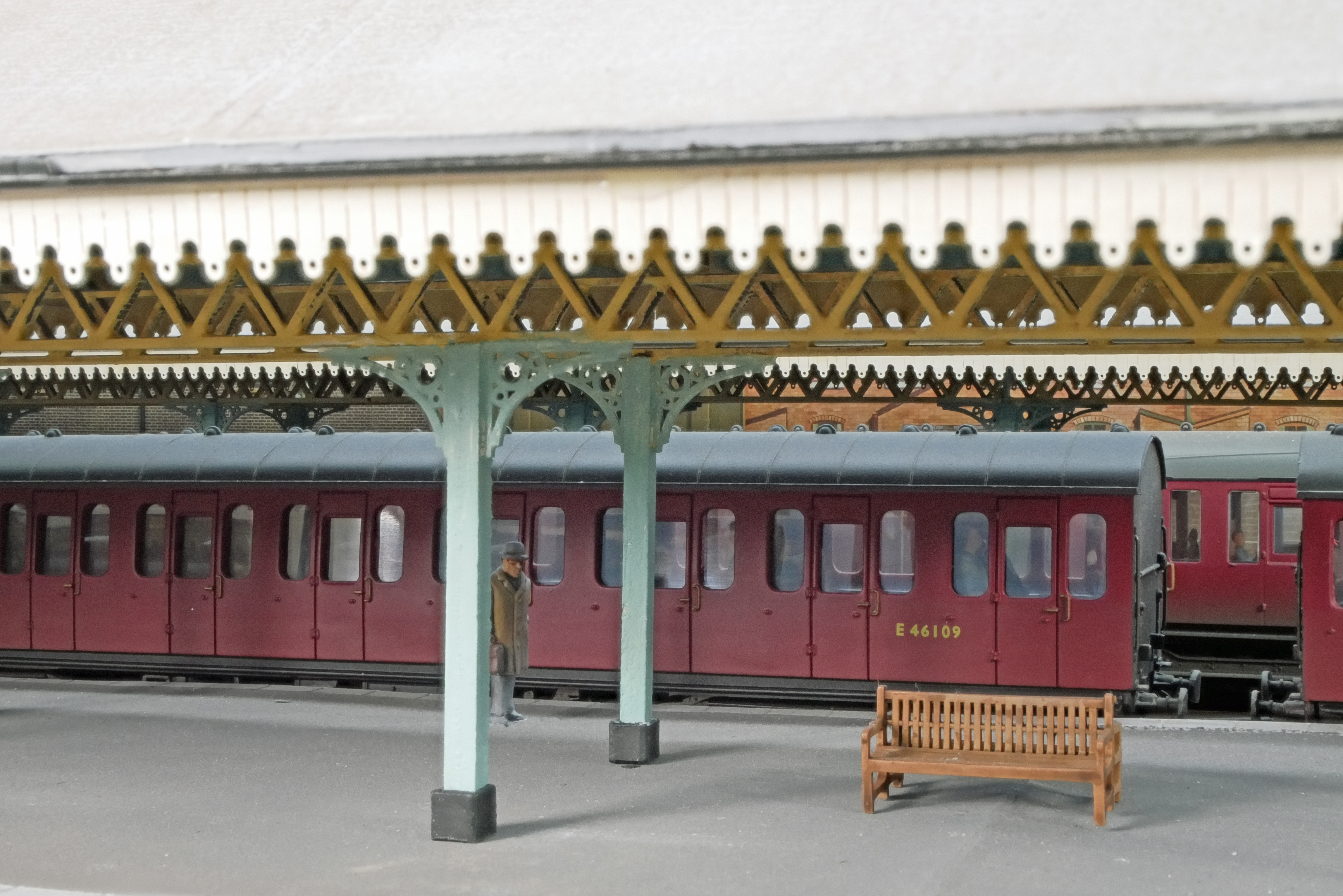

Silly busy at the moment with a number of things including a family wedding in Norfolk (I'm in the North West so couldn't get much further away!) and a visit from Karl Crowther, estwhile Pres Sec of the EM gauge Society and nominated lensman for the Railway Modeller.  I attach a sample of his work - this is not mine to own but I can use them provided I acknowledge ownership - so consider his ownership duly noted.
These are just two of the eighty-odd pictures he took on the day.  No publication dates yet, I am not even sure what pictures the Editor has selected, but I will have to provide captions in due course.
The first photo captures the inner city feel of Trinity Square but does rather show up the distance between buffers on the coaching stock.  This is a compromise I guess I will have to live with until I bite the bullet and start changing couplings on all 850+ pieces of rolling stock :thud:
I am also not really quite sure why a B17 with a Down stopping train is rolling into platform 3!!  I guess it makes a better picture…………
