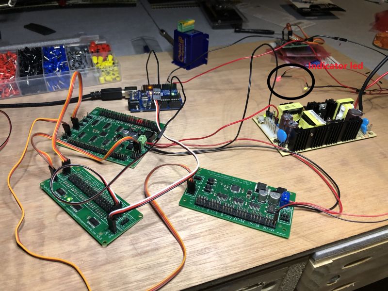

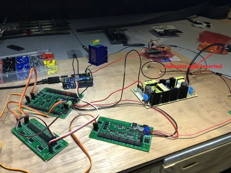

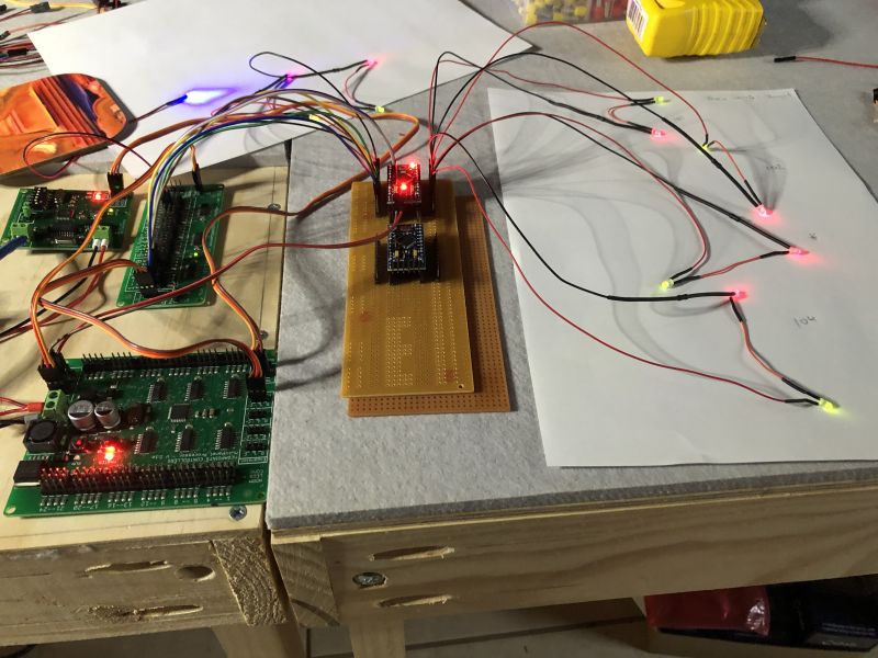

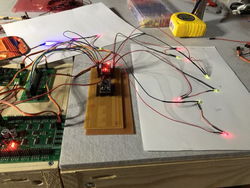

A quick update on the Megapoints Controls implementation - in particular displaying turnout/points position feedback to a mimic panel by way of a pair of bi colour leds. i.e. both leds always on, one green, one red. As the turnout/point is thrown, the leds "change colour" indicating the route available.
Underlying tech is MP's multi panel processor (mpp), feed back module, voltage sense board and a led expansion board, together with an Arduino microprocessor. The Arduino is used to detect the signal hi and low sent to the led expansion board via the feedback board and the mpp. As the Arduino "senses" the change in signal, it activates the red/green or the green/red combination as required. - The MP set up is not able to do this for "real time feedback", it is only able to do it for sent switch commands.

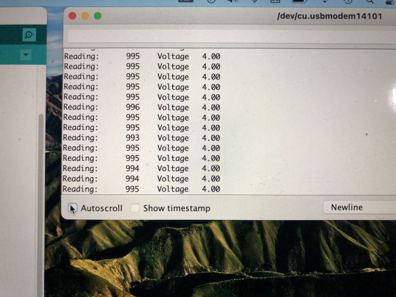

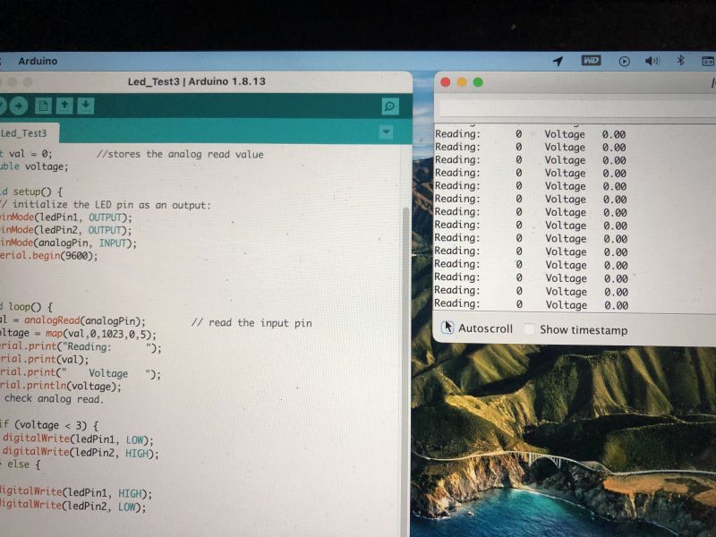

These next two pictures show the system sensing track power across the point/turnout (see MP web site for wiring details) #1 shows the leds lit, (upper right side of the picture) #2 shows what the Arduino "sees".
These next two pictures show the system sensing no track power across the point/turnout (see MP web site for wiring details) #1 shows the leds lit in reverse, (upper right side of the picture) #2 shows what the Arduino "sees".
Apologies for the poor state of the wiring, no breadboard to hand, but was itching to get the scheme working :thumbs
Tomorrow, I will clear off the "rat's nest", put the board on its side and get the wiring phase started. The plan is to get one point motor installed and wired up and tested, end to end, with the above scheme, the beginning of the accessory bus, the track bus and the low power DC bus (driven by a robust 24 volt 10 amp supply with appropriate DC-DC step down converters as required.)
Hopefully I can make another report after Anzac Day - big weekend coming up for me.
Cheers :cheers

No, it does confirm the position of the blades. I probably did not explain myself properly. The detector, if hooked to the point correctly, will detect the actual position of the blades, straight through or thrown. The issue is with the indication. Using the feedback module, connected to the mpp network, point detector (voltage sense across a stock rail and a switch rail) and the led expansion board, the system can then toggle a pair of leds on/off, indicating the actual route set on the points.[user=2199]Andrewdonald[/user] wrote:
Does the below mean that the system won’t be able to confirm that the blades of the turnout have thrown correctly?
Feedback indication
However, I wanted to use a pair of "bi colour" (red/green) leds, so green shows selected route, red shows blocked route. To use the bi colour leds requires the led expansion board to be connected to the "led compliment " (reverse voltage) connector on the mpp board and not the feedback connector. There is no compliment capability on the feedback connector. Using Bi Colour Leds From the video you will see you get an indication when you remotely switch the points, but this is reporting what your requested, not what the point actually did. In the video you will notice that there are no points connected to the demo system.
I really like the multi colour indication for the real state of the points, not just what was requested - Grand kids fingers moving points………. :It's a no no I like to see a positive yes (green) and a positive no (red). Anyway, I went ahead and purchased the system and figured out a work around. Let the Arduino receive the indication via the network and have it toggle the leds as required. The Arduino can handle six pairs of leds, so I will have two for the lower level and probably two for the upper level. The other good thing is that the Arduinos will sit inside each of the mimic panels along side the panel processor and led expansion board which will be used for indicating block occupancy as well as proving point data to the Arduinos. I might also be able to find additional uses for the Arduinos:hmm (An Arduino will certainly control my turntable, when I get to that point in the build.)
So short answer, sorry, the system does detect the position of the blades, but I wanted a different status indication using the bi colour leds. Clear as mud I guess

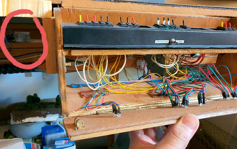

My layout is DC and my point control system is totally analogue using a single large relay with 3 output circuits for each set of turnouts. The SEEP solenoid point motors have an auxiliary switch circuit that is driven by the point actuating rod being thrown, that feeds my relay which then changes the point frog polarity (1) and changes the voltage/current direction via resistors of the bi-colour LEDS, Straight (2) or diverge (3). (at least, it's been a while since I wired them up and I think that is how it works, there is a description in my layout thread somewhere).
I mostly follow how your arrangement works. I think that your tortoise motors have the same auxiliary output. Programming with the Andruino looks fun… something I'm hoping to play with later on.
My Llandyfriog junction has six points controlled from this panel. You can see one of the relays (circled in red) sitting on the L-girder.

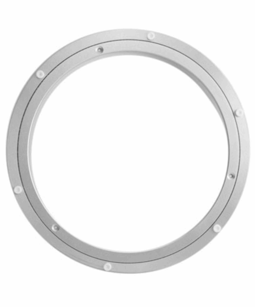

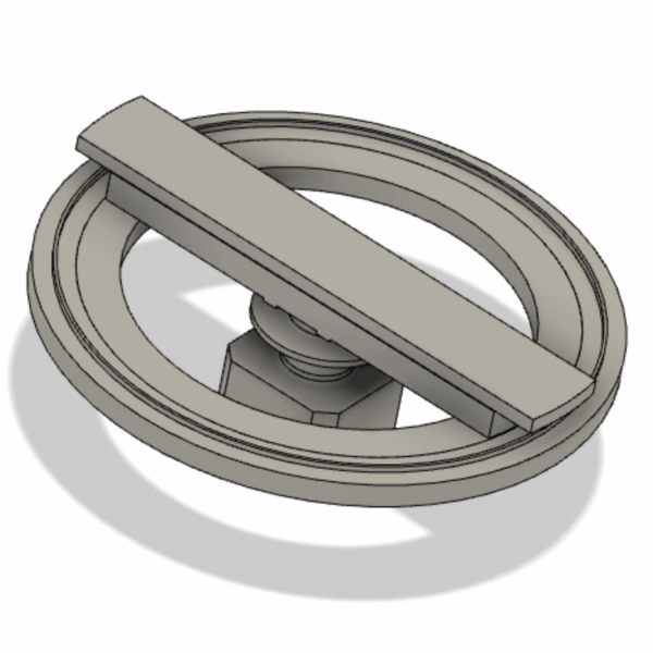

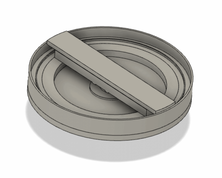

Well as I said over on Dave C's blog, his turntable discussion has really got me motivated… I have always intended to have a turntable on my layout and it is part of the layout plan. I also wanted to make the TT a DIY project. So, I drew the prototype design up in Fusion 360 ( a very nice cad/cam tool)
The full table.
Without the pit floor and wall, showing the overall concept.
An aluminum Lazy Susan base will form the chassis for the turntable. The outside ring will be fixed, the inside ring will rotate

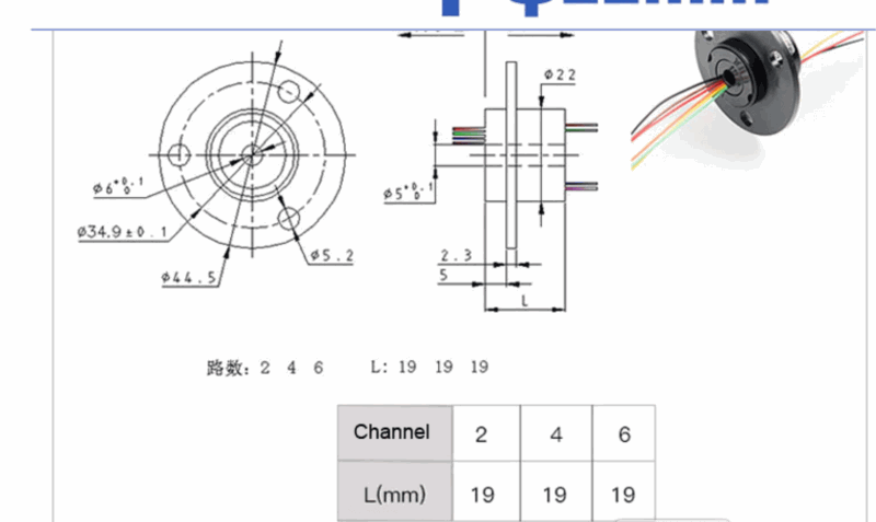

Power will be fed to the bridge track via one of these neat slip rings. I will use the 6 channel. I only need two for the track, but the other four wires might come in useful for something else, lighting perhaps? The design calls for two sensors to 1) enable the zero position for the bridge (stepper motor) to be able to be found and 2) to switch the polarity of the bridge track as required. Switching to be achieved via two solid state relays. I am not sure yet what type of sensors I will use. Any suggestions?

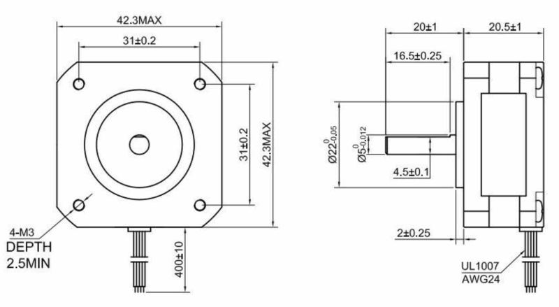

Currently I am thinking of using this "pancake" Nema 17 stepper. Plenty powerful, but has the added advantage of not requiring as much space below the track. I will also research the smaller steppers as well. At this point I will use the easy driver board.
The entire turntable will be controlled via software running on an Arduino Pro Mini micro controller. Overall command will be exercised via a turntable control/mimic panel, the design of which is yet to be finalised. My initial thoughts are tending towards a rotary switch in the centre of an etched plate with red and green led at each position of the switch to indicate bay availability, green available, red occupied. (not really needed as the operator will be able to see the turntable - but it will look cool for the grand kids!) The Arduino will provide expansion capability for things like round house lighting and so on.
Now all of this is quite some time off yet for realisation, but I hope to do some prototyping,in the near future with some bits and bobs I have to hand. I am keen to begin developing the code and incorporating the sensors, at this early stage I will use limit switches to simulate/emulate the sensors. (Or I could simply use push buttons).
Anyway, all good thoughts. In the meantime I have recommenced work on the underside of the boards, so more to come in that area after the weekend.
Andrew :cheers

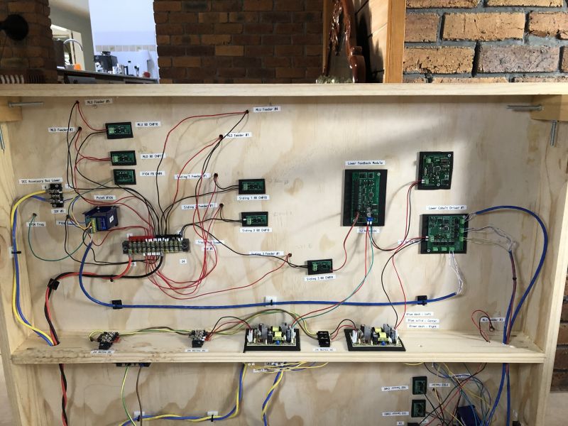

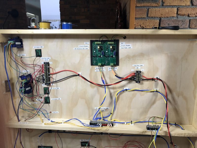

Here we see one half of the board. The two large green board at the top of the picture are PSX circuit breakers (fast acting digital breaker) One is currently protecting the DCC Accessory Bus (blue and yellow) and the other is protecting theTrack Power Bus (Red and Black) - Apologies for the harlequin colours on the pigtails into the breakers, I do not have the appropriate coloured heat shrink - this will be attended to in due course. Lower right you can see the extension of the buses that are terminated in a "chocolate block" for connection to the neighbouring board. (sorry I cut the connector out of the shot) The smaller green boards are the Mega Points Controllers (MP) sensors for block occupancy and turn out status. As the next board progresses topside next week, I will add in a dedicated feed back bus to bring track droppers back to the appropriate sensors as required. (right now there is only one dropper per block detector, as the blocks increase in size, more droppers will have to come back to the sensors)
Here we can see more of the MP network. Centre and left we have more sensors. To the right we have the Feedback board, the Cobalt driver board and above it the first CAN bus node. The feedback and driver boards are linked over a simple local I2C network. (connecting cables not in place yet, I have to manufacture them). As the layout grows there will be other local networks around the layout. These local networks will all be connected via a CAN bus. At this stage, the CAN bus will extend from this board to a temporary "mimic panel". (All of this "black magic" is well explained on Dave's MP site.)
On the "shelf" you can see the beginning of the 24/12 Volt DC distribution bus. 24 Volts is/will be distributed around the network and DC/DC convertors will be strategically deployed to provide 12 Volts DC as required. (I am a bit paranoid about having clean power to the IC boards)
Finally you can see that I have utilised Cat 5e data cable to connect the point motors to the driver board. The various colours and patterns (block and dashed) make it easier to ensure left, right and centre are properly connected. I will also use a single pair of a Cat 5e cable for the Can bus - it requires a twisted pair - data cable fits the bill nicely.
Oops, looks like I forgot to label the Can bus node - well I will have to get "down under" again soon.
Cheers, Andrew :cheers

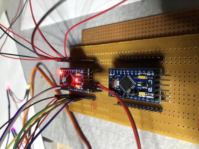

The MP boards (green) are, clockwise from the left, the CAN Bus node, an LED Expansion Board and finally, the Multi Panel Processor Board. What I like about this system is the fact that there will be only one cable from the layout to the panel, the CAN Bus its self, and of course a local power cable. The CAN Bus cable is cat 6 data cable, it can be seen on the very left of the picture, utilising only one of the pairs in the cable.
This last picture is a close up of the Arduino Pro Mini microprocessors that I am using to manage the bi colour, or composite led, colour change in response to the detected point position. I created the break out board myself. Once I have the remainder of the track and points established for this lower level, both boards will be in use driving 12 pairs of leds, one pair per point. It is also very handy that the MPP board has multiple 5V DC outputs, two of which will power the two Minis.
Sorry that all of the wiring looks a bit messy. Most of it will be managed and then hidden within the eventual mimic panel housing. I will not be finalising the panel its self until the track on this first level is finalised. (not quite sure what the fiddle yard will look like)
