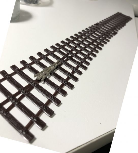

The first four B7 Turnouts arrived recently and today I set myself the task of assessing the assembly, reported to take about 30 minutes! The beauty of these kits which attracted me was the simplicity so today I can confirm that feature. (but see footnote #)
The first photo shows the track base and cast frog (not yet installed)
The 2nd shot shows all rails except the switch blades now installed. The frog is still loose with its wire attached coming out underneath.
The final shot today shows the close up detail of the frog area as per #2 above.
The frog is not yet glued firmly into place, once secure in its sockets it will align perfectly with the exit tracks.
Because of the frog design, it is possible to insulate this from the exit tracks and then avoid the need for isolating fishplates on the inner rails.

Overall I'm very happy with the outcome, a basic Dapol Cattle Van ran seamlessly across the frog. You will note that the long, single piece switchblades self-centre when not installed since there is no spring mechanism in this design.
It is a credit that this kit goes together easily and so well to give me a product which ticks all the boxes. Unfortunately I can't give an opinion on the forthcoming releases of their other planned turnout geometries and the diamonds, switches etc. because they will be built with an all track design. This will bring advantages but potential challenges with more complex assembly of both the frog and switch blades. According to reports from the company, more news of these changes should emerge in coming months.
