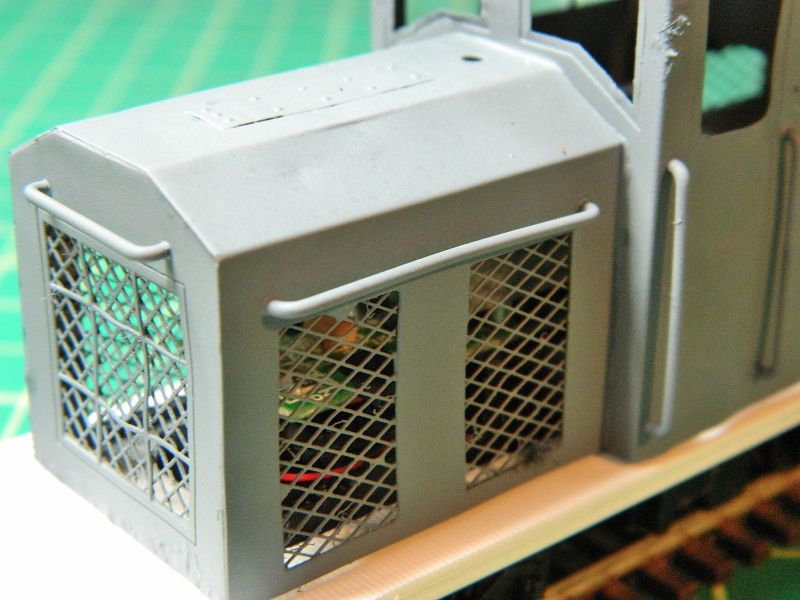

I fabricated the side screens for the hood today, brass strip and diamond mesh, soldered-up, long piano-type hinge on top (brass rod). Just needs some lines scribed on the rods and some small plates and rivets on the frames for the hinges, plus a couple of handles at the bottom. I propped one on the side for the photo. This is what I was looking for, that could be a diesel engine lurking inside after an on-site addition of mesh doors to keep things cool. I'm tempted to fabricate an exhaust manifold and air cleaner. Or find an O-scale engine and strip it for parts.
The grills will get blacked before fixing to the hood. I have some rivet decals (transfers) for detailing that will be added after painting. Radiator cowling and grills tomorrow, as well as the louver panels and doors to go on the hood in front of the grills.

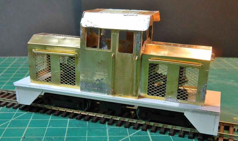

More progress on the body shell. The shell was extended almost to the front buffer beam, the front steps removed, a radiator box and grill fabricated from styrene strip, the buffer beams were beefed-up with styrene strip and lowered by around 2mm, and the louver doors soldered up. Just positioned for the moment, I'm waiting on some pin and rod coupler mounts for the buffer beams.
I decided on a break (well needed sez I) from the 3D diesel body shell bash while I wait for the pin and bar coupler pockets to arrive. A1 Models do some nice looking body shells for center and end cab On16.5 diesels, not expensive, and near enough in scale to On30 not to really make any noticeable difference. I got the center cab one, looks like a cross between a Whitcomb and a Hudswell. It's a brass etch, fold and glue or solder, the intended donor mechanism is a Bachmann GE 70 tonner to which the brass is glued. I decided to scratch build a chassis/platform/buffer plates for the body, the left-over body shell can go on eebygum (where they seem to go for quite interesting prices) and solder the shell together. The 70 tonner models come with basic DCC now (the new model cost me $54), which for my purposes (forwards, backwards, lights) is sufficient until I get a sound decoder.

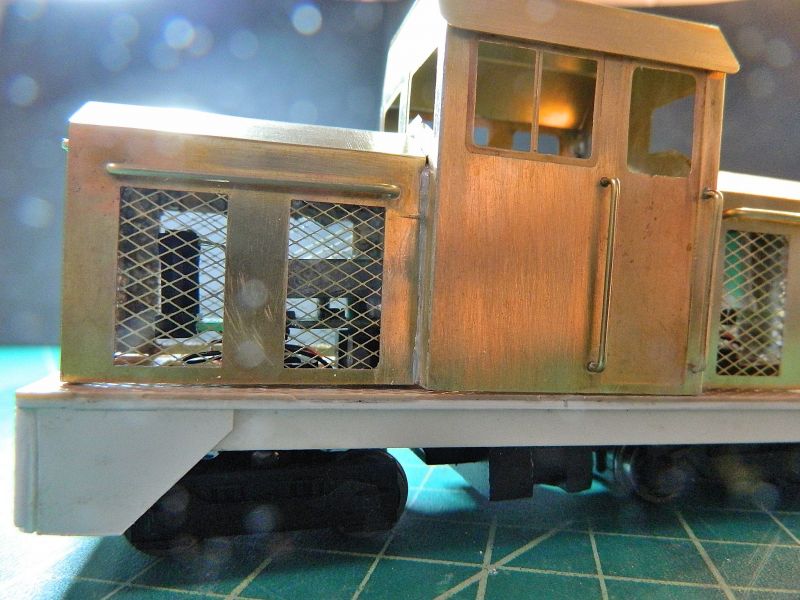

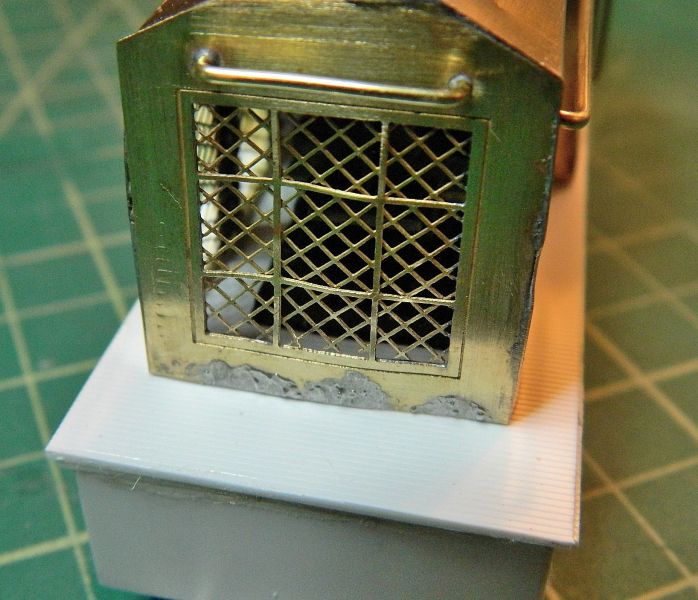

This was a straightforward construction, solder the front grille and radiator mesh to the front ends of the 2 hoods, fold the hoods and solder brass mesh over the hood side openings rather than the supplied doors, and fold and solder the cab together. The hand rains were made from from brass rod. The only thing of interest construction-wide is that most parts were tinned with the small iron, and then soldered in place using the big 'un. Nothing really exciting here (move along, move along), so 'nuff said.The chassis/footplate was scratch built using styrene sheet and bar after I did some measurements of the donor and brass body and drew up a template in CorelDraw, Again, a straightforward cut and glue. This model has taken a total of 2 evenings work so far, I need to do some exhaust stacks, and attach some air tanks from the spares (white metal, bit of weight). I am thinking about attaching the cab roof with neodymium magnets and steel bar to make access to the cab easier. Plus lights.
The body shell still awaits a final scrub and polish before painting. Plus some wivets on the body and NBW's on the end gussets and end buffers.The last picture shows the effect I'm looking for with the innards clearly visible through the mesh. I'll probably use a couple of Lego pieces and wire to give the impression of machinery and hoses. Photo's are useful, I can see a couple of places that need a bit more solder or filler before priming. I also need to take the small hammer to the body shell - this is a hard-working locomotive at the end of it's life that has received it's fair share of dents and knocks over the years. Found some nameplates in O scale - "Joan" it is.

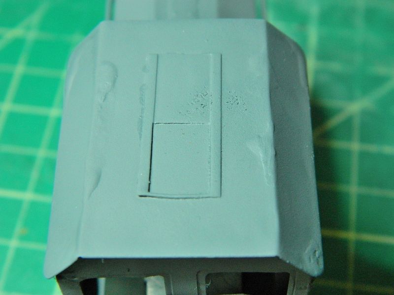

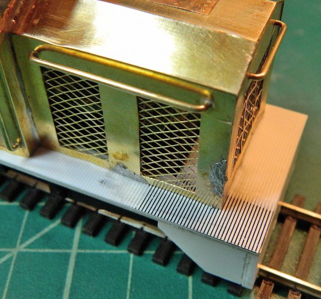

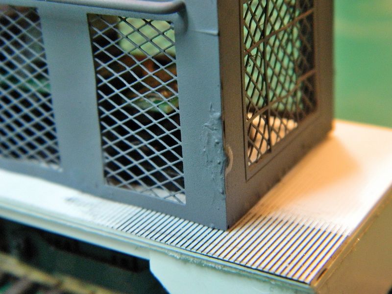

Next steps were the "dinging and denting", "paint bubbling" and a couple of repairs where cab plates had rusted through. Whatever was handy for the first, the second was done using some solder applied in the likely places for bubbling and rust formation, the 2 repair plates with bubbling were soldered on each side of the cab. Bit of judicious bending of the hand rails also using a large pair of pliers. The idea is to give the "bubbling" a couple of coats of red oxide primer at the edges, and cover with peelable film when applying the final color.
I also redid the base plate, bit longer (to give 12" walkways at either end). Too windy to apply the red oxide at the moment, one of the joys of living 140 feet high. Waiting on the NBWs at the moment.
First time I've gone for a dented and rust bubble look on a model, the brass in this kit is thin, and easily dented and marked. Difficult to do with styrene sheet, that requires careful use of the heat gun or the tip of the soldering iron (I did a bit of experimenting this morning).
Ladders next plus some rudimentary handrails for the ends. And some internal radiators.
Well done. I particularly like the use of solder to create rust blisters on the brasswork shell, besides lots of distressed thinware.
Thanks. First effort at bashing (literally) a brass locomotive. Tough decision when you've spent a few hours building it. Good excuse for poor soldering and not keeping things square in the build though (as if :roll:).. Authenticity is the aim, hopefully we'll get something closer than an "as built". This one has been in a derailment, hence the bent hoods.Gave up on bending the frame though. Put a slight curve in the body shell though.

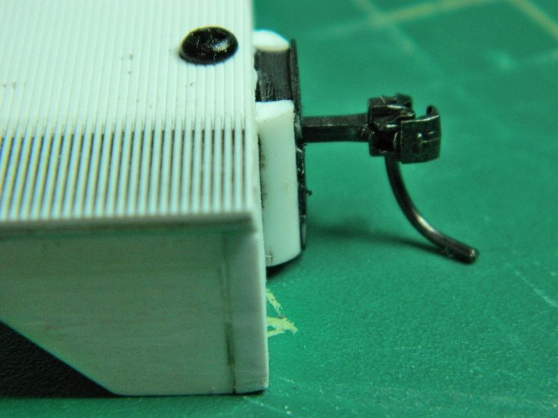

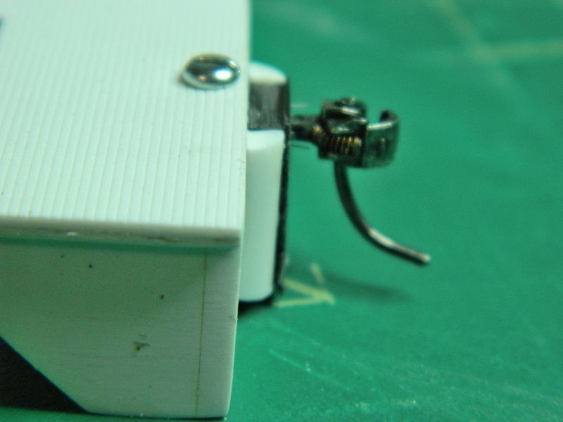

Spent an hour thinking about the coupling requirements. Where these diesels will be working there will be stock with different coupler heights, so some sort of coupler block with adjustable levels on the beams will be required. Hmm. Time for a think and a cuppa or two along with some digestives for the neurons.

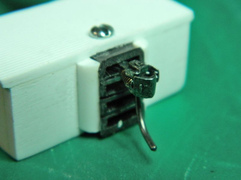

So: Four KD coupler gear boxes suitably trimmed and glued together vertically (I have a box full of the gear boxes left over from installing whisker couplers on stock already equipped with boxes), 2 of, a suitable hole made in the end beams using fine saws, and the coupler block glued in place after a bit of fettling. Hole drilled through the footplate locating with the hole in the gear boxes for a 2-56 nylon or SS steel screw, job done! SS screws allow for easy removal with a magnet.
The work hasn't been tidied up yet, this is just to show the idea in practice. This buffer block will allow me to use pins and bars or pins and chain links (lower 2 or 3 holes, prototypical for the layout when I'm playing at home), as well as good 'ole KDs for shows and the like (highest hole if my measurements are correct).
I'll clean-up after the glue has completely set and out-gassed.
One end.
T'other end.
Highest level
And…Next to highest level

Thanks. Case of necessity, commercial offerings were either out of scale or costa gotta. The KD gearboxes are essentially freebies.
