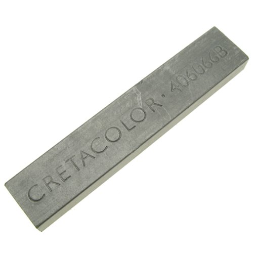

Graphite sticks as backup

Graphite sticks as backup Ah - must try that …………. :thumbs Where do you buy your graphite ?
