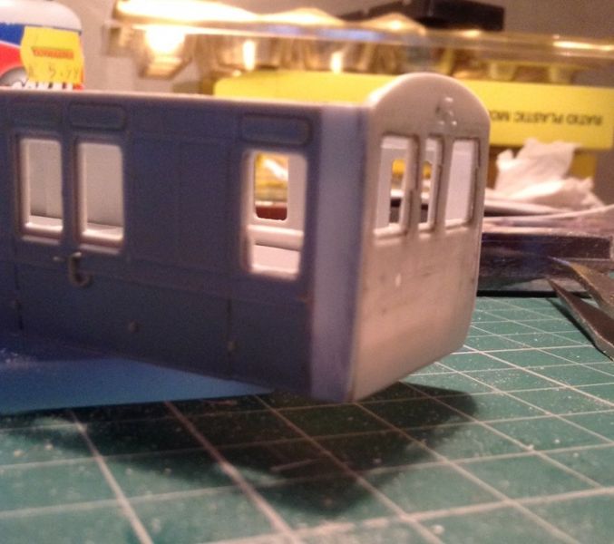

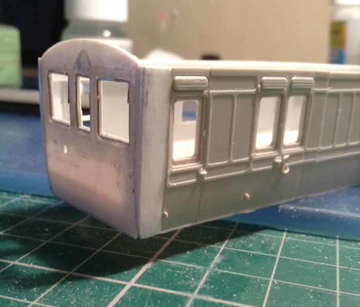

A major reconfiguration of very large kitchen furniture continues tomorrow, so progress is severely limited. Today, I just glued a strip of 30thou styrene to the lower inside part of the driving end. This will enable me to safely sand the tumblehome, as I chickened out of bending the end for fear of breaking it.

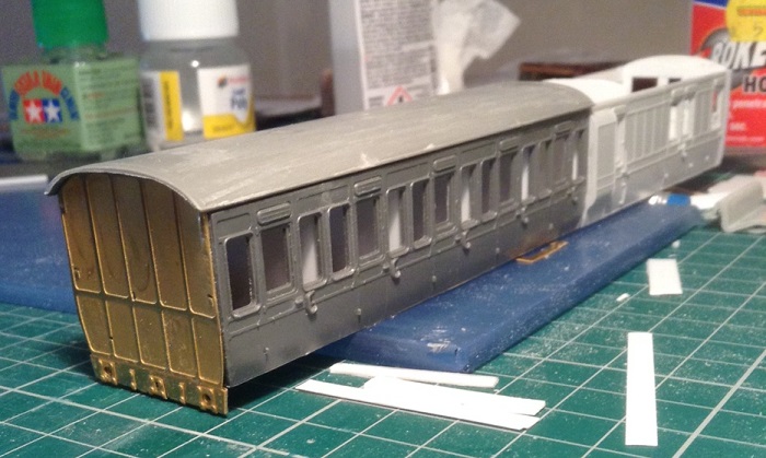

I’ve left the rear end off until last, as it’s brass and needs careful fitting with superglue and plastic angle.
I’ve just noticed, as often happens with these close ups, that some bolection sections are loose, so it’s out with the CA again in the morning!

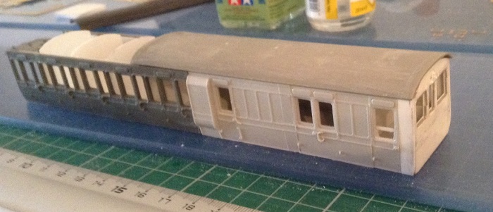

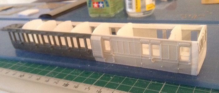

I trial fitted the roof with every partition to ensure the body shell retained its correct width. This is not normally a big issue with a straightforward kit build, but since the sides are an amalgam of several panels, it’s essential to keep them on the straight and narrow!
I need to find some blue-tac in the morning to hold two really tiny brackets in place though fixing holes in the rear panel while I glue them from behind, then I can fit the end and give the body a careful wash, ready for primer.

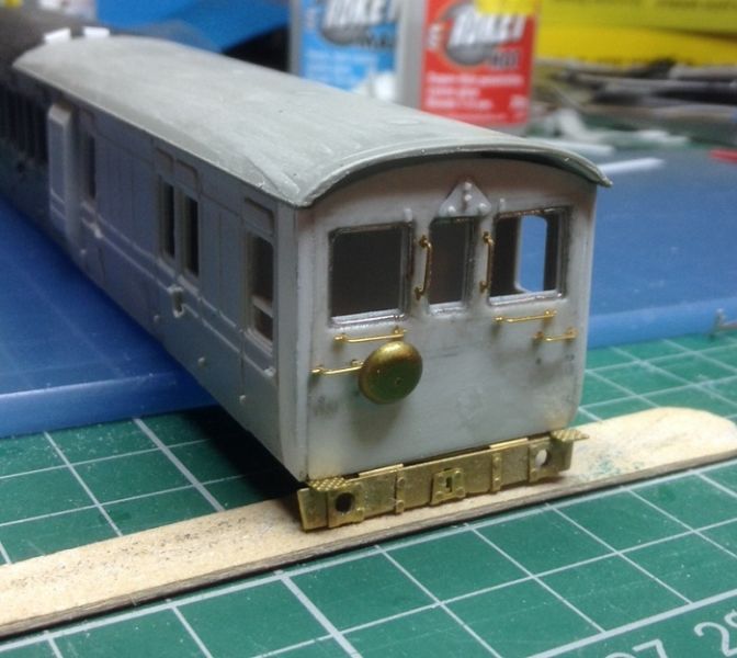

I got some fine filler into some body gaps today, attached the brass rear end and prepared the underside of the floor for the front buffer, also a brass etch. Once these are fixed, it will be time for primer.
I did notice however, that the 3rd Class seating is a little tight for space and that the glazing will take a while to fit, as there are 17 separate pieces to fit and I better use Glue and Glaze.

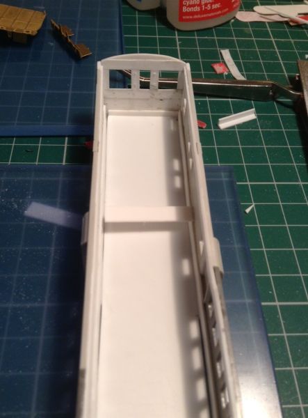

I fished out some packs of the old Ratio seat extrusions and smiled at the price tag from a few years back!
This is where a mitre block is the essential assistant to Mr Jack the Razor, to avoid ill-fitting seats. I commented yesterday on the cosiness of GWR 3rd Class accommodation, well this is where those seats need to undergo liposuction, the half millimetre per seat giving a valuable extra 3†between kneecaps in the cheap seats, although the real reason for reducing the thickness is to prevent seeing too much of the backrest through the windows and particularly the space behind the curvature of the seat back showing.
The left hand seat is straight from the pack, while the one on the right is in post-operative care. With ten seats to cut, file, shape and notch round the coach reinforcing strips, it takes a good ten minutes a seat, so like ballasting, it’s best to do it in more than one session!

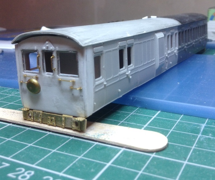

In finishing, here’s a photo from yesterday, with the rear end firmly attached, detailing to be added later.

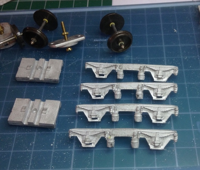

I opened the 'new old stock' K's bogies which need to be fixed soon and was unimpressed with their crudeness, so will revisit a pair of 3D prints in the parts bin and then make a decision, as I need them fitted to set the ride height.
More soon,
Yes, there are bogies Kevin, as mentioned in my last post above and if you have the time to read through the thread, you'll see how this driving trailer is produced from a couple of Ratio 4 wheelers. There is also a matching intermediate trailer and is a much simpler build.
Here's a photo of the Dean bogies.
They don't have step boards yet and I'm not sure whether to use them or a set from a 3D print. The bogies are bolted through the floor, while the solebars are added, together with vacuum gear, brake linkages, etc to the underside.

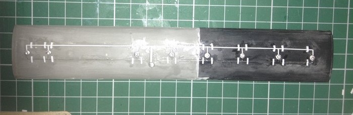

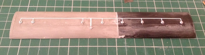

Today I fitted the gas lamps and as this set will be in the 1930's simplified livery, I fitted the later two pipe system for gas and pilot lights.
The pipes are fed up to the roof from the guard's compartment via the off centre cover made by removing the lamp top from the white metal casting.
Then came the rather tedious process of the pipe clamps, holding the pipework to the roof. I made these from microstrip which is well over 30 years old and had an anoying habit of breaking once solvent was introduced and even a small amount of pressure applied, so many replacements were necessary. The eagle eyed will notice some pipe clamps still need fixing down on one side. Gluing each clamp in a two-stage process seemed more successful against snapping, but took much longer.
Just rain strips to add and after some cleaning up with 1000 grade abrasive paper, a coat of primer will greatly improve the scrappy appearance.
