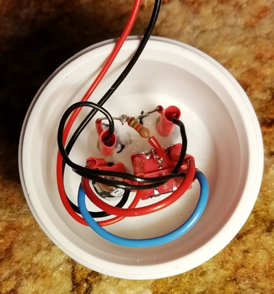

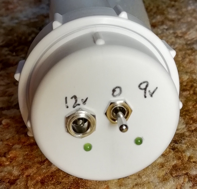

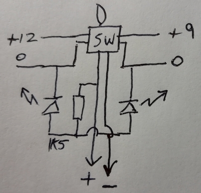

I've not been totally idle though - I've been doing what I can of the electrics. This, perhaps, was on the list to be done "after" the body of the applicator had been completed. But, hay ho! At least we're one step closer to having it work.
I decided on a circuit with two LEDs (and not just the one I had originally planned for) - and without the use of diodes as per Luke's diagram. The +9v and +12v goes to either side of the DPDT switch (pole A) and the 0v connections go to other side of the switch (pole B). The LEDs and the current limiting resistor connect between the positive switch output (that goes to the ion generator) and the respective power 0v input connection (i.e. before the switch). So only the LED will light for its respective power source. By this method, only one LED can ever be on at any time. This does away with need for any diodes. Don't forget the current limiting resistor.
That's the circuit, using a DPDT switch, two LEDs and a 1k5 resistor. I've used two 3mm green LEDs, but you can use whatever is lying around in the scrap box (and there's plenty of stuff lying around in my junk box - not necessarily anything I need but plenty of "junk").
Not much to say about the wiring - the two wires leading off to the top go to the internal 9v battery. The socket, almost hidden to the left of the switch is where the external 12v supply comes in. All that's needed now is the wires to the ion generator (when it arrives!!).
So that's about it for today. The End Cap more-or-less completed and (temporarily) fitted onto the body.

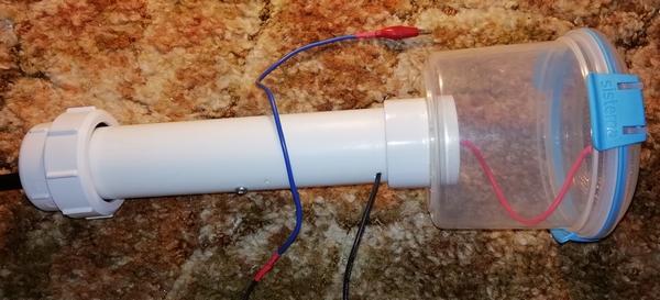

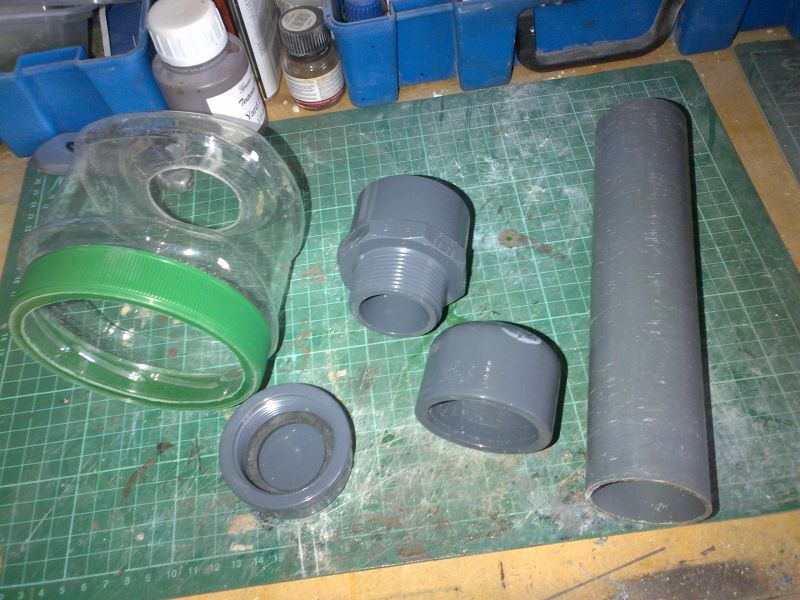

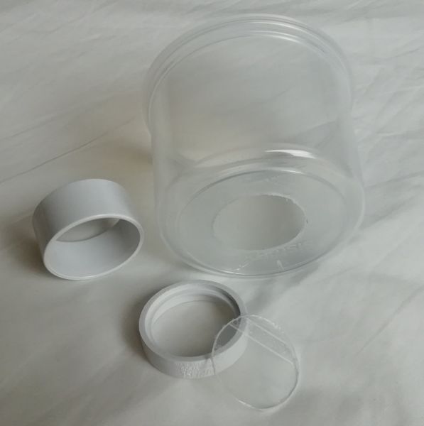

While we're waiting for today's post to arrive, I made a start with the container side of things.

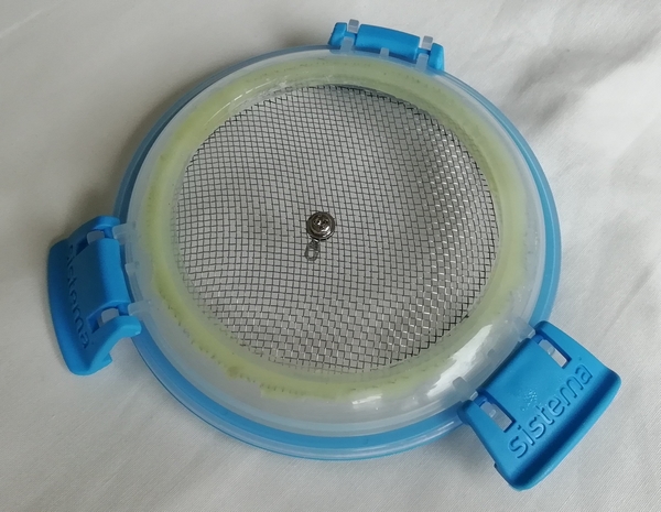

The container lid was the first to feel the wrath of my knife blade. The centre of which was cut out in readiness for the mesh to be fitted over the hole. I thought I'd try to make a solder connection onto the mesh before I went too much further. Not a chance! The solder wouldn't take, no matter how long I held the iron against the mesh. I thought my soldering iron might not be powerful enough. So I tried to attach a magnet to the mesh; even that wouldn't attract - so I guess the mesh is probably aluminium. No worry, it still conducts electricity with very minimal resistance. Therefore, I've made use of a small nut and bolt with a "solder tag" in the centre of the mesh - I'll not be beaten! A pen mark on the mesh gave a good indication of where to cut - but do make it a little larger (10mm or so) so that the mesh overlaps the edge of the hole
After roughing up the inside of the lid with a bit of sandpaper for the glue to take hold against, the circle of mesh was then rapid-set epoxied onto what remained of the lid. Give it a short while and that'll be set and job done.
Next up is the container base and the hole that needed to be cut to be a close fit over the pipe (body). A bit more care was needed here as the section taken out needed to be reduced slightly to fit inside the coupler off-cut. Make a mark with a pen around the outside of the pipe and cut a little on the inside of the mark. This is so it can be filed down to ensure a tight fit over the pipe.
The coupler needed to be cut a few mm to one side of the flange half way through its length. An insert of plastic (taken from the cut-out from the container base above) needed to be slightly cut down and made to be a close fit against this flange to prevent the static grass falling back down into the tube. The coupler needed another cut to be made about 10mm away from the first cut.
That's the first four bits to go onto the pipe:
A section of coupler with the flange - about 10mm wide;
A plain section of the coupler - about 20mm but could be cut down a bit further;
The plastic insert to into the coupler with the flange; and
The container base.
The 2nd (plain) off-cut from the coupler goes on the pipe first followed by the container base which is then followed by the section of the coupler with the flange and its now glued in insert. If all these parts fit ok - don't glue them in place yet - push them down to the end of the pipe and make a mark where you will next cut the slot for the ion generator to drop into (when it arrives that it!). The 2nd coupler part will only go down on the pipe as far as the other side of the flange to the blanking off plate.
Nothing here has been glued just yet - I'm really as far as I can go at this stage without the ion generator (the seller has been informed it's overdue!).
As I'm using the smaller of the two 40mm pipes together with the larger coupler, some form of packing will be required to hold the two parts evenly spaced on the pipe - a couple of small pieces of card should do the trick and then the whole lot can be glued once the ion generator has been fitted.
Incidentally, Ian, a small glue gun has been ordered and I would imagine it will do the "glueing" job here just fine.
Now I can sit back, have a cuppa and wait for the postman. Maybe tomorrow.

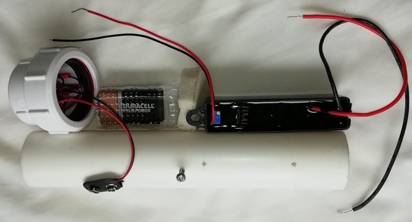

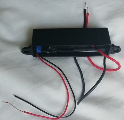

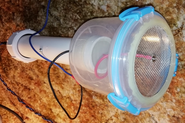

Having seen the ion generator up close and personal (so-to-speak) I note that there is an edge to the undersides of the item and these can be filed down sufficiently to allow it to slide into the pipe with slight restriction and a lack of distorting of the pipe. Very useful. Also, a small 'nick' can be made in the end wall for the positive HV wire to make a more graceful exit from the generator out to the container base and mesh.
The fixing lug at the HV end of the ion generator can also be cut off to allow it to be pushed closer to the container base and thus give a little bit extra length to the HV wire before being soldered onto the container lid mesh.
Once you're happy with the fitting here, remove the ion generator temporarily and the high voltage wires can now be accommodated. Three holes need to be drilled - one for the fixing screw (see below), one for making adjustments to the preset resistor on the ion generator and one for the negative wire to exit the pipe. A hole also needs to be drilled in the blanked off end cap for the positive HV wire.
The ion generator can be held in place inside the tube with a simple screw screwed into the pipe with the end of the screw fitting through the remaining lug on the generator itself. It doesn't have to be totally secure it as it is a moderately tight fit within the pipe; all that's needed is to stop it sliding up and down within the pipe. A small piece of foam can be inserted between it and the blanked off end cap (makes it look a little neater!) and also at the other end for the battery (if fitted).
All prepared, from left to right, the screw cap with the 9v battery lead, the battery itself inside at make-do housing, then ion generator itself with one lug cut off. On the pipe itself there's the securing screw, the hole whereby the small adjustment preset can be accessed next to it and the hole for the negative HV wire further down the pipe.
The negative/earthing wire may need extending to give enough slack for clipping on to the baseboard; the positive HV wire should be amply long enough. Once again, you may find it better to sand down any surfaces where glue will be applied to provide something for the glue to attach itself. Hopefully, the ion generator was tested before being 'fixed' in place.
Slide onto the pipe the pipe off-cut, then the container base and finally the blanked off pipe off-cut. Pull the positive HV wire through its hole in the end cap and glue the end cap onto the pipe ensuring it is a close fit to the end of the pipe itself. Allow the glue to dry here and slide the container base up against the end cap and glue followed by the remaining off-cut pushed tight against the base. Glue in position. Allow this all to dry and set hard. A small blob of glue can be applied to the HV wires to hold them in place and prevent the static grass from getting down inside the device.
Now the positive HV wire can be soldered onto the mesh - or in my case the solder tag; there should be enough slack to allow the container lid to be removed. Now to fit a crocodile clip onto the end of the (lengthened?) negative HV wire and the job is about done.
The 9v battery, in my case, is housed in a coupe of off-cuts of some small cake slices, glued together to make a small pocket. It should be small enough to be a slide fit into the pipe.
The 9v battery lead can now be soldered onto the switch (if not already done) and the ion generator 12v input leads can also be soldered onto the central poles of the switch.

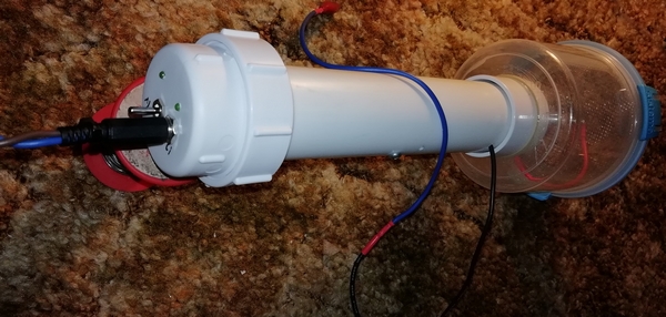

Overall length (excluding any power input plugs and switches) is 315mm - the length of pipe used was 220mm.

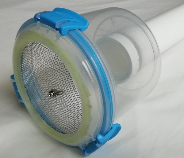

Time now for a test to make sure all is working by switching on (obviously) and putting the negative HV wire up towards the mesh. You should be able to draw a spark between the two.
If the container lid/mesh is a bit large for the area to be 'grassed' over, a circle of card can be cutout - with a tight fit into the container body and with a smaller hole cut in it to provide a smaller opening for the grass to fall through. This is then fitted in place after the static grass is put into the container body. Whether this will work, I have no idea - it was something that crossed my mind to try and I see no reason why it won't work.
That's about it for the applicator, all done and dusted. A quick spark test again with both power inputs (looks good) so now to get on with adding the static grass into the container and the layout will never look the same again! That'll be later in the day though.

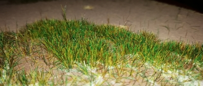

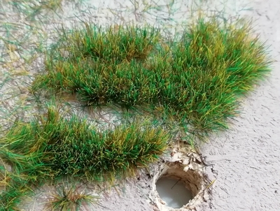

Yes, it did work (thankfully!) and after a small test - which didn't entirely go well; first off, I think the glue was too 'wet' and the grass just flopped and lay down, then my power supply died on me. After many years of sterling work it had the nerve, the temerity of it, to fail at this very crucial time of my testing. Anyway, switched to 9v battery and carry on.
After a few minutes of finding out why the fuse blew in my PSU, it turned out to be a no longer used 2N3055 having gone short-circuit. A quick snip with the snippers soon had it sorted and a fresh fuse inserted all was well again and a bit more grass was applied (simply as a test of the PSU).
The following couple of pictures show - using neat PVA - how well the 4mm grass has taken to standing to attention.
Grass just applied - the PVA is still wet.
The following morning; the whiteness of the PVA has dried and all looks much better.
So I'm well pleased with it so far.
Now to do a bit more research on what PVA mix is best to use for applying static grass.
