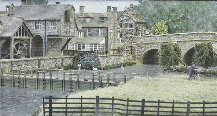

Not the best picture but it gives the general idea.
