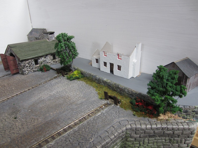

I did a sort of 'How I did it' a while back. This link should get you to it:
http://yourmodelrailway.net/view_topic.php?id=9197&forum_id=14
I flatten it with my fingers straight onto the work piece (brushed with PVA first. Work piece, not fingers…)
Just keep pushing and kneading it over the card until you have the thickness you want.
I've found it will take all kinds of medium - acrylic, water, oil, enamel - I usually give it a quick brush over with matt varnish (Wilko's in my case) to seal the surface.
This shot of work-in-progress on the 'Teifi Gorge' illustrates some of the Das uses:
Hope this helps
Shaun.
Keith.
Time consuming ? Yes, but a truly fantasic finished product - IMHO far better than can be acieved with embossed card (plastic or normal) because the surface looks just like stone. Not too sure it's quite so good for a brick scribed finish but for stone, unbeatable. ……………:thumbs:thumbs
