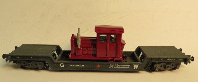

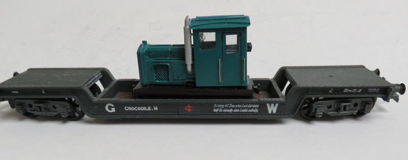

I have bought it to carry my 'Tugwell-Pushleys', the manufactory for such will be my 'industry' on my nascent trainset. It will gve an opportunity for a OO9/OO interchange.

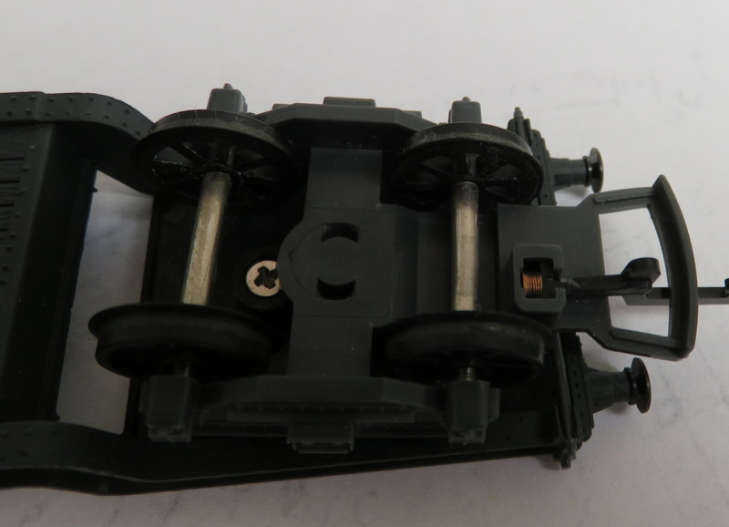

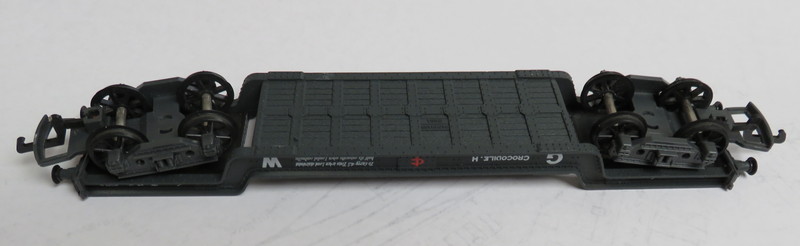

Tension locks. Cut off old ones from bogie, replace with narrow long ones (Bachmann Accessories #36-026).

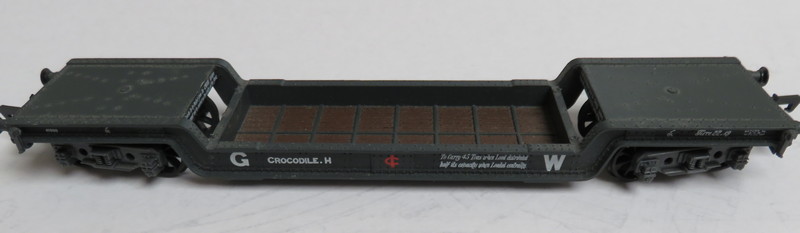

P.s., I do appreciate that the load would not be resting on the middle of the 'floor', but more realistically on beams running the full length of the well on the cross members [there is a perfectly legible notice to this effect on the inside of each end deck, not bad work for such an old model] or on cross girders supporting each buffer beam. D

Edit: File off the leaf spring on the bottom of each bogie to make it a G.
The Bachmann Weltrol might be a possible donor for bogies perhaps???? That would give you a NEM pocket and small couplings. Just a thought but appreciate that there might be differences that are not acceptable
