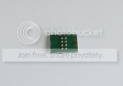

In the past I posted a note about the Lenz silver direct decoder ref 10330. Whilst it is probably a brilliant decoder the buyer should beware. It is designed just to plug into the socket in the loco without trailing wires. The problem however is that the plug is at right angles to the pcb and was therefore too wide to go into a castle class loco. It is of course not possible to trim it down and I must therefore try it in future locos with wider bodies. Picture below.

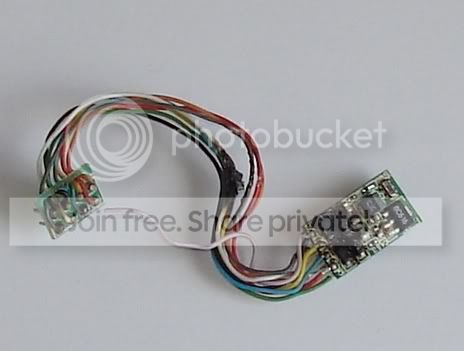

And just for fun, below is a picture of a decoder I cooked earlier. Not sure of the make but it had been operating ok in a castle class loco when one day the loco went "jerky" and I saw the hated blue smoke coming from under the boiler. I thought I'd post it for those of you who wondered what a cooked one looked like.
The pcb is half melted and the wires are burned. :evil:  :evil:  :evil:
DCC is great but we need to be careful.
