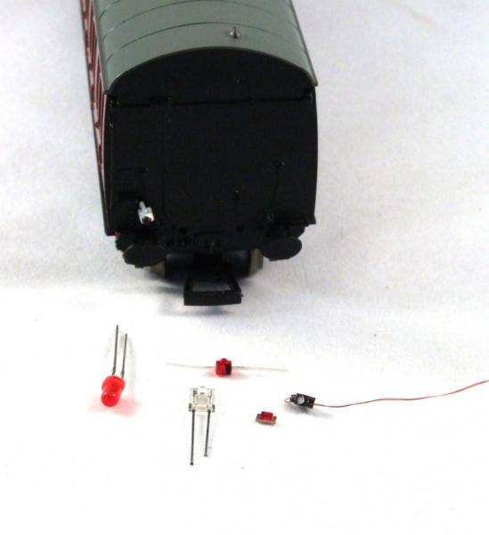

Do these LED's come ready wired with + & - marked Ian ?  They seem pretty tiny to me ………….:roll:
#109859
They are exceedingly tiddly Peter. They come with some form of marking on the back which indicates which end is which. Those huge wires in the picture are standard DCC decoder wires.
#109864
Of course, the LEDs do not have to be very small ones in every application to transmit the light. Any source of illumination will transmit the light along the fibre optic cable, which is brilliant, because you can use whatever light source is best suited to your application.

Where did you get your mini SMD units from Ian?
#109882
………. and what power source are you using Ian, are these watch battery jobs?
#109888
Rapid Electronics
A whole variety in colours and white of various sizes http://www.rapidonline…ronics/Surface-Mount-Leds
Buy more than you need as they are very easy to misplace! ;-)
Rapid are also good for wire, switches, conventional LEDs, resistors, diodes, etc..
Lawrence - just use them like standard LEDs, run from a decoder with a 1K - 2k resistor in series.
#109900
I realised the wires in the photo were not part of the LED Ian, I just wondered what actually arrived with the LED.  I know our friends in the east are good at minaturising things, but to supply those with any kind of wire attached seems to be pushing the boundaries a bit too far.
#109904
Surface mount LED's are available with tails (wires) attached.
One source is DCC concepts in Western Australia.
They also have oo/ho scale working end of train lanterns with wires attached. EG those that were hung on the rear of brake vans etc
 DCCconcepts Home Page
 Ian

Those are tiny Ian. Have you tried them ?
#109932
I've got some of the DCC Concepts 4mm scale lamps - they are incredible.
From left to right:
Standard 3mm LED
Side-view LED (for modern BR tail lamps)
Axial LED for older style lamps - as on the OO coach behind
SMD LED
#109948
[user=339]Ian Morton[/user] wrote:
[user=52][/user]
………. and for the dc Luddites amongst us?
;-):lol:

#109960
If you're using fibre optics to move the light from its source to where it needs to show, what is the benefit of using such small LEDs ?
Stubby47's Bespoke Model Buildings All photos I post are ©Stu Hilton, but are free for use by anyone.
#109965
They're small and can be squeezed into less space than a 'normal' LED - especially with its leads partially intact.
#110000
 Yes, no problems.
 Just connect them up using appropriate resistor to give brightness of choice.
 DCC Concepts also have modern road vehicles with working head/tail lights.
