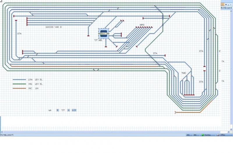

IF you look at the trackplan below it is the pair of points that are the cross over which is elevated just right of the MPD
At the moment its a minor problem but i do have a solution.
