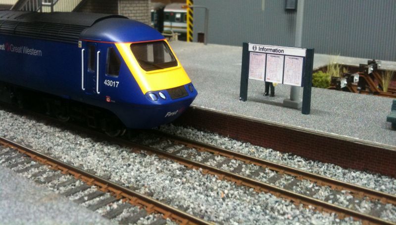

cheers for all of the help - I think the isopropyl is what I use with a cotton bud, great point about abrasive though - I too learnt the hard way ! I will keep you posted how I get on. A HST is a High speed train (intercity) just a sneaky photo to show you !
