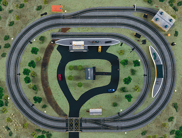

where to position them
This is how my layout looks at the moment. I only have the one power feed which is just before the siding. Where would be the best places to addd extra feeds to make the rest of the layout powered from the one dc controller to allow one train full access to the layout
#162472
With Hornby points being Insulfrogs & only one controller, put feeds to both tracks at the left hand end, connect together & then to the controller output. Locos can be isolated by using the sidings.
#162485
Ideal thats a great help. Time to get the ol solderimg iron and drill out

Neat layout Trevor. Is it a track mat that your using there ? looks really good.
#162512
Yeah its the track mat that came with my blue highlander set. Ive downloaded the platforms and a few buildongs from tje wordsworth site which im yet to build

#162515
I will also be using the siding to extend the lahout onto my baseboards spare piece.
#162516
Hi Trevor,
How is that going to work then. What do you have in mind for the extension?
You have me curious now, or is it just plain mosey :mutley
#162517
My baseboard is 8ft long 4ft wide and this track mat leaves me with a 2 x 4 area which i will use for a yard area with sheds for locos and a fueling area which will be entered from the siding that you see at the top of the pic on this thread
#162518
All is clear. A 2 x 4 ft space should give you plenty space for a shed with a couple of lanes and leave enough room for a fuelling facility.
