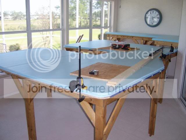

Just took these pictures of the first layer of 3/4" thick styrofoam (blue). You can also see what the morning sun looks like coming in all those windows.
The adhesive I used is shown better in this picture.
I closed my sliding glass doors that lead into the house, and opened two windows for the night. That helped to get rid of the fumes from the glue, although they were not too bad at any time that I could tell.
