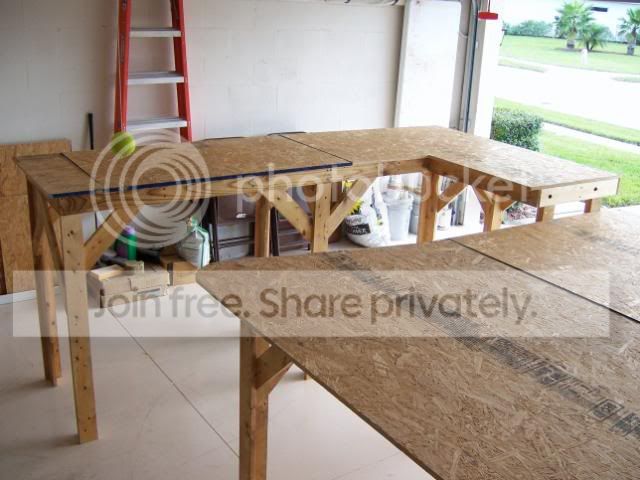

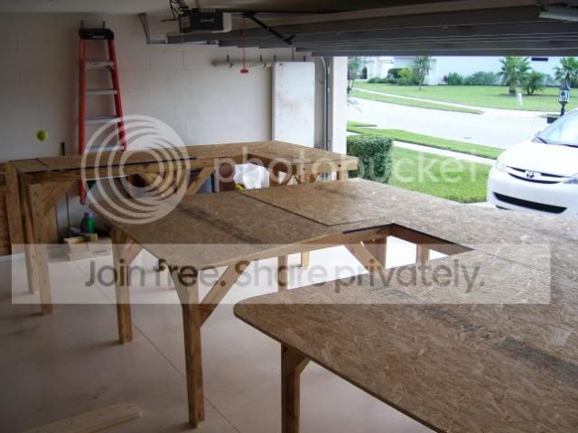

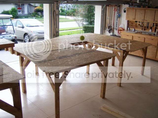

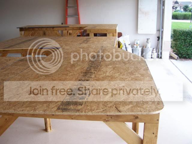

Well it's another evening and yes I am tired again. I managed to get a lot done today, but still probably need one more day to feel "satisfied".
Here's a look at the progress. The frames are stained and the tops are all cut out. They are not yet attached, can't do that until the whole lot has been moved into the train room. I actually have to disassemble the whole thing in order to get it through the door opening. :twisted:
Tomorrow is supposed to be golf again, but I'm too excited to get this moved into the train room, so golf will just have to wait!
Here's hoping it all fits in place like it's supposed to! :thud :thud :thud

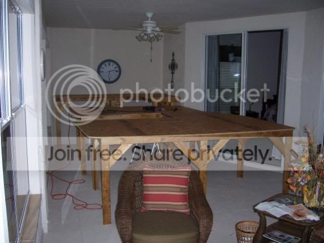

More progress made today. All the baseboards have been moved from the garage to the train room, and everything fit perfectly. :doublethumb :doublethumb :doublethumb :wow
Here is what it now looks like. I took these pictures a little late, spent most of the afternoon over in the train shop. :Happy :Happy :Happy
I still need a few more screws installed, but they won't take too long tomorrow.
