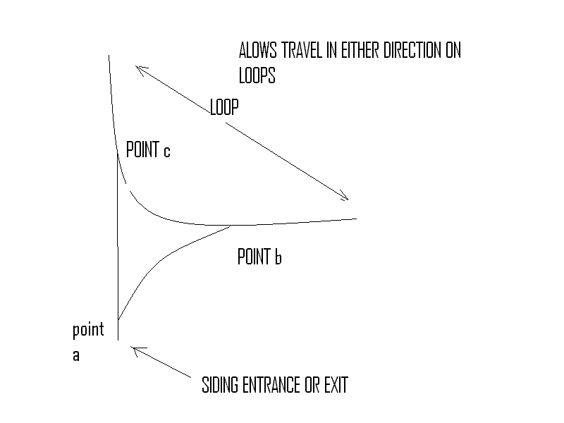

The area to the right station termnus goods yard MPD or fiddle yard is fed by a single track and one set of points .
Would it not pay to have a Wye to enable rolling stock and engines to enter and leave the single track in either direction onto your loops i know it will mean2 more sets of points and additional wiring but it will help with operations.

Heres my kiddy drawing of a wye Wayne if you look at it you will see it would fit on your layout where the siding point leves the loops on your layout drawing .
point c is your existing point on your layout post again if unsure what i mean here

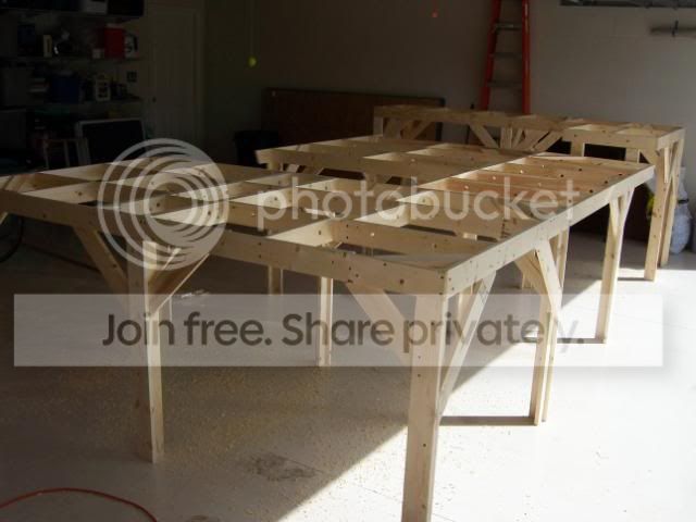

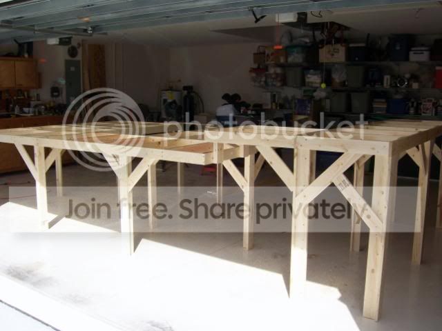

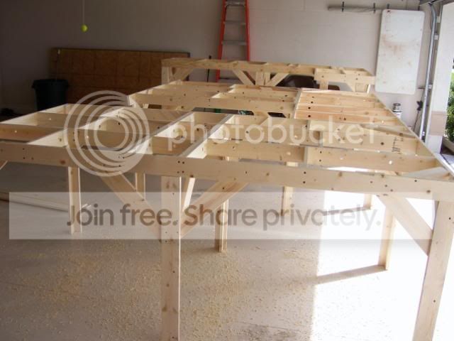

I am sore, tired, and ready to quit for today. However it was a very good day in that I finished assembling my baseboards. Now don't get all excited, because I still don't have a top on them, but still, it was a great day.
They are all still out in the garage waiting for me to heal and rest up. Then the tops will be cut out and then I intend to stain the whole lot. Just so they don't look like raw wood for a long period of time.
Yes, to answer the obvious question that I know will be asked, they do come apart so I can move them from the garage into the train room. More work, but it was the only way I knew to do it.
Pleas ignore the messy garage, someone has been working out there all day long. :wow :wow :wow
