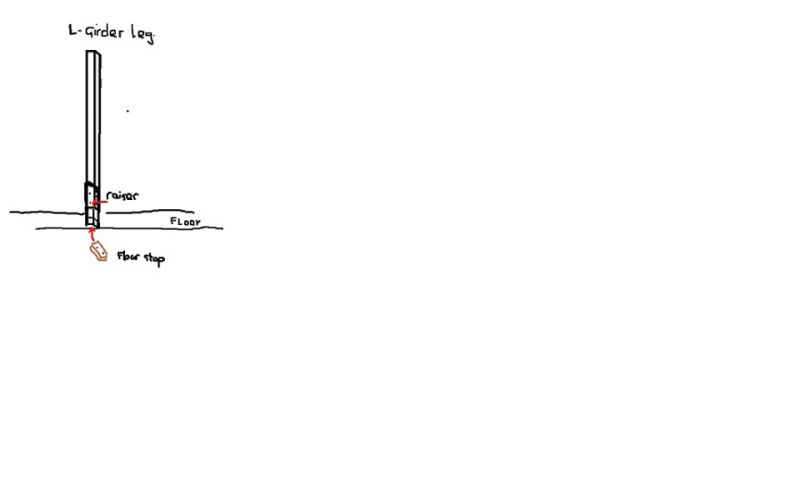

Hi all, this may have been done already.
Dealing with uneven floors, I use 2x1 planed timber joined and glued and screwed to make L-girder legs for my base board frame.
Now I have never had the luck to get an even floor.
So with your L-girder leg attached to the baseboard frame, You may find its airborn at the bottom when it should be on the floor.
So a simple method is to take a short-piece of L-girder wood, slip it into the inside of the main leg and slide it down to make floor contact. when happy all is level and the leg is now supporting the main frame, screw the shortpiece to the main leg.
Now L-Girders are very strong so I find a simple method to avoid a load of cross bracing say halfway down the legs. Is to use a block of wood at the base of the L-Girder leg screwed to the floor and the leg this gives a very rigid frame.regards, Derek

Thats a very good solution to an uneven floor there

Thanks for the replies, Marty I came up with my cheap quick solution because I am building a home layout with long modules, Also any screw fittings are pre-drilled into the side of the legs once height and support is achieved to stop wood split problems. This fix is of course for permanent home layouts.I love the L-Girder frames myself, Great strength and light weight. regards, Derek

#95070
Thanks Brian!. A word of warning to anyone trying this method, The small block of wood screwed to the floor.
If you have a partner, They may not be impressed if you do this to their best inlaid oak floor. Happy modeling, Derek
