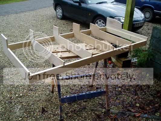

Basically, it's a sort of "open-top" with the trackbed being raised 35mm above the sub frame. The idea behind this is that (at some later stage) I want to run at 2 levels. I can therefore drop 1 track by 35mm whilst raising the other by the same amount giving my clearance in half the usual distance.
There will be 2 boards like this - each 5ft x 2ft 6" covering a station. The layout will extend into open countryside on each side - cuttings, tunnels and bridges spring to mind.
The sub frame (glued and screwed) is 70mm x 22mm, the risers are 10mm ply, the track bed is 10mm chipboard and the former at each end of the boards is 15mm ply for added strength at the board joints. As you can see, the 2nd piece of chipboard has yet to be cut and placed. The trackbed is screwed to the 10mm ply riser and should be self-supporting between the risers so that point motors etc. can be fixed/accessed below without too much difficulty.

One thing concerns me a little though; it appears that you have screwed through the framework directly into the 'end grain' of the plywood risers. Is this going to hold strongly enough? :? From previous experience I know that a bit of twisting or sideways pressure on a joint of this type and the ply laminates can start to split apart. Have you considered glueing some small reinforcing blocks to either side of the riser ends, perhaps?
Perry
The ply risers are screwed to softwood cross members the same size as the sides. Just doesn't show up in the photos. The next 1 will show the framework before the risers are fitted and you'll see what I mean. The trackbed is screwed into the ply riser but also with the odd blob of glue but thanks for the warning. Maybe I should use "blocks" for the trackbed fixings as well.
Petermac.
Blocks on the trackbed fixings sound like a good idea too. It might make for more work at the outset but should give you a stronger, more stable, base in the long run. :)
Perry

Are you going to put holes in your ply frame to allow your wiring to run through?
Marty - Yes, it really does feel absolutely wonderful to be making a start !!! My problem will be rushing things. I've purposefully made myself think first so that, hopefully, when I start laying track, all will be mainly well. You'll see from my "Layout" thread that, already, I've discovered that my planned pointwork simply won't fit.
Re the holes for the wiring - yes, I plan to make 3 in each riser - 1 for feed, 1 for return and a third for "accessories" such as point motors and, if I ever get around to it, working signals plus station lighting etc.
Thanks to you both for the "nudge".
Petermac
Robert said
I would add a couple more holes if I were you. It's amazing how few wires it takes to make a thick bundle.
….or change to DCC, then you'll only need two wires!! :roll: :lol: :lol: :lol:
Seriously though, that's sound advice. Extra holes can help to keep different circuits well apart too making fault-finding easier. (Not that there will be any faults, of course! :roll: ) :lol: :lol:

OK chaps - it's more holes - it'll make the boards lighter anyway !!
