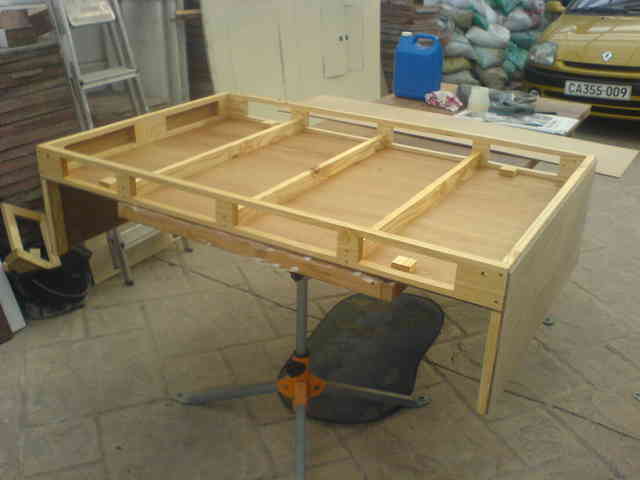

 2 ft end pieces attached  so that it could be stored standing up on end.

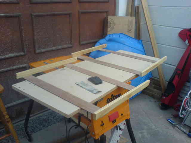

Legs to be hinged;

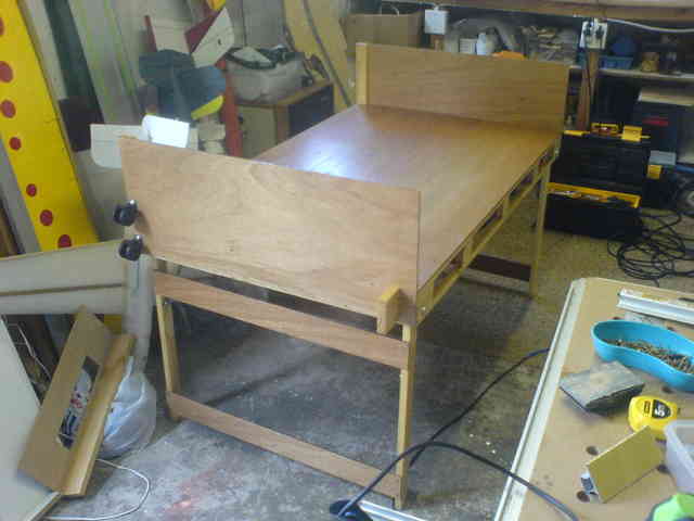

Legs now attached. Note castors on left and support on right so that the table can be moved whilst still on end.

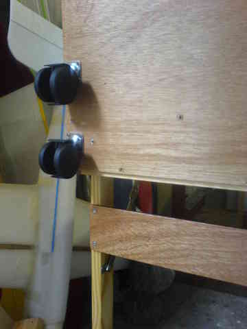

Close up of castors

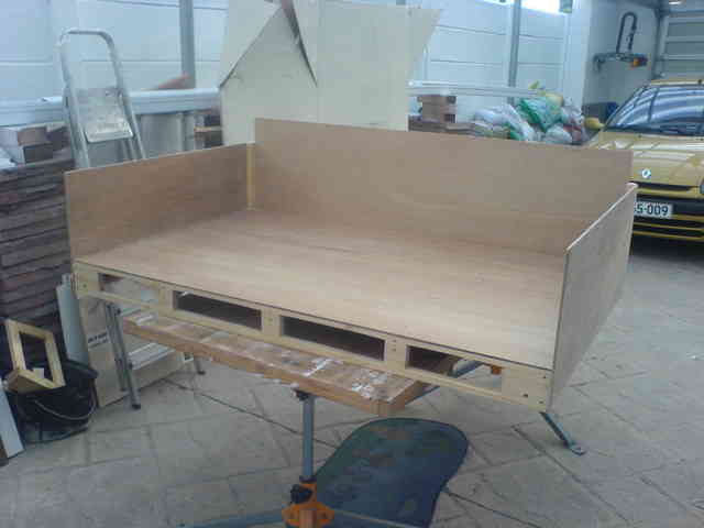

Back piece added to mount back scene. It slides into groves in the end piece supports, so is removeble.
Standing on it's own legs with back piece taken out

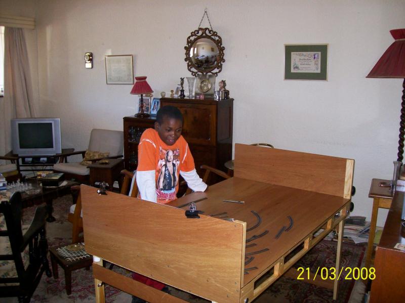

The owner can't wait for trackl laying to commence
