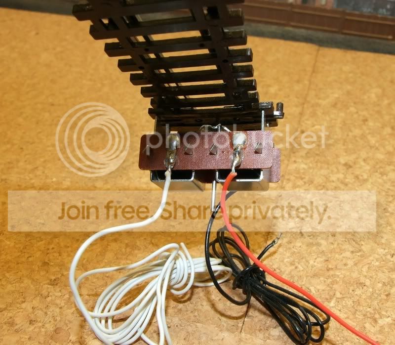

Thanks for showing how Peco motors are fitted, we have only ever used Tortoise and SMP motors before, but we have already ordered Peco motors along with the points, and your images have helped.
It is far more flexible than cork, which I used previously. It can be bent to the required curve (by just removing thin slivers on the internal side of the bend) and is much tidier for fitting points. As it is foam, thin slits cut into it allow parts from below through it (for example, the 4 x metal prongs on a Peco point motor and the central pin) but also hide these parts and close up around them to seal any gaps. Yes, you need to cut a hole in the baseboard to enable the point to be fitted directly to the base of the point but because of the properties of the foam mentioned previously the finish is much neater than using cork. It also means that ballast doesn't drop through the baseboard on to whatever is underneath.
