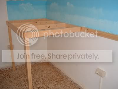

The board is braced at 2' centres, although I maight have to tighten that up a bit. The sundeala is moving a bit. Before assembly i covered both faces of the board with varnish mixed with odds & ends of vearious dark colours to give it a nice dirty finish. This stops the boards from taking in any moisture.
BT
My layout is built using sundeala and I'm finding it the best surface I've ever used.
One point must be stressed though, Sundeala is less horizontally stable than MDF of ply and must have adequate support. I've seen too many layouts where the track ends up like a big dipper to compromise on this :!:
Go for approx. 12" to 15" centres (which will give you some leeway to avoid having points over any struts) and you'll be fine. Remember that you'll need to have these running L to R and back to front on a 4ft x 8ft surface.
You have done the right thing by sealing the surface first, I use emulsion paint of a colour simular to the eventual ground cover underneath.
Good material, but treat it properly or you will have problems.
You say not much will be happening in the middle. Are you planning on having a scenic divider running lengthwise through it? It's a pretty good method for separating towns and regions.
I have the idea of dividing the board into two 6' x 4' sections - joined on their 6'. Each board could have a terminus/yard and the oval or roundy round part would be the only lines to cross the intersection of the two baords. With only four running lines between the two boards I should be able to reduce the consumption of asprin!

Mike - that's the sort of benchwork you should need… :wink:
I know what you mean about the square "A" frames but why 2"x2" battens down the sides ? 2"x1" would be more than plenty - cheaper and lighter !! You'd still have the 2" depth for support and the baseboard top screwed into the 1" section would stop any lateral movement.
On the point of the topping material - you said "loft board woodchip". Is that the soft fibreboard or is it hard chipboard ? If the former, I'd say, unless your loft is bone dry, it's a no-no. It's like blotting paper and would bow unless you supported it at least every 12" in each direction. If it's the latter, that's what I'm using and it's strong but has the disadvantage that you can't easily drive track pins in and it's pretty tough to drill and cut - blunts tools very quickly. Much cheaper than Sundeala but, if funds would run to it, Sundeala is the stuff to go for. Either Jeff or Perry (can't remember which one :oops: ) have sung it's praises elsewhere on the forum. If Sundeala is out, then I'd go for chipboard (10 or 15mm thick)
