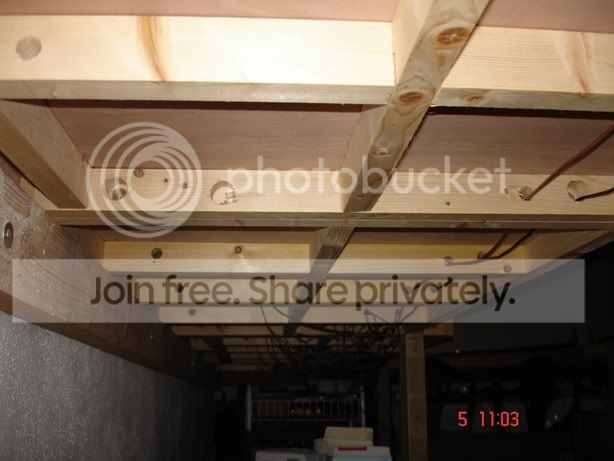

Hi Brian,
I built my baseboards, of which I had to make 13, in the
following measurements. Each board is 4ft x 2 ft and are
at a height of 4ft to enable working and viewing (I am
5ft 11ins tall). They are made of 1.25 ins x 1.5 ins of timber
with lap joints making squares approx 1 ft sq.
On top of this I glued and screwed 10mm marine ply.
The boards are attached to the wall on 3 x 5 ins battens which
I had spare and the legs are made of old pallets I had
kicking around.
Picture below (Correct size I hope) shows underside with my
 DCC buses running through holes in the frame.
Why marine ply?  First I could not get Sundeala in Spain or I may
 have used it, although I've heard like Sparky it's not all it's
cracked up to be. Second we have extremes of temperature
here so it needed to withstand heat and damp. Having said

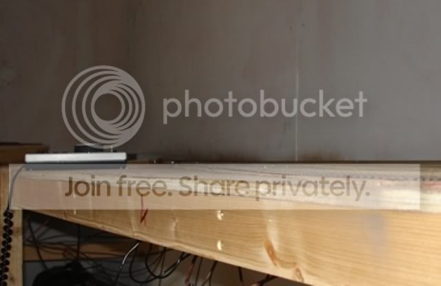

that I have also attached a photo of a board I hurried and
must not have glued it to the frame properly. You can just
see the edges starting to
go wavey.
In the end much depends on what your conditions are, where the
 boards are, how tall you are and what is most comfortable. :wink:  :wink:  :wink:
Hope this helps,
Les
