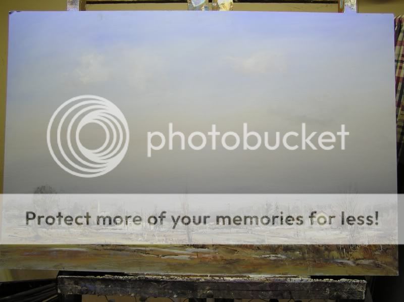

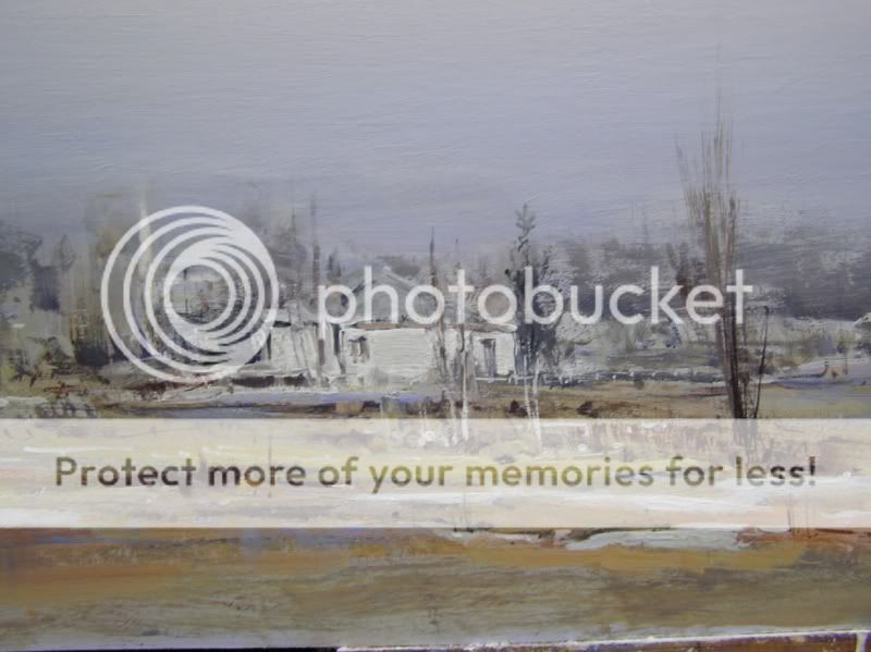

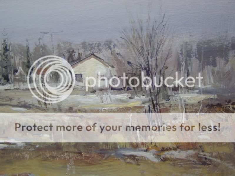

 Here's a rundown of how I went about the new backscene painted for one end of the layout. It's 36x24ins, painted with acrylics
  Colours: Ultramarine blue , red oxide, napthol yellow, napthol red, white [sample pot of matt primer]
 The board was primed with one coat of artists gesso, then I painted the whole thing in sky colour - ultra blue, red oxide and white. I hoped the blue underpainting would stop the whole thing getting too warm.
The darker hill/distant trees was added after most of the foreground because the scene was very insipid until then. It was a mix of blue, red oxide and white, plus a little yellow for luck.
 Fine branches were put in with a fine round brush, and some of the bare trees were done with the fan brush, used mostly on its edge with not much paint at a time.
 Buildings were blocked in with a sharp flat brush and near white. Details added with the fine rigger brush.
 Snowy patches were kept off-white.  Sky clour was added to many of the mixes to keep them 'quiet'.
 I didn't take any progress shots because I didn't know where I was going with it.
 Next task will be a more industrial scene for the opposite end. I'll try to take some progress pics as I go, if anyone's interested, but again it will be uncharted territory for me, so it might be a bit hit and miss.
 Please ask any questions at all.

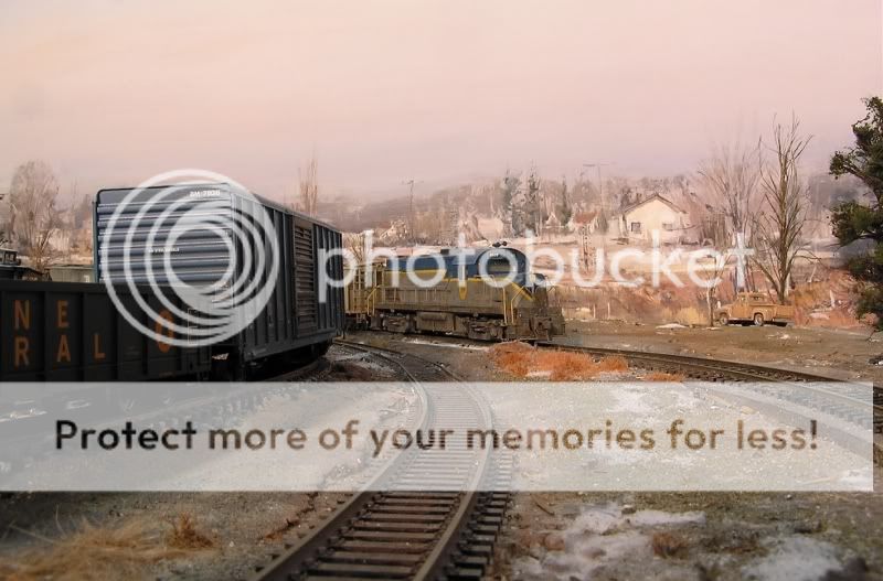

 This one came out a bit warm. I don't know why.

Maybe there's a thaw setting in.
The first couple of photos certainly looked cold but the red really came out in the last one, funny how it does that with little things like changes of lighting or camera angle.
It certainly looks the part based on the New England winter photos that you've pointed us to before.
I really like the misty woodlands and hills in the background.
Sunrise Mike :cool wink
Brilliant Mike so much depth has been added by painting the back scene, and using a mix of daylight and reflected light has really helped the photo.
