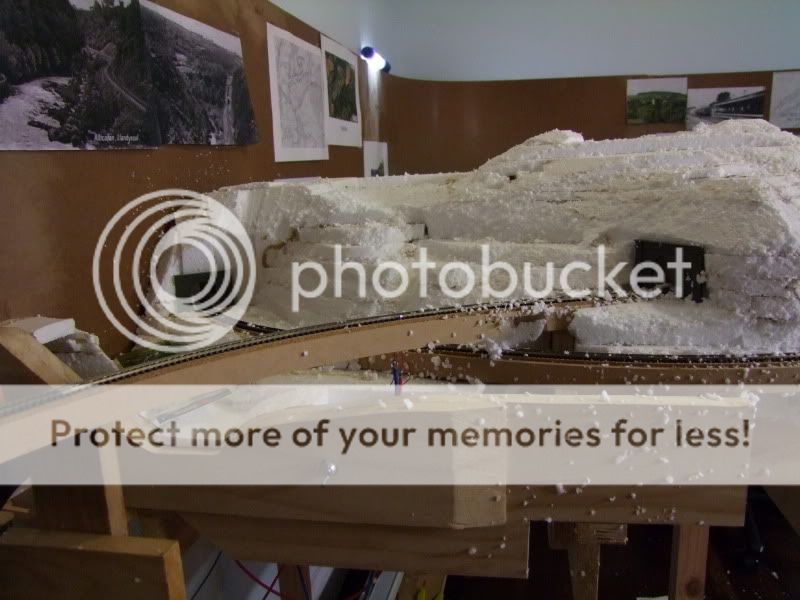

#81112
I expect you already know but a cheap hot wire cutter would cut down on the 'snow', Marty.
Yup, thanks… haven't tried a hot wire cutter yet but it's on the list.
After discussions with the domestic goddess (sigh, yes dear) the current method sees me with blade in right hand and a running vacuum cleaner nozzle in the left. A re-useable vacuum bag dedicated to the railway room keeps the cost down.
It's quite effective and still allows me to carve the shapes I want.
#81120
They are very cheap, Marty.
I have a super-dooper type with a trigger instead of a button for about £5.
I've fitted it to a transformer but they work perfectly well off batteries.
http://dddioramas.webs.com/
