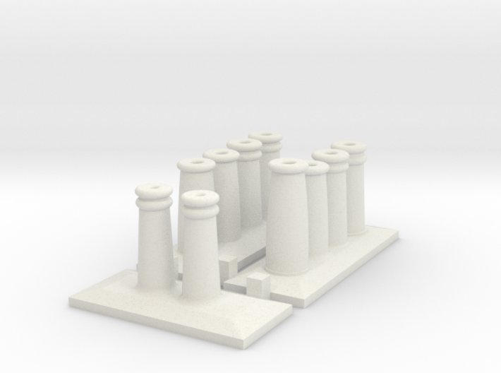

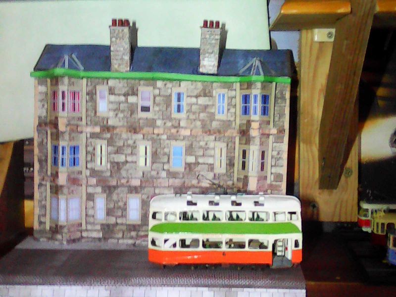

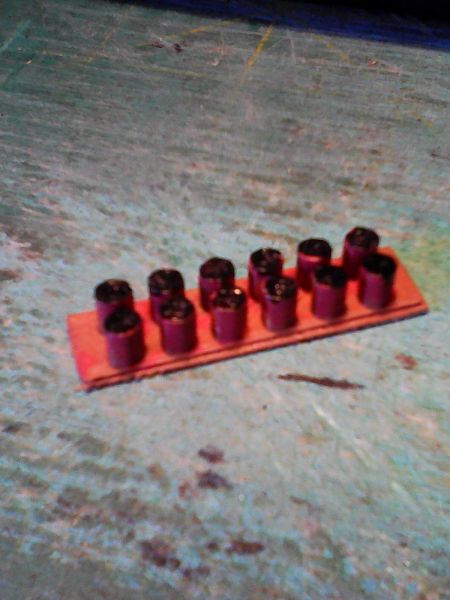

The first pic is a set of 4mm tenement end wall chimneys on their own plinth. They are 4mm wide by 4mm high pots with a central gap of 1mm and a side spacing of 1.5mm. They are mounted on a 1mm thick plinth with a width of 11mm and a length of 41mm.
The second pic is of the shorter plinth for the tall stacks in situ. These are taller at 6mm and the plinth is correspondingly reduce in length.

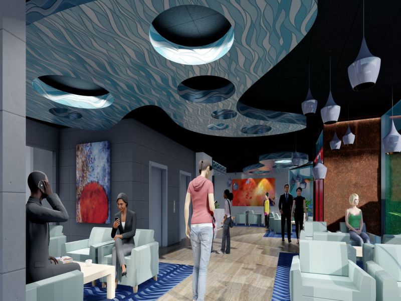

I spend a fair proportion of my working day designing and modelling in 3D. Below is a preliminary image of the reception for a hotel I've been designing..
The model for this was made in AutoCad Revit, and the imaging produced via some other software called Lumion. Both of these are financially out of reach for most modellers, unless you have access to them for non hobby reasons, However some of the objects in that scene, the light fittings for example, are actually made in sketchup, which is free.
There are a few 3D software design packages that are free, and I find sketchup to be the easiest and most intuitive. It's not so great with complex curves though, but as you can see from the light fittings, curved objects can be made.
I find it easier when making scale models to model everything at full size and then scale the completed model down when ready to print. I use a program called Meshlab, which again is free (or at least shareware) to do the re-scaling. This is not the friendliest looking piece of software, but I only use it to do one thing and that is pretty straightforward.
Meshlab doesn't import straight sketchup files, but free plugins are available for the free version of sketchup that allow you to export the model as an STL file, which Meshlab can import. So it's simply a case of importing the STL file exported from sketchup, re-scaling it and exporting a new STL file which can then be used by the software on your home 3D printer or uploaded to a 3D printing bureau such as Shapeways.
The important thing to keep in mind when designing models for 3D printing, are the print limitations of the printer that is going to print the model. For example, Shapeways minimum wall thickness for their "Versatile Plastic" material is 0.7mm. I therefore make sure that nothing I design that will be printed at 00 scale is less than 55mm (0.7 x 76 =53.2). In practice I actually work to a minimum of 61mm, because this will allow the same model to be re-scaled for HO (0.7 x78 = 60.9). N scale models are normally also possible from the same model if instead of printing using Shapeways versatile plastic you use their "Fine detail plastic" which has a minimum wall thickness of 0.3mm (0.3 x 148 = 44) for UK N scale and (0.3 x 160 = 48) for US N Scale. The same model can therefore be used for at least four scales. The larger scales S and O are also easily printed from the same model, but the larger the models get the more expensive they become to print.

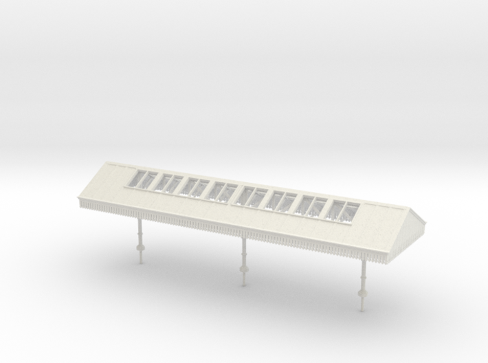

As I said at the start of this post, I have been away from railway modelling for a while, but I have done a bit of scale 3D modelling, mainly in response to specific requests. Most recent are some chimney pots for Metcalfe Terraced houses.

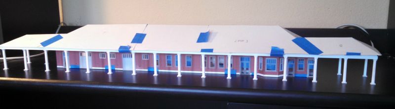

Also a version of my platform canopies as requested to suit a narrower platform. In this case, all printed as one single print, rather than as individual components to be assembled.
I was also asked by a modeller from the USA to model the columns for an SP Station that he was making. In the end i also modelled all the doors and windows. Below is a progress picture of his model under construction.

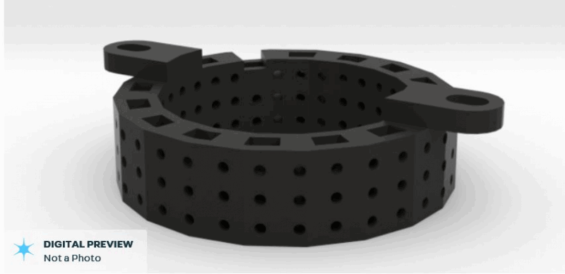

I helped towards the Didcot Railway Centre recently by buying a copy of 3D Printing and Laser Cutting - A Railway Modelling Companion by Jeff Geary and Dave Renshw published by Ian Allen in theri book shop. Much of it is about producing the 3D drawings but the sections where a basic plastic reel fed printer is used are quite revealing. For anything except very basic shapes the technology has some way to go. When it comes to 3D printing larger objects the best way is to print the parts for a model to be assembled.… I was impressed. I reckon they are going to become major players in all forms of modelling. David
The main problem with top fed printers, which is what the reel fed plastic ones are is supporting parts of the item being printed. Also the final definition does not seem to be too good yet.
Industrial systems create a body from within a supporting material, but naturally cost a lot more. Additive manufacturing to give it the correct technical name certainly has a future and if you can afford a machine then certainly have a go, but regard it more a a learning aid rather than something that willchange your world.
From the book I suspect that lazer cutters might have a more immediate future being able to cope with slight thicker materials than the card possible with the current Sihouette and similar cutters.
There also the need for an intuitive 3D CAD sytem. The book relies on the free downloads availble, which certainly work but are not always the easiest to learn and use.
One of the problems about the publicity of new technology is where they disregard the old. 3D printing is slow, but the forms produced may be used as casting patterns for quantity production. Similarly if a form of wax replaces the plastic then the item produced, and possible part of an assembly can be used as the basis of lost wax casting, a process the ancient Egyptians certainly knew about. I believe Rolls Royce and the like use this process in the manufacture of complex parts for aero engines.

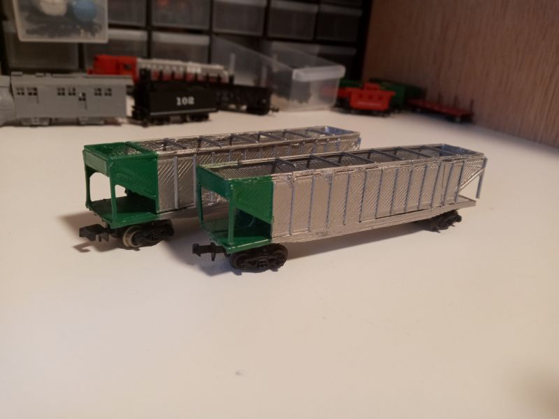

Aunuli: Nice job and just remember most kits require fettling to produce a good model. Like you I am more interested in stuff that isn't produced commercially (Span wire ears for tram catenaries and pole caps etc) so I need to make them.
